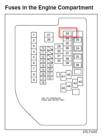

Anyone know if there is a good wire or fuse that I can tap into that comes on when the vehicle is turned on?
I checked all the fuses in the fuse box under hood and everything has power all the time.
My last resort will be tap into one of the headlights.

In the fuse box under the hood, driver's side... Item #33 is the Rear Defogger relay switch. Pull that and you'll have 4 tabs. the slot closest to the firewall is powered when engine is running. I've slipped a wire with exposed wire into the slot, then pressed the Relay back down firmly.
#33 - Rear Defogger Relay

Awesome! You saved me. I was gonna have to tap into the lights. Thanks a bunch!

Metatrox wrote:Awesome! You saved me. I was gonna have to tap into the lights. Thanks a bunch!
I believe it's only a 15amp relay so if you're powering anything greater it may trip the relay, but I ran the defogger this morning with no issues
