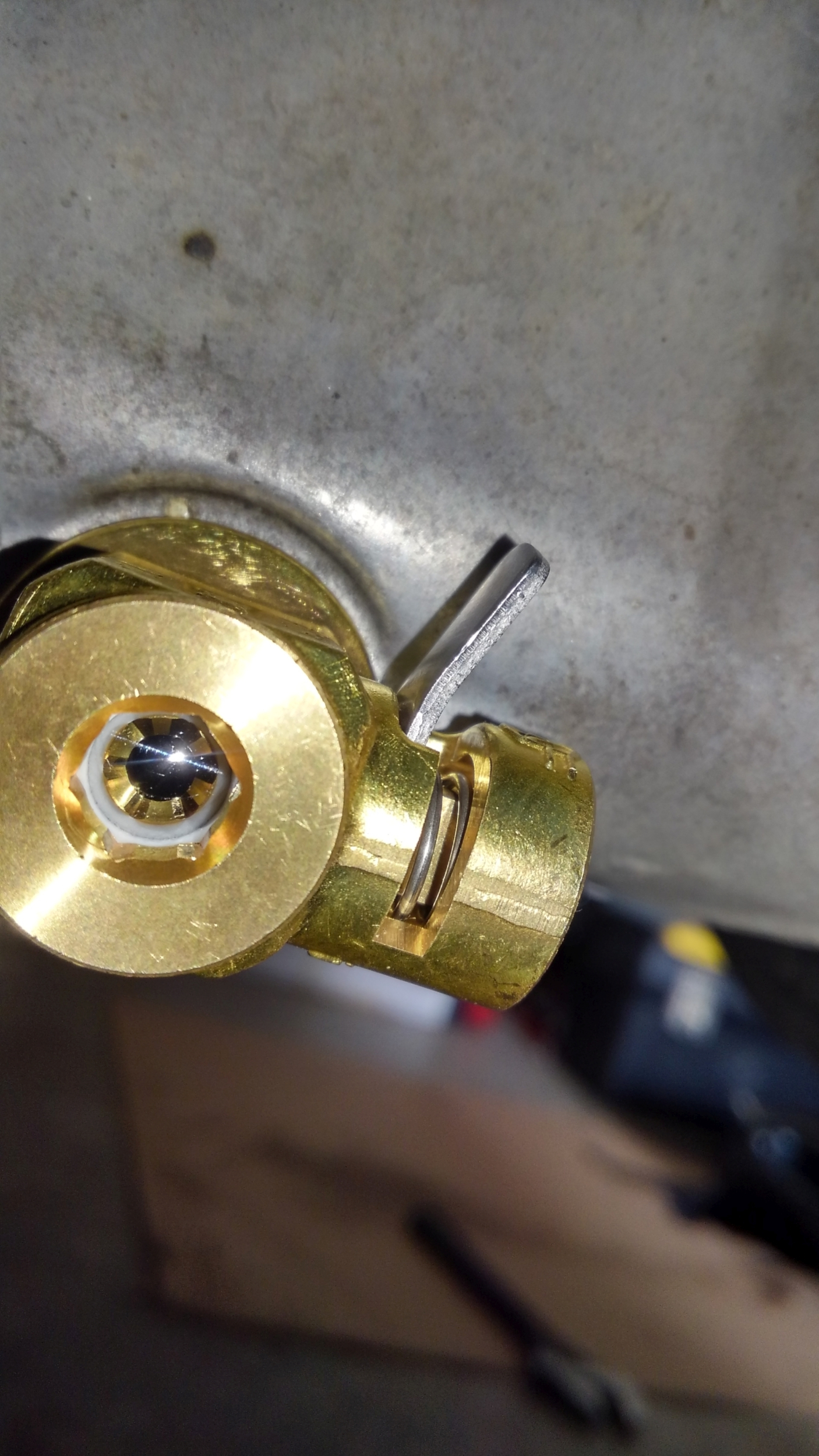

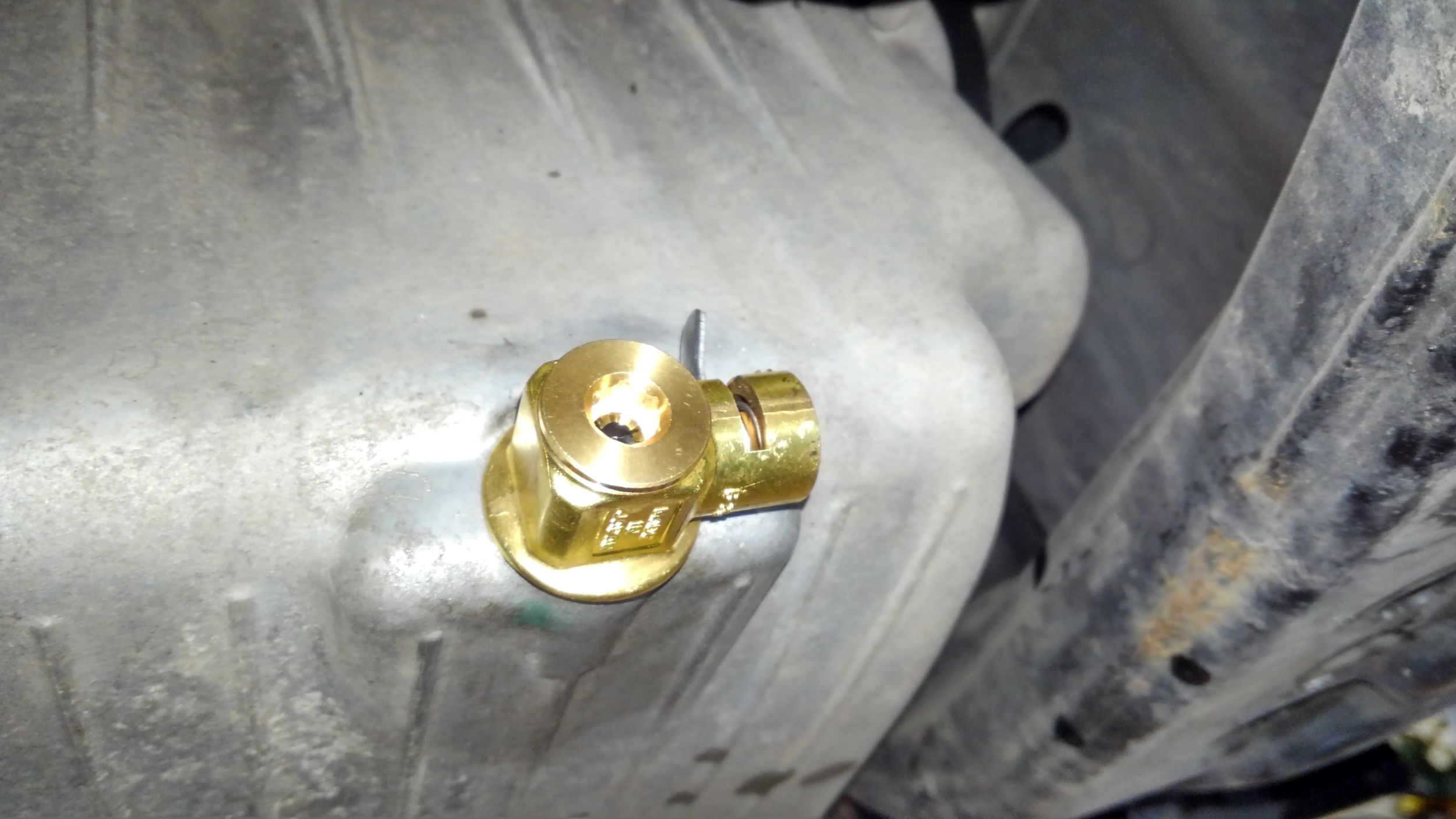

An update on the topic:

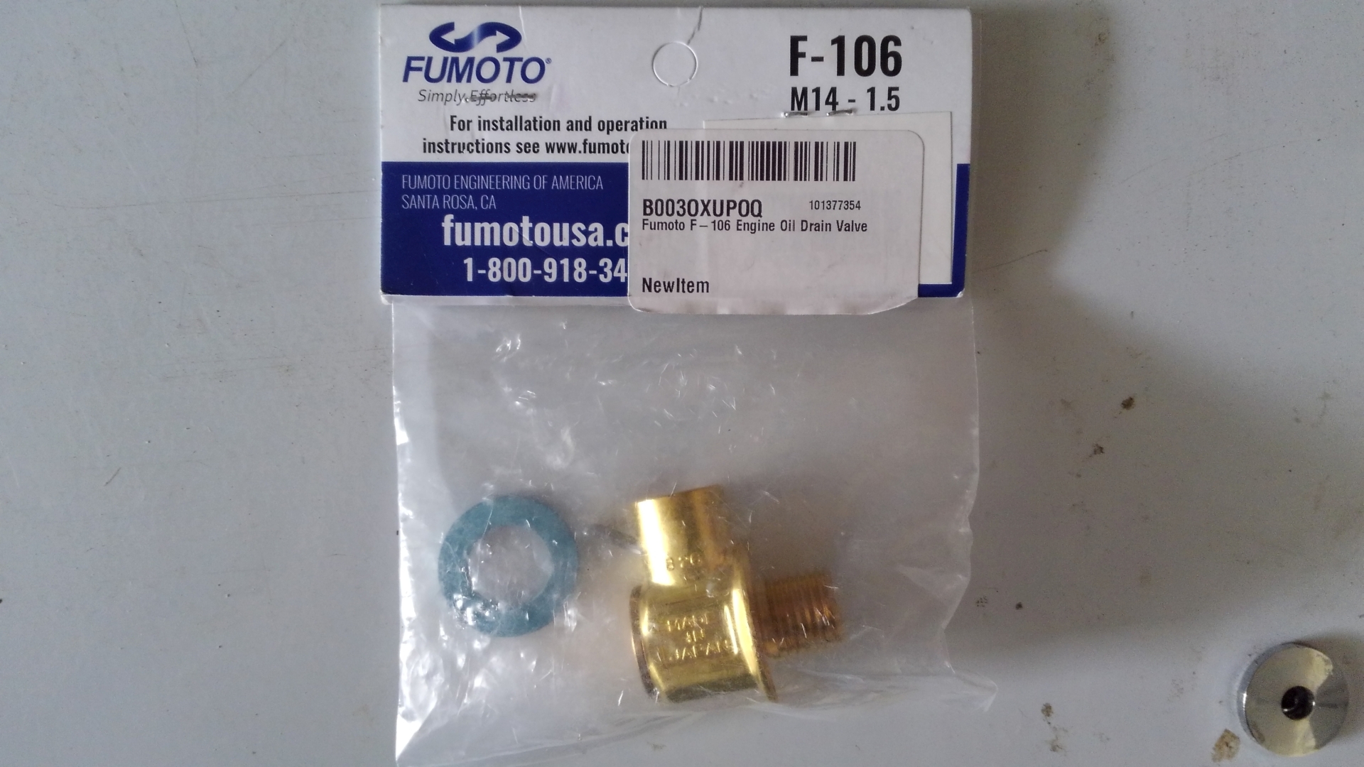

Shortly after last posting on this thread, I ordered a Fumoto valve for the Kizashi but it wasn't until recently that I changed my oil and installed the valve.
The last oil change was a good example of why these valves make things easier: the drain bolt was difficult to remove and when it came off, I accidentally dropped it into the oil collection pan. The oil then rushed out and made a mess. I also had to fetch the drain plug from inside the collection pan. If only there was a better way about this... And that's when I installed the Fumoto valve. The process will be much easier now that a lever controls the flow of the used oil.
What's also neat about it for the Kizashi is how it's orientated. Unlike my old Impreza where the oil drain hole, therefore the valve, was angled straight downward (lowering ground clearance for the valve), the Kizashi's drain hole is angled backward. Thus, when the valve is installed, it doesn't risk getting hit directly by road debris or even touch the splash shield.
The part number I got was F-106 and it fit the Kizashi perfectly. When properly tightened, the valve's lever is at the topside. To release the oil, I simply have to lift and pull the lever towards the back which rotates the check ball to release via the hole in it. This way, it's very easy to control not only the flow rate of the oil but also the amount if needed.
While oil changes aren't such a frequent thing with the use of synthetic oil and longer change intervals, it still makes the process a lot easier and less messy. Given I plan to keep the Kizashi for a long time, I figured it was worth it.
