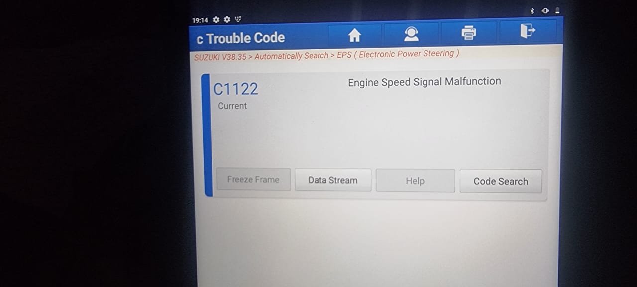

I have the same issue
Code are c1122 c1161
And i can not solve this issue please see attached files.
Where can i find the p/s control !
And how we can solve this issue

Code error
Code error
