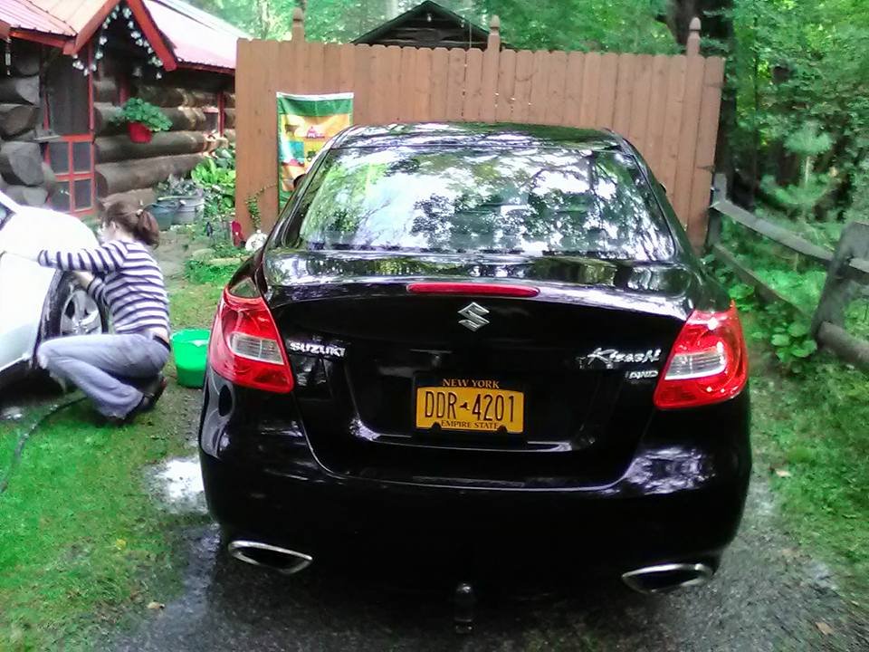

I run that same hitch on my car, and have towed about 2,000lb with it (my UTV on my 950lb trailer). The hitch does hit/scrape sometimes when i come out of a gas station or crappy driveway, but that's unavoidable. 5 years and no problems. The engine and cvt are up to it and tow well, and the brakes are more than up to it. I did install a transmission cooler with a fan (Mishimoto i think- got it from summit). Wash not a bad job, but if you are only towing under a 1,000lb you probably do not need it.
- kizhitch1.jpg (139.84 KiB) Viewed 7615 times
I have no experience with a hitch on any car, but I've seen many sedans with Uhaul hitches. I looked up a hitch on Uhaul's site for the Kizashi and they have one. You can even get it installed at a Uhaul location.
Having a hitch not only allows you to have a trailer but also use a hitch-mounted accessory like a bike rack or cargo tray.

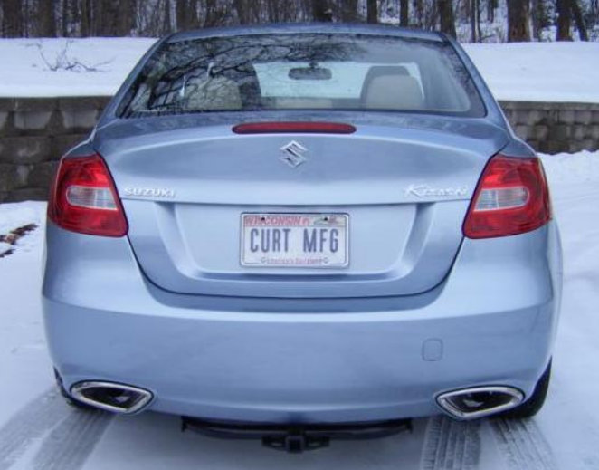

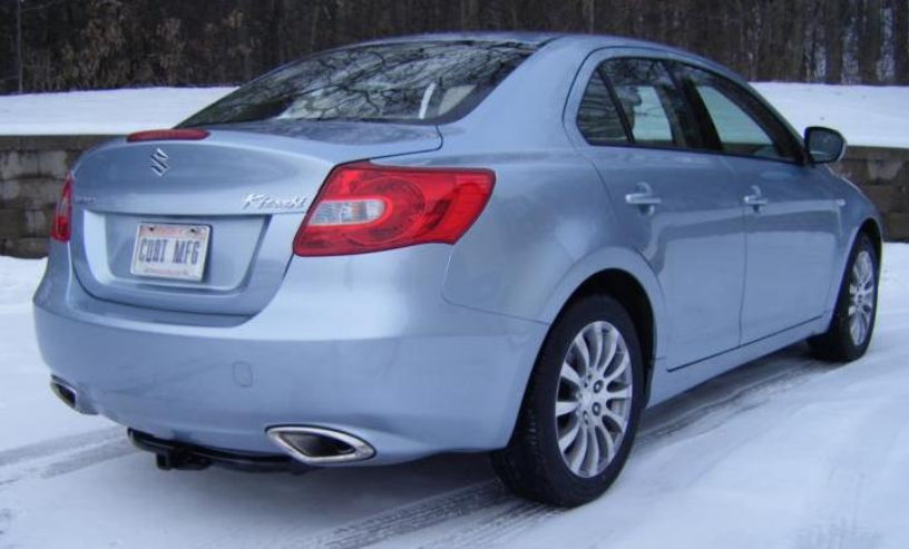

Here are some pics from the install document above with pics of the hitch after install: Hope this info helps!

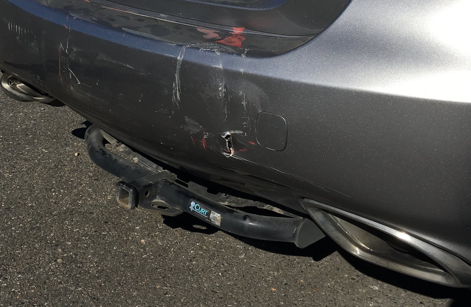

My story is almost identical to that of Jason.rattle’s. I put my hitch on probably 6 years ago when I bought a boat (maybe 600lbs boat and trailer). The hardest part was the mufflers. Wiring plugged into the factory tail light harness. All that concerned me was staying well within the GVWR for the car and it’s CVT. I think I paid $250 for mine off of eBay.
Ever since I was rear ended you can see the hitch a lot better
