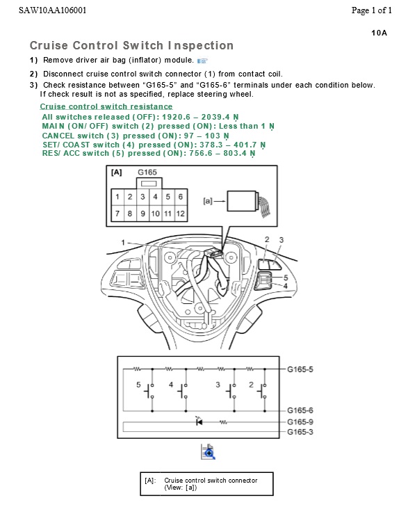

adegiulio, If you can find replacement (on ebay for example), you can change it by removing steering wheel in order to do that you need steering wheel puller tool and then after removing it plastic cover steering wheel can be release from behind and after that unscrew and disconnect wire from cruise control connector you replace it with spare part.
remember to disable air bag system before removing steering wheel.
cruise control function is simple hopefully after removing it you can fix it by disassembling it or using contact cleaner spray this is procedure on kizashi service manual to check it( in case you are not already read it)
New Bitmap Image.jpg (94.88 KiB) Viewed 6418 times
