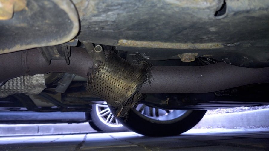

I'm getting an exhaust noise coming from the center of the car underneath. No fumes or anything in the cabin, Just a bit noisy when I first start her up. My first thought was that the exhaust pipe was broken or leaking.

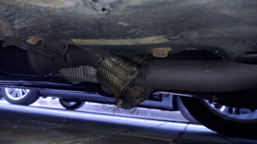

I took a look underneath the car near the cat and saw this. (See attached pics)
Any ideas? Thanks in advance.

Heat shield. You can slide it back forward, but it will eventually work it's way back. I've been debating just cutting mine off.
Black 2011 Sport SLS AWD
That's the metal mesh that covers your flex pipe located just past your engine under the car. It's a stainless steel mesh protector sleeve to cover the flex pipe portion of the exhaust (the part that has folds). Unfortunately, these mesh covers get ripped up and pulled back over time from driving over debris, rocks, parking blocks (me), and snow/ice. Mine was damaged early on from driving over a parking block hidden under snow. I pulled it back up, fixed it a bit, and then placed a large stainless steel hose clamp around it to keep it in place. It's held for several years now.

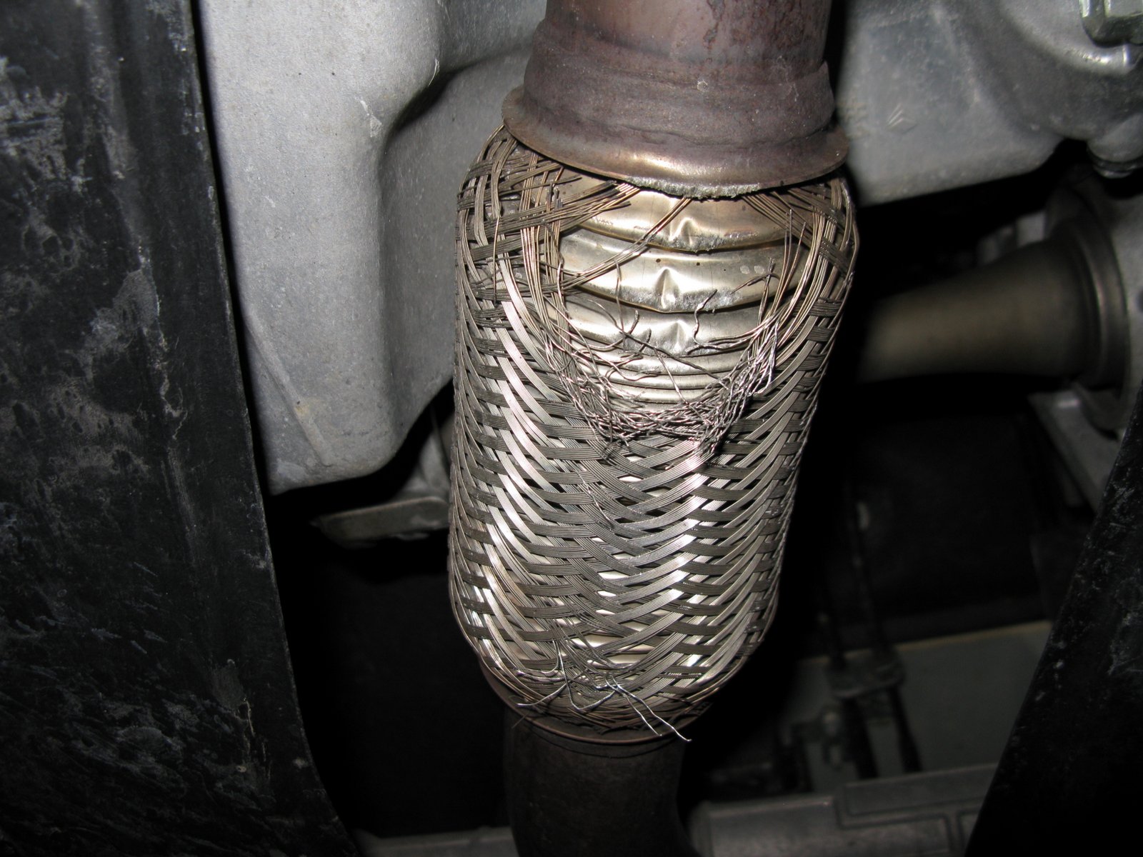

Here is a picture of mine after I damaged it the first time. You can see where the mesh is supposed to cover the flex joint of the exhaust pipe.
If you hear excessive noise, first check to see if there is damage to your flex pipe that caused the mesh to get ripped out and pulled back down along the exhaust pipe. If it's damaged (like punctured), you will need to have a pro cut off the old flex pipe and weld on a new one. It's not major work for someone who knows how to weld. Weshoot2 had this done on one of his four Kizashis.

My thought is that the pipe is punctured due to the sound. I will take a look this weekend.

It's definitely a possibility as your mesh shield is pulled way back down the pipe. While this could have happened over time, it means your flex pipe was exposed and more prone to impact damage. Weshoot2 just posted he got his flex pipe replaced on his current 4th Kizashi for under $200.
