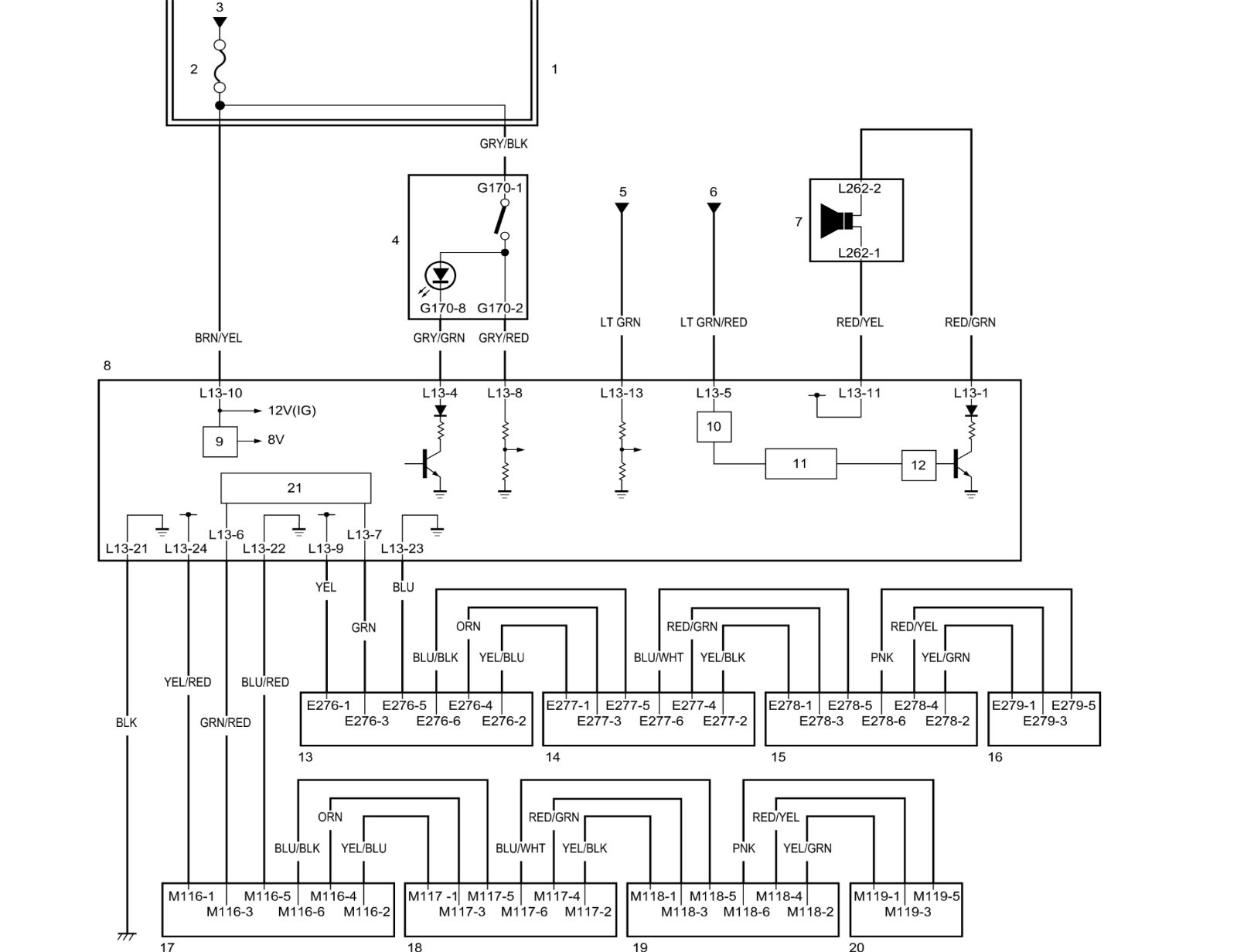

parking sensor in Kizashi uses a simple 3-wire interface
1:GND
2:VCC(8V)
3:DATA pin
remove the bumper and check VCC and GND with multimeter. Here is the wiring diagram to diagnose. check YEL/RED, GRN/RED, BLUE/RED wire.

SAEED_KIZZY wrote: Fri Sep 15, 2023 8:38 pm parking sensor in Kizashi uses a simple 3-wire interface
1:GND
2:VCC(8V)
3:DATA pin
Thank you so much! Where did you find this wiring diagram?
