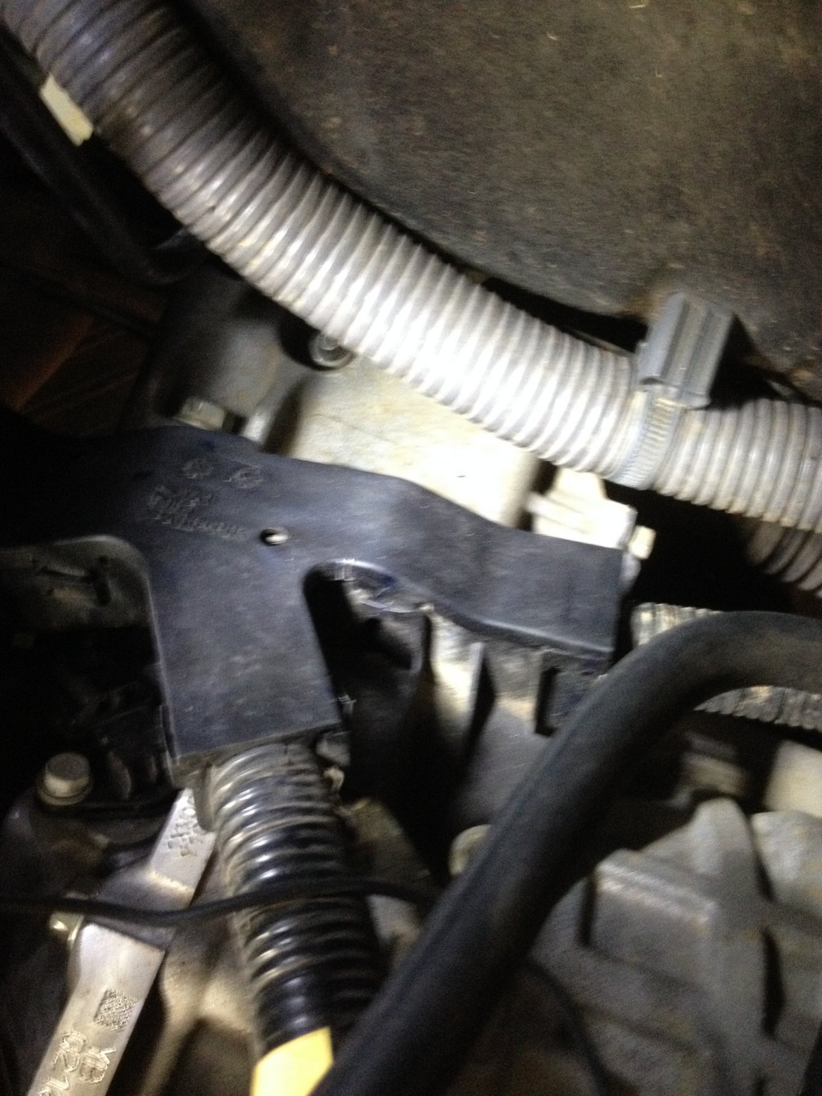

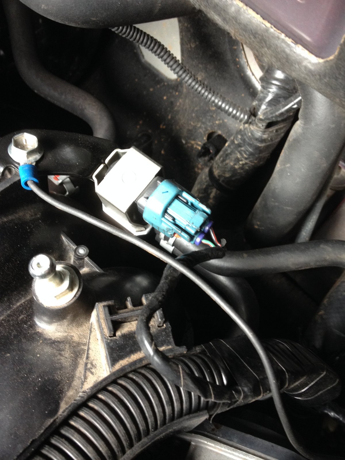

Hi Guys ,
attached are some images where the wires were broken --not the purge valve ) the blue plug ) the black T shaped plastic cover , can be removed and exposes all the wires
Rgds
Greg
