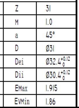

The part engineers got back to me with technical data specifics on the part and here they are (In case the image doesn't load, from top to bottom it reads)
# of Teeth: 31
1.0: Module: 1.0
Pressure Angle: 45 degrees
Pitch Diameter: Naught 31
Major Diameter: Naught 32.4 (+0.12, 0)
Minor Diameter: Naught 30.4 (+0.12, 0)
Tooth Space Width Max: 1.915
Tooth Space Width Min: 1.86
*measurements in metric
Does anyone have/know where I can find the same from Suzuki? I would really not like to have to pull the hub back off again just to measure it (not ideal)
