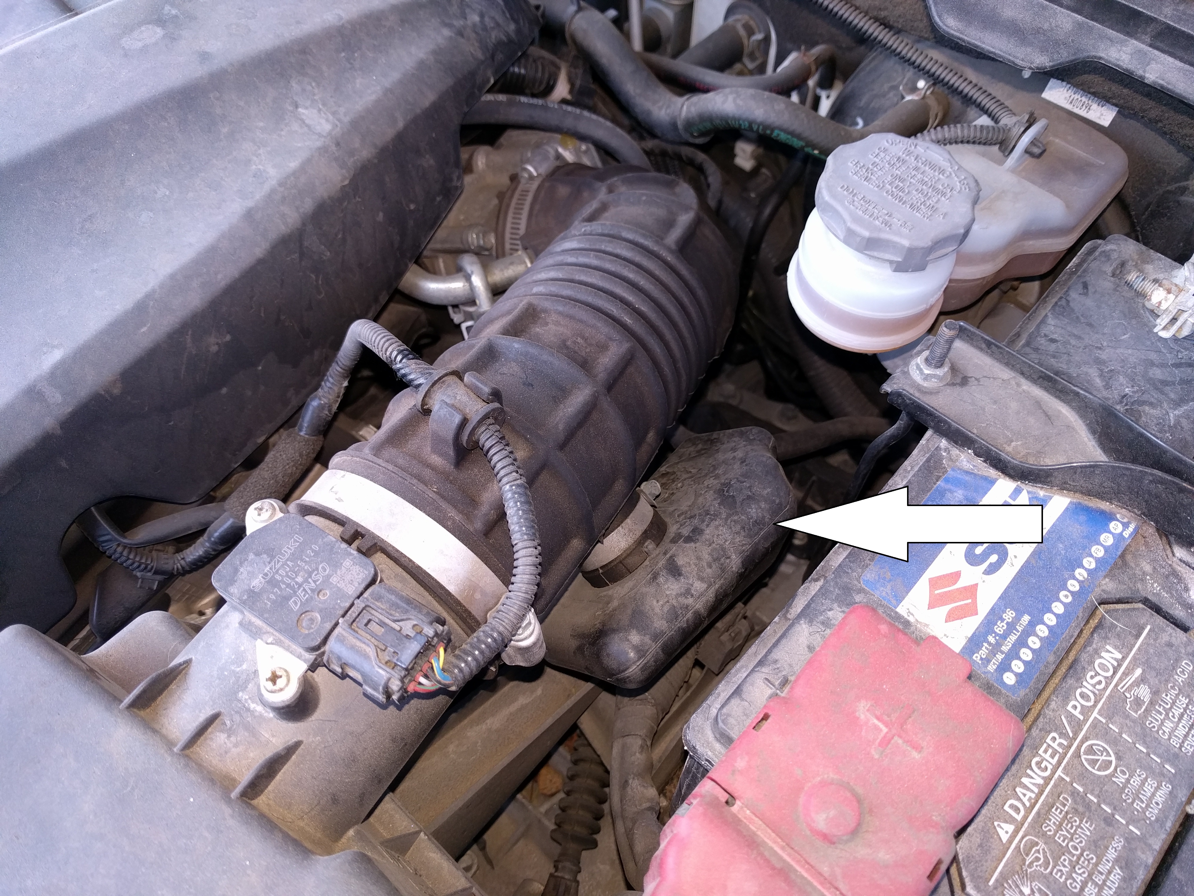

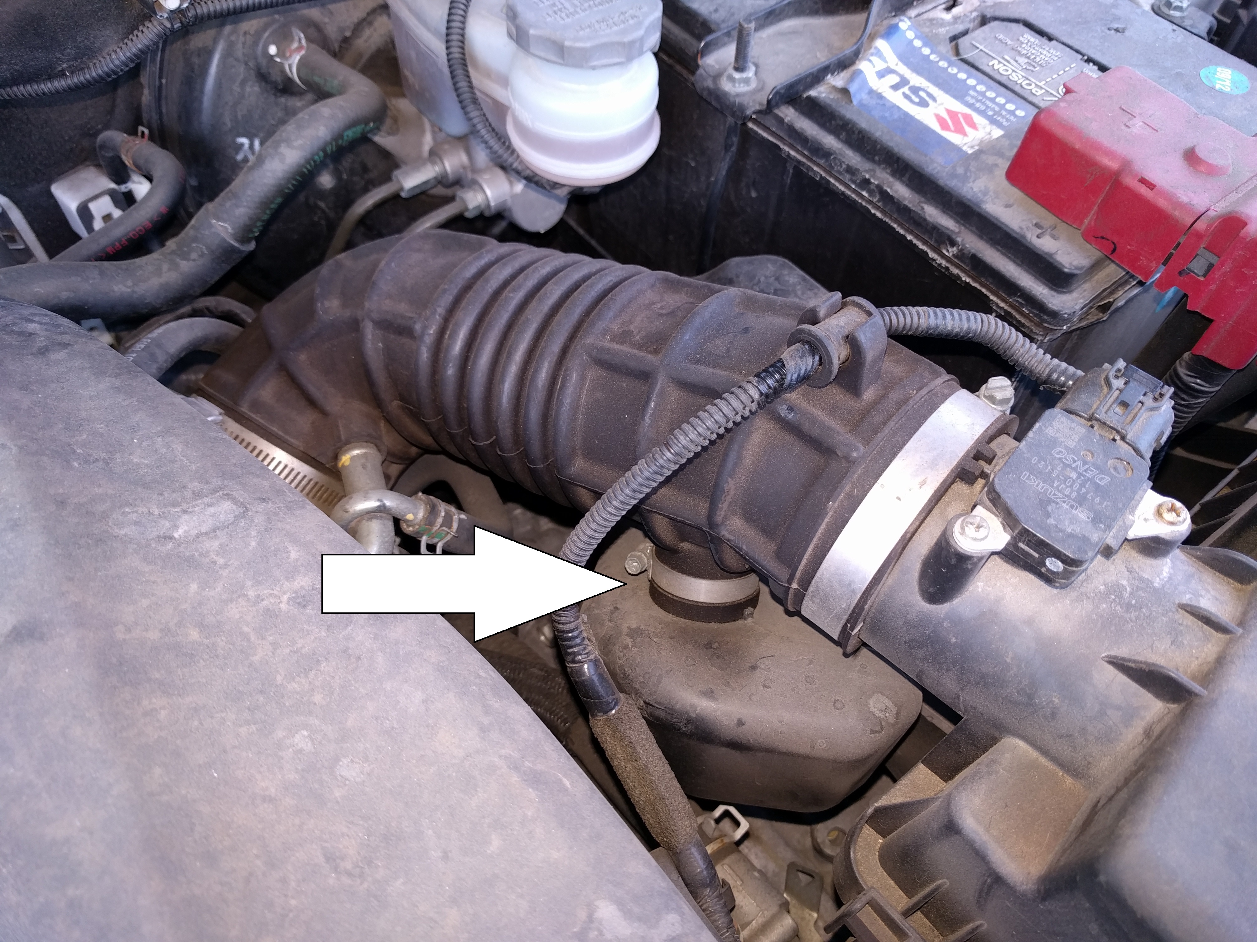

Anybody know what the two plastic boxes on either side of the hose connecting the air filter box and the throttle body are?
WAG: air-flow management (image driving fast and having the vehicle hit with a huge gust of wind, causing a low-pressure area around the air intake, potentially causing the motor to stuck vacuum).......?
My understanding is that they are intake silencers to reduce intake noise. Having once installed a conical K&N type intake filter in a previous car (thereby removing one of these silencers), I can say that you'll hear a lot more of the intake noise by modifying the original intake, even at idle. The factory engineers work to make not only the exhaust quiet but also the intake. My experience with just modifying an intake showed that power gains were nominal, but it enhanced the noise and in my opinion, the engine revved faster and harder.

KuroNekko wrote:My understanding is that they are intake silencers to reduce intake noise. Having once installed a conical K&N type intake filter in a previous car (thereby removing one of these silencers), I can say that you'll hear a lot more of the intake noise by modifying the original intake, even at idle. The factory engineers work to make not only the exhaust quiet but also the intake. My experience with just modifying an intake showed that power gains were nominal, but it enhanced the noise and in my opinion, the engine revved faster and harder.

It's a resonance chamber of some kind, put there to tune the sound of the intake. It's crazy some of the things you'll find. Here's one off a Wagon-R:
