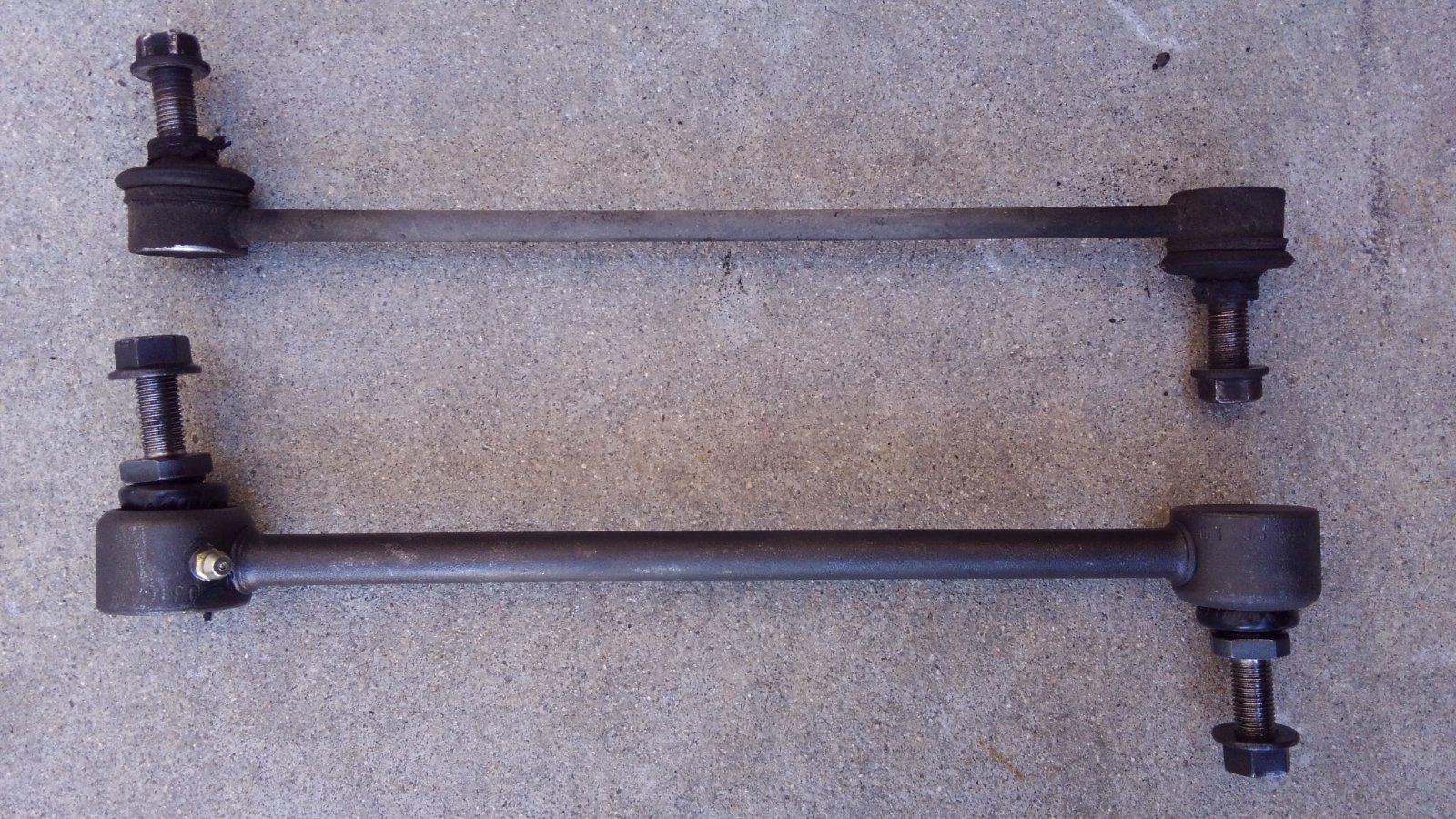

This is quite a retro post, but finally posting pictures of my replacement Moog front sway bar end links. After some creaking noises up front that were not resolved with new struts, I decided to check on the sway bar bushings and end links. The bushings looked fine but the end links looked like they needed a replacement at 100,000+ miles. I decided to go with Moog aftermarket parts due to price and availability on RockAuto.com. Having now seen them in person and installed them, I prefer them over the OE part due to the more robust build and the grease nipples at each end. The Moogs fit without issue and has resolved the creaking noise I had for the most part.
I have yet to install the rear end links but they are basically the same design, just much shorter.
Below is the comparison photo. The top part is the old Suzuki OE front sway bar end link. The bottom part is the new Moog front sway bar end link.
