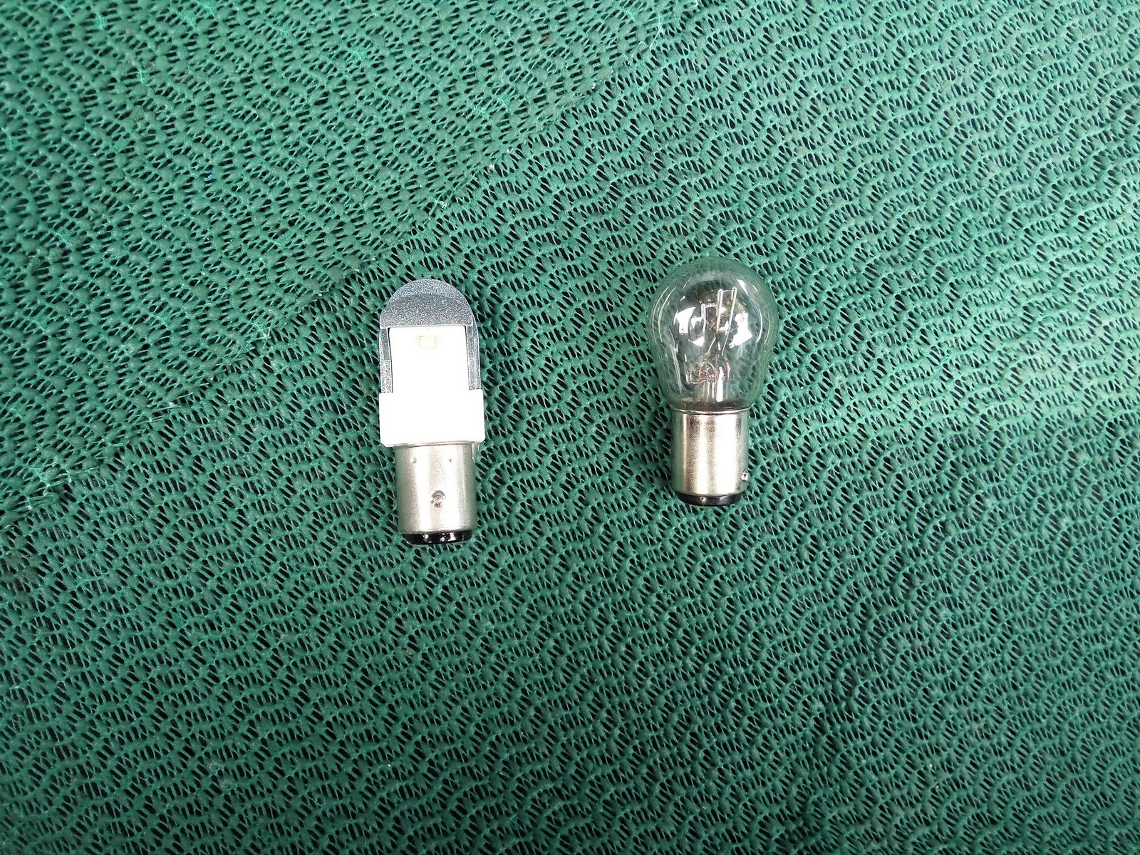

honsonwong wrote:I have changed the brake and tail light bulbs.
Wait, I had to edit my original reply.

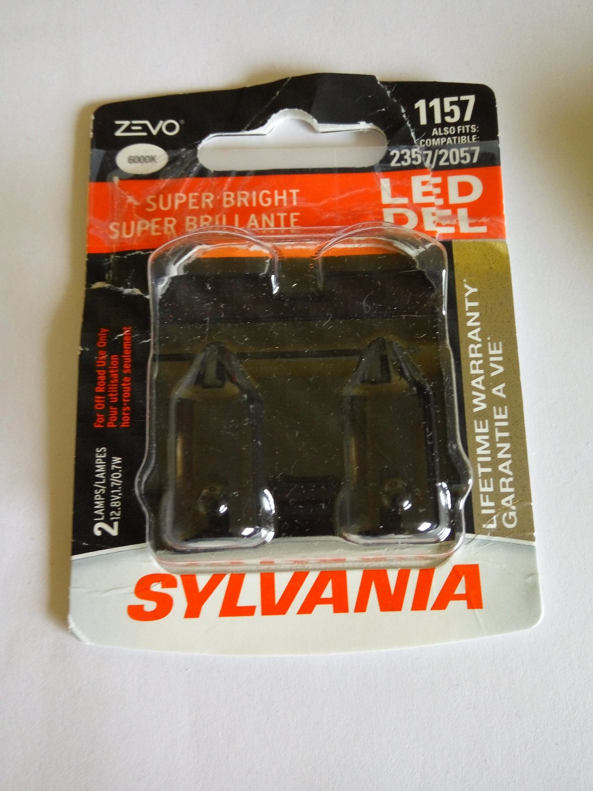

Is what's in the photos the exact product you installed as the brake lights? If so, you should get an exchange and change them out for 1157R. The "R" indicates Red.
Those LEDs pictured are 6000K white LEDs which will wash out the red of the lens. Hence, the brake lights will look more pinkish white than red when in use. These aren't technically legal for street use for things like brake and turn bulbs and are intended for use such as reverse lights.
For brake lights, you need to have red emitters in the bulbs; basically red LEDs. Same thing with amber bulbs and amber LEDs. Basically, when it comes to LED bulbs, you need to make sure the emitter is the color that you want the light to look.
I have the same bulbs but with the actual red emitter for tail and brake light use. Red on red gives it a deep red color that's bright and looks exquisite.
These are the actual ones you need for tail/brake light use: (Note that the packaging below says 1157R and that the bulbs have red LEDs in them.)

LPSISRL wrote: Image
I wonder why they don't make it obvious and label the package somewhere with the word "RED" in big letters instead of an easy to overlook "R" in the part number.
I agree. While the packaging does state "RED" and "For Red Lens", it's way too small and easily overlooked. This is especially important because these bulbs are to replace incandescent bulbs of which most don't have different color variants. Most people will pay attention to the bulb number rather than other small print.
The packaging for the LED bulbs need to be very distinguishable to tell the red from the amber and the white LED bulbs given they share the same bulb number.

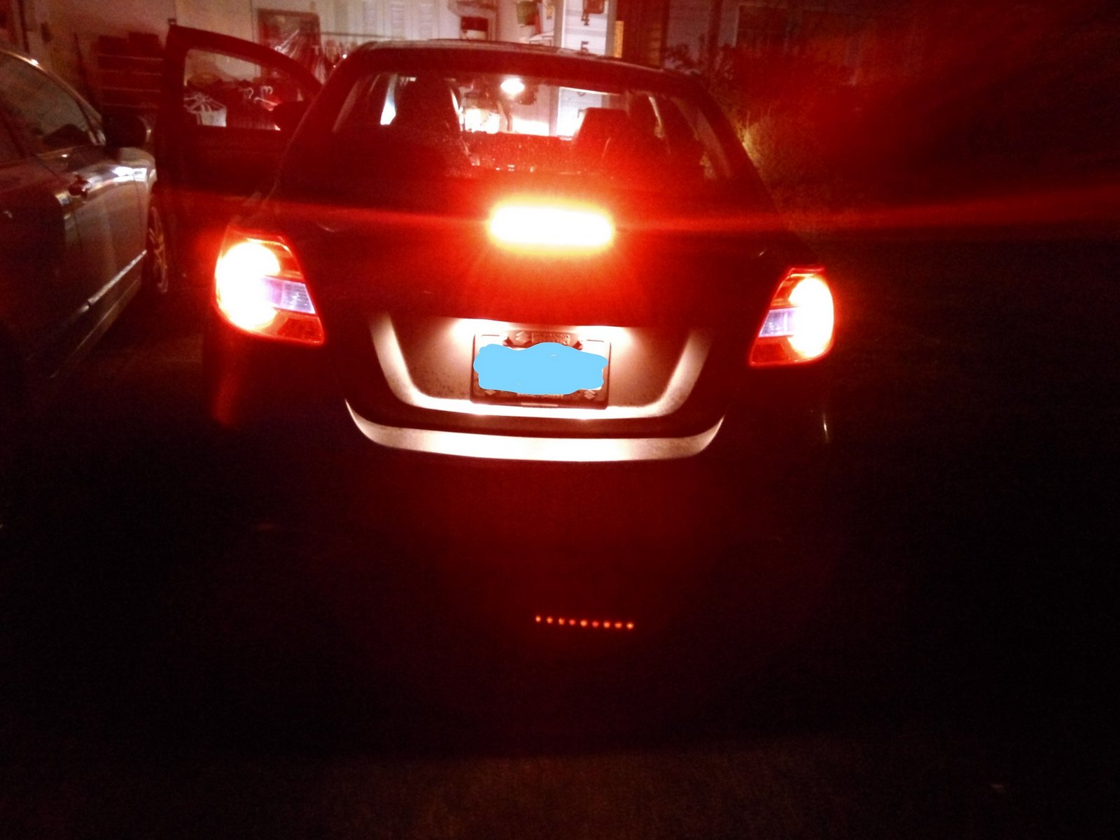

I have noticed that when I bought the light bulbs. However, I just thought that the cover is red already, and the original light bulbs are clear too, so I simply thought that 1157 is okay, but I am not sure. Following are two pics showing the tail light only and with brake light on. Do you think I still need to replace with 1157R?

It's hard to tell from the photos, but if the lights look pinkish, then getting the 1157R bulbs would be better. If the lights look fine and similar to the original, then maybe they are fine as is.
It's just known that white LEDs wash out the lens color and have the LED emitter color come through more. That's why they recommend getting the actual emitters to emit the desired color.
