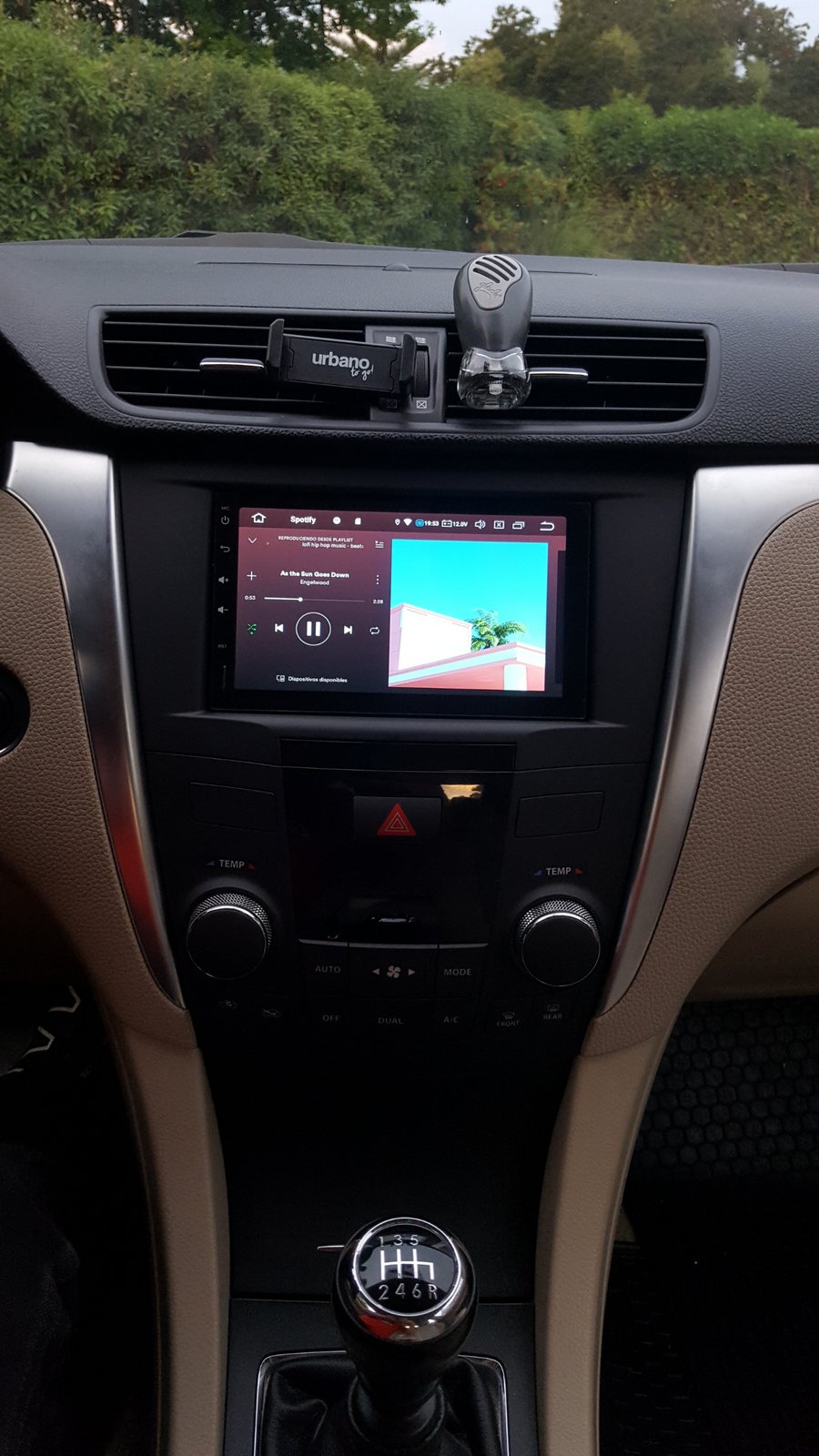

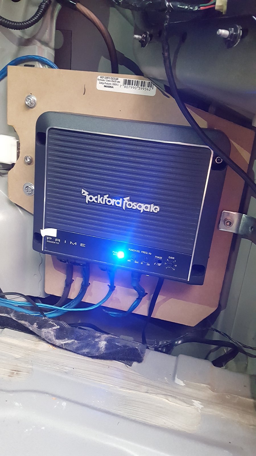

I been doing some upgrades to the audio, change the stock non rockford head unit with and android unit, 4gb ram, 64gb of internal memory, Dasaita MAX6 7 inch. Installed a new 4 channel amp to power up the speakers (alpine ktp445u) and one monoblock amp (a rockford) for the subwoofer that fits perfect where the "OEM Rockford amp" goes. The sound improvement was huge and the new functions in the head unit refresh the car up to modern days.

And the reverse camera work?rav_andres wrote:I been doing some upgrades to the audio, change the stock non rockford head unit with and android unit, 4gb ram, 64gb of internal memory, Dasaita MAX6 7 inch. Installed a new 4 channel amp to power up the speakers (alpine ktp445u) and one monoblock amp (a rockford) for the subwoofer that fits perfect where the "OEM Rockford amp" goes. The sound improvement was huge and the new functions in the head unit refresh the car up to modern days.

Look good mate. Keep up the good work. Looks like you have the full manual car.
Wish mine was manual.

Works fine, the only thing that is "not right" or could be better is the factory alignment or angle where the camera is mounted (im using the oem slot. To make it work, just connect the camera to the reverse light.
