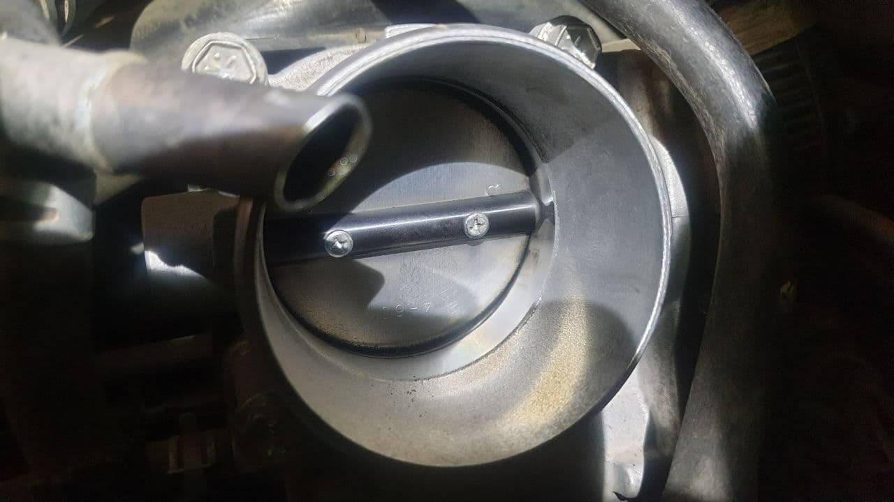

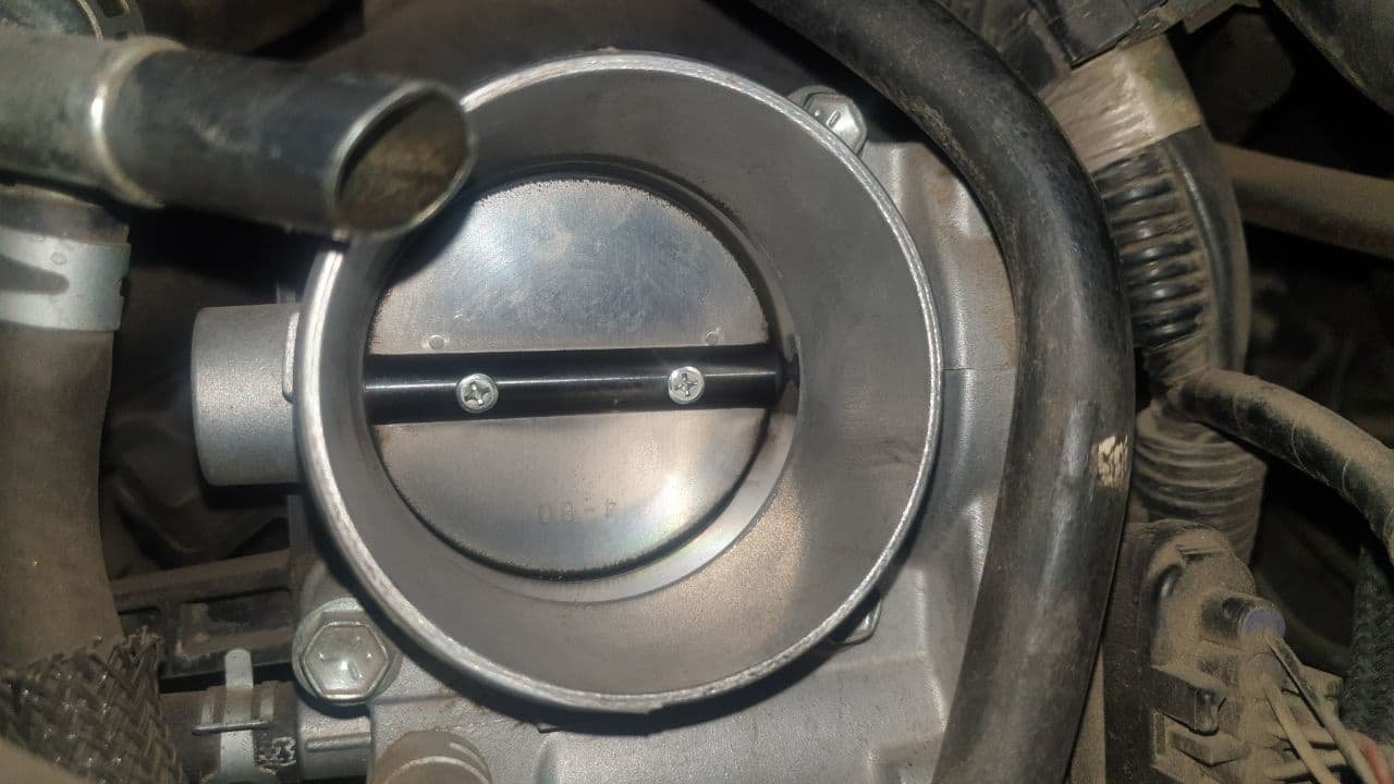

Posts: 517

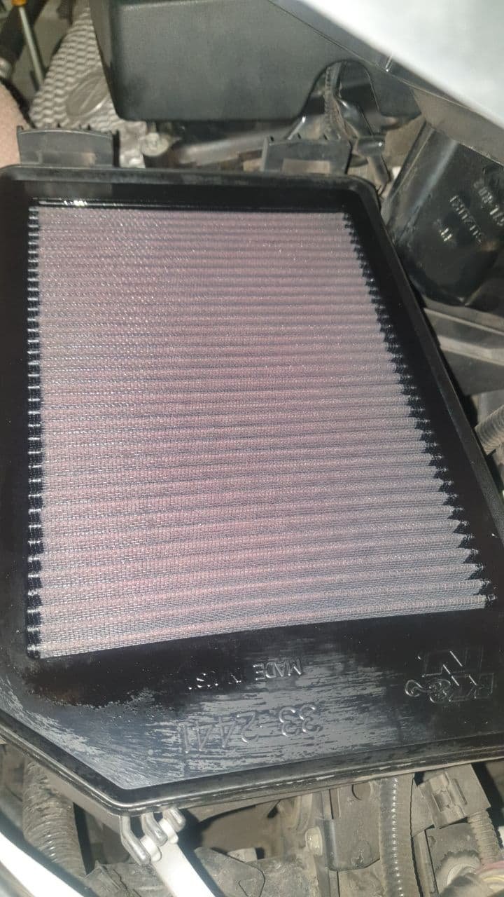

2 years passed. today I checked TB again and it looking good no oil contamination I must say after 3 years of using K&N filter I am happy with the result.
I usually clean filter every 3000km with K&N recharger kit and for money I think it pays off completely and for performance I cannot say it is better than OEM filter but it's not worse .
Posts: 5180
It's the MAF sensor that gets gummed up more from K&N oil due to the proximity but it looks like you're doing a great job at maintaining and reoiling the filter correctly.

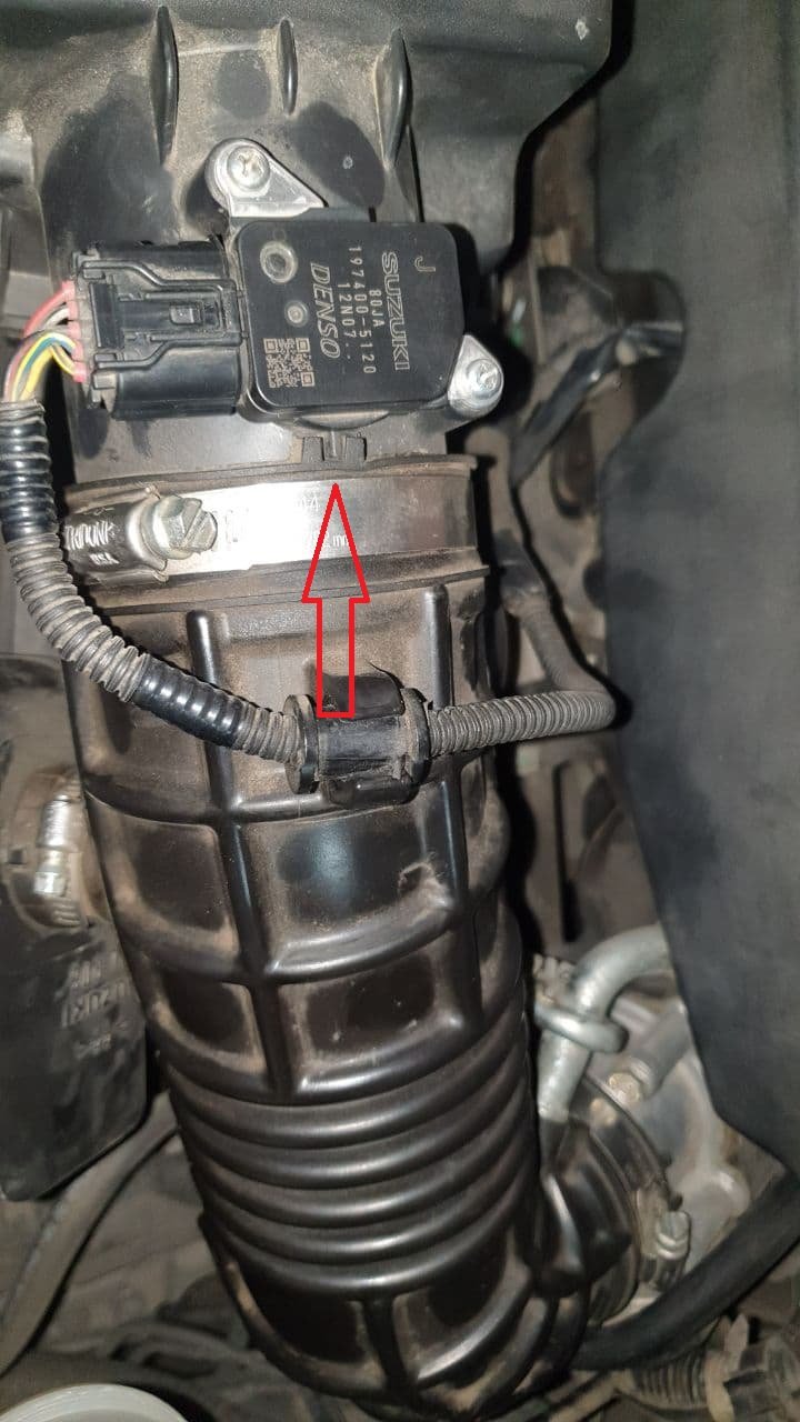

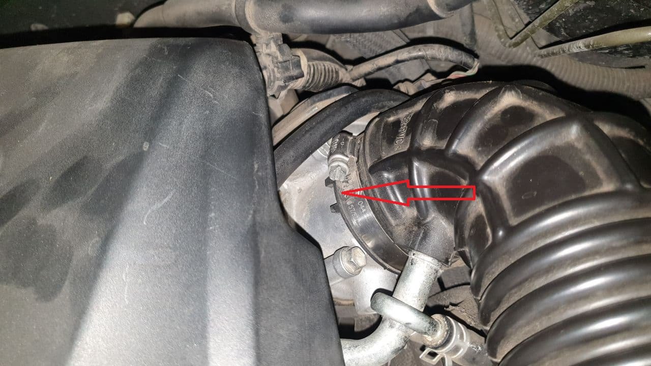

Posts: 517
at 153,000km I noticed an increase in fuel consumption when I plugged scan tool MAF reading was 4.6g/s way too high at idle.
first I think MAF was dirty when I checked I found a problem outlet hose was not correctly placed by me last time I check after correcting the hose placement MAF reading back to 2.5g/s.
I think it is better to check the hose notches after every service in MAF or TB
