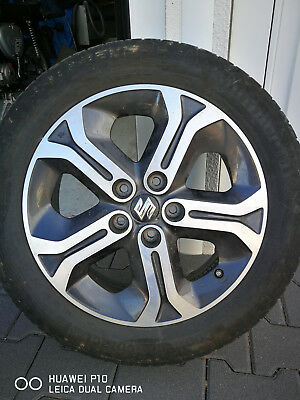

My plan is to strickly stick to the factory recommendation. That beeing said, the only option with 17 inch rim would be 215 55 R17. I would only like to see how it looks on a car. Can you post the photo of your car with 215 55 R17 here in topic? Thanks in advance....

The rims that I had in mind are the ones made for newer Vitara models from 2015-2018. If I am not wrong, these would fit just fine...
