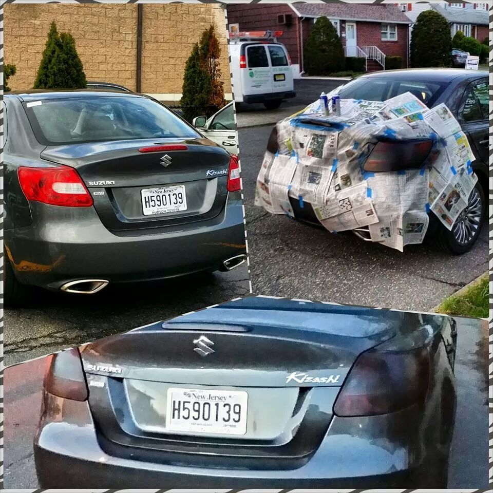

Tinted my tails last night. I used plastidip (in case I didnt like it I could peel it off). I used black dip, not the plastidip smoke...the smoke spray comes out gray and looks like gray spray paint. I did 2 coasts of black and 3 coats of plastidip glossifier. Now today the plan is to do those huge orange markers on the front bumper lol.
Dont mind the crappy cell phone pics, once the sun starts to go down so does the quality of the photos lol
