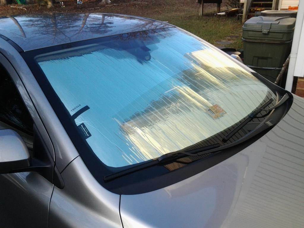

My Weather Tech sunshade came in today (massive back order on them); ordered 12/31/14 got them 1/31/15. Anyways, it fits flawlessly-- covers the whole windshield with the only gap being the location where the mirror is. It has 2 sides, one for reflecting heat in the summer, and the other to absorb heat in the winter to reduce frost build up by releasing heat when the temps drops... supposedly. I'll have to give this a go soon.

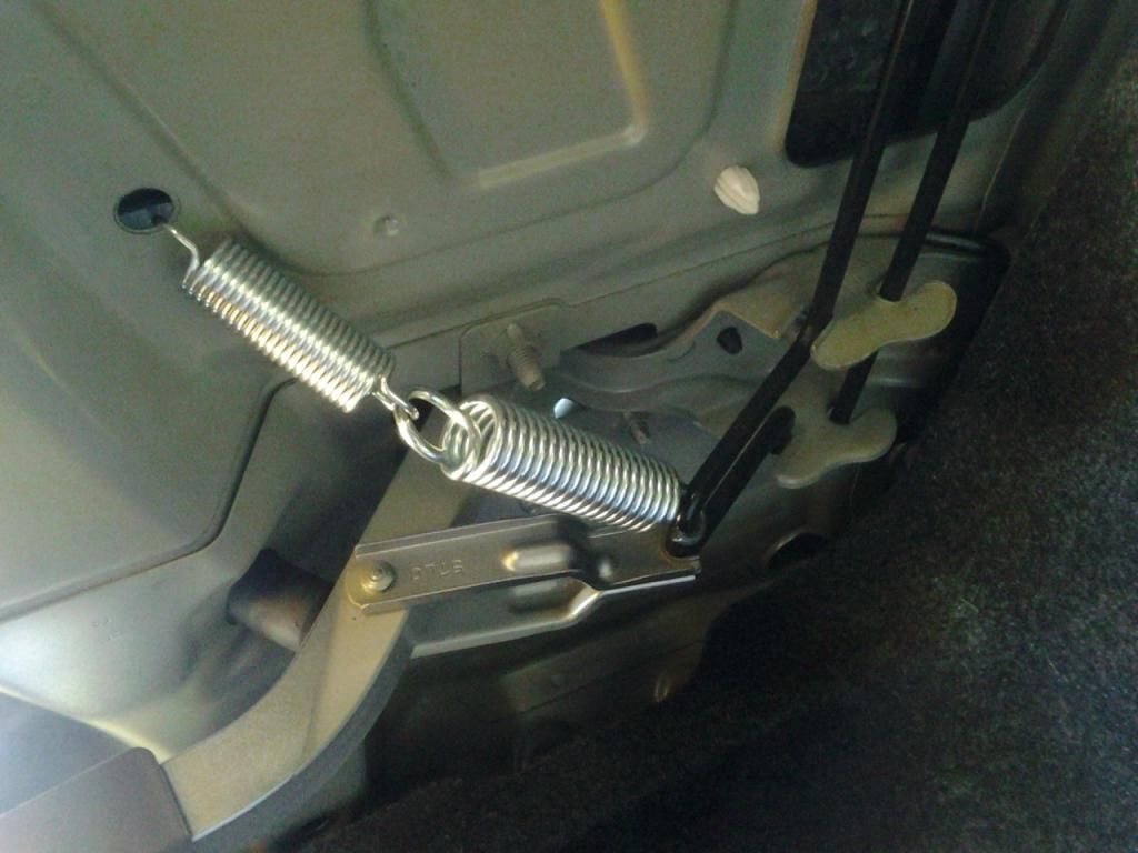

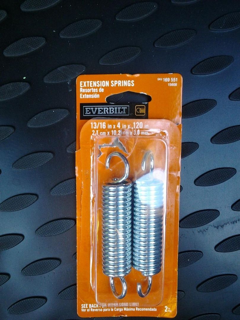

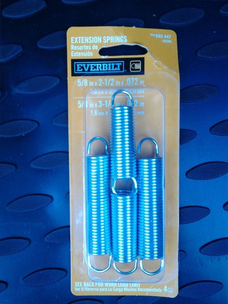

I completed the bootymac special, trunk mod using the closest springs I could find at Home Depot that matched his measurements. Here are the springs used:
Larger spring. (13/16in x 4in x .120in @ 61.70lbs workload limit)
Smaller spring (5/8in x 2-1/2in x .072in @ 19.10lbs workload limit)
Installed springs. Opens the trunk about 3/4 full open (which is fine for me for I'd fear water getting in if it's raining hard and I am not at the trunk just yet).
It looks like you hooked the spring onto the black torsion bar. If you hook it to the back of the actual hinge, the springs won't move
