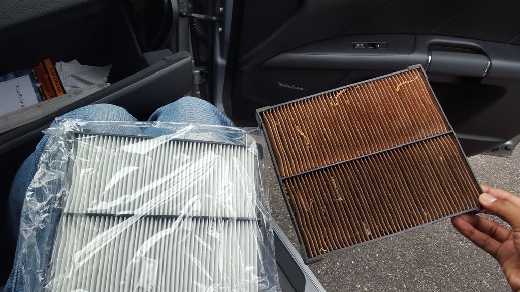

Took my car in for the 30k service Thursday. Fresh oil and had them put in a K&N oil filter I had bought earlier. Tires rotated too. I installed a K&N air filter once I got back home and also replaced the cabin air filter in a couple minutes. Wow, what a difference the cabin air filter was, and the funky smell that occasionally plagued my a/c when turned on stopped immediately.

DesRado wrote:Took my car in for the 30k service Thursday. Fresh oil and had them put in a K&N oil filter I had bought earlier. Tires rotated too. I installed a K&N air filter once I got back home and also replaced the cabin air filter in a couple minutes. Wow, what a difference the cabin air filter was, and the funky smell that occasionally plagued my a/c when turned on stopped immediately.
The mechanics told me that that engine coolant and transmission flush weren't needed until the next service. Also they said the spark plugs would be due at the same time. I think I'm gonna do the plugs myself since it seems a simple enough task.
Yeah, the cabin air filter gets shockingly nasty even in a short amount of time. I'm going to check it every year and replace if it's nasty.
