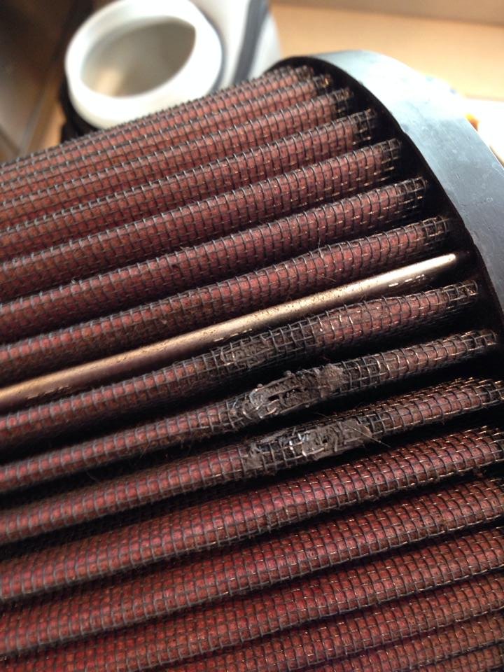

In March I purchased Road Race's ram air intake. So far, I love the intake, totally worth it, would buy again - except for one small detail I discovered today. I took my intake off to clean it, and discovered part of it had been melted.
Not a total failure or anything close - just a little singed. The way the intake is set up and angled the filter rests on the transmission/engine mount. After cleaning the intake, I decided to try and bent the support so that it raised the filter up off of the mount.
I was just wondering if anyone has any ideas for a more permanent solution? The heat shield that came with it cant be adjusted, and appears to only deflect heat away from the main engine, not the mount and transmission.
Someone suggested cutting off a piece of the original intake and using that as a heat shield, but Im leery of cutting up OEM parts should I ever need them again.

Check in your engine bay where it was sitting - I'd almost be prepared to bet that it's actually been rubbing on something and isn't melted. ;)
(I had the same thing happen to a K&N pod filter many years ago from it hitting/ rubbing with bumps and vibration.)

It was rubbing on the engine/transmission mount. I knew that would either be touching or pretty close to it, but I guess I underestimated just how hot it would get.
I hope mine doesn't follow the same timeline! Although the weld job on it and way the heat shield is positioned would make me agree that the build/design work is shoddy at best.
Someone suggested thermal wrap at work to insulate the filter from the mount. Has anyone else ever used this stuff?

KizStar wrote:It was rubbing on the engine/transmission mount. I knew that would either be touching or pretty close to it, but I guess I underestimated just how hot it would get.
IMHO it hasn't got hot - that's damage from it rubbing. The engine/ transmission mount wouldn't get hot enough to melt metal; if the damage was from extreme heat melting the stainless (?) steel flywire, then the whole of the oiled cotton section would have gone up in flames! ;)
BTW it looks like there are holes worn through it - on the middle and lower pleats. You might want to somehow seal them up. Or contact RRM for a replacement....
I'm with Murcod. That's not heat damage, but friction damage. How do I know? I had the exact same issue with my old K&N type filter in my Subaru Impreza. The problem was that the filter rested on a metal part and from the engine/road vibrations, the filter got damaged. The damage on your filter looks identical to the damage I had. The solution was to use the mounting bracket that came with the filter and mount it properly so the filter was suspended and not touching anything. You have to also account for when the vehicle is in motion as engines move quite a bit when running.
