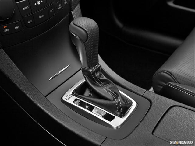

You can manually override the shift lock. There should be a little tab near the shifter. If you pry that with a key or flat screw driver, there should be a button down there you can push down with a tool like a pen or a screw driver. This allows you to shift the transmission out of the current gear. This is how tow truck drivers get your car into Neutral from Park when they tow your car. You don't need the key to shift this way.
The shift lock override button cover tab is that thing above the P indicator. All automatics have this. Possibly this could have saved you a tow.
Regardless, nice of the dealer to replace the whole assembly and resolve the issue.
