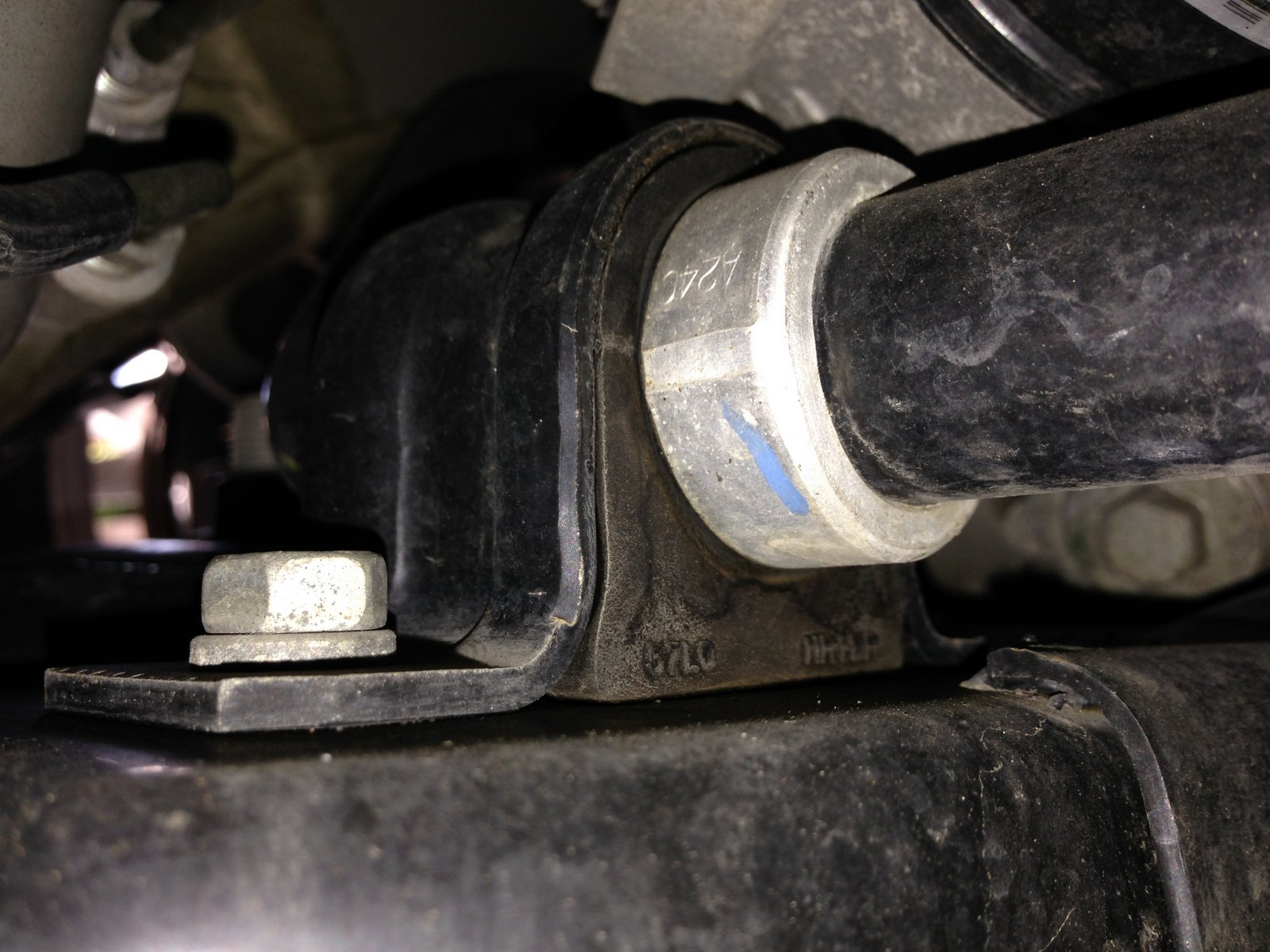

I investigated replacing mine and finding a generic fit D bush proved a problem. OEM bushes are often a different shape to aftermarket bushes (usually on the side that fits into the saddle clamp.) The best option I could think of was buying both a generic bush and matching generic saddle clamp for that bush. You need to also look at bolt spacing of the new clamp vs the subframe, while also keeping roughly the same clearance from the subframe to sway bar.gmkizashi wrote:Can they be that unique?
Here's a pic of the stock front D bush

Yes, that link's in the other thread I posted. That was the most feasible option when I was looking, but you'd need to pull things apart to get accurate measurements before ordering a new bush and saddle clamp. I measured my bar at 24mm (15/16")- curse Energy only having imperial measurements....
