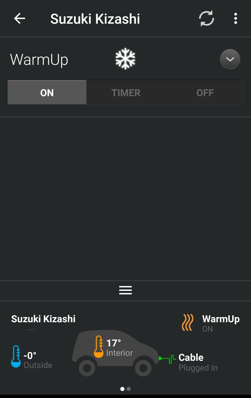

This thing is great.
I had it installed when I bought the car, two years ago.
No more cold in the car when I go home. Don't have to clear the windows of ice. Engine is preheated, which saves fuel and wear.
It can be set to timer or manual start, depending on your needs.
The only trouble I've had with it, is with the app. They shut the system down for maintenance. Obviously, those are needed as well. I gave them a call and told them to notify their customers of an impending maintenance.
It isn't very cold outside right now, but just as a reference.

Basically, a heating element and other required components are plugged into the coolant system. Getting the engine warm for start. Releasing less toxic fumes than a completely cold engine.
On the picture, when I plug the cable into the car, (I can take a picture when I get back), the app (and car) "knows" It's plugged in. It needs mains power to work.

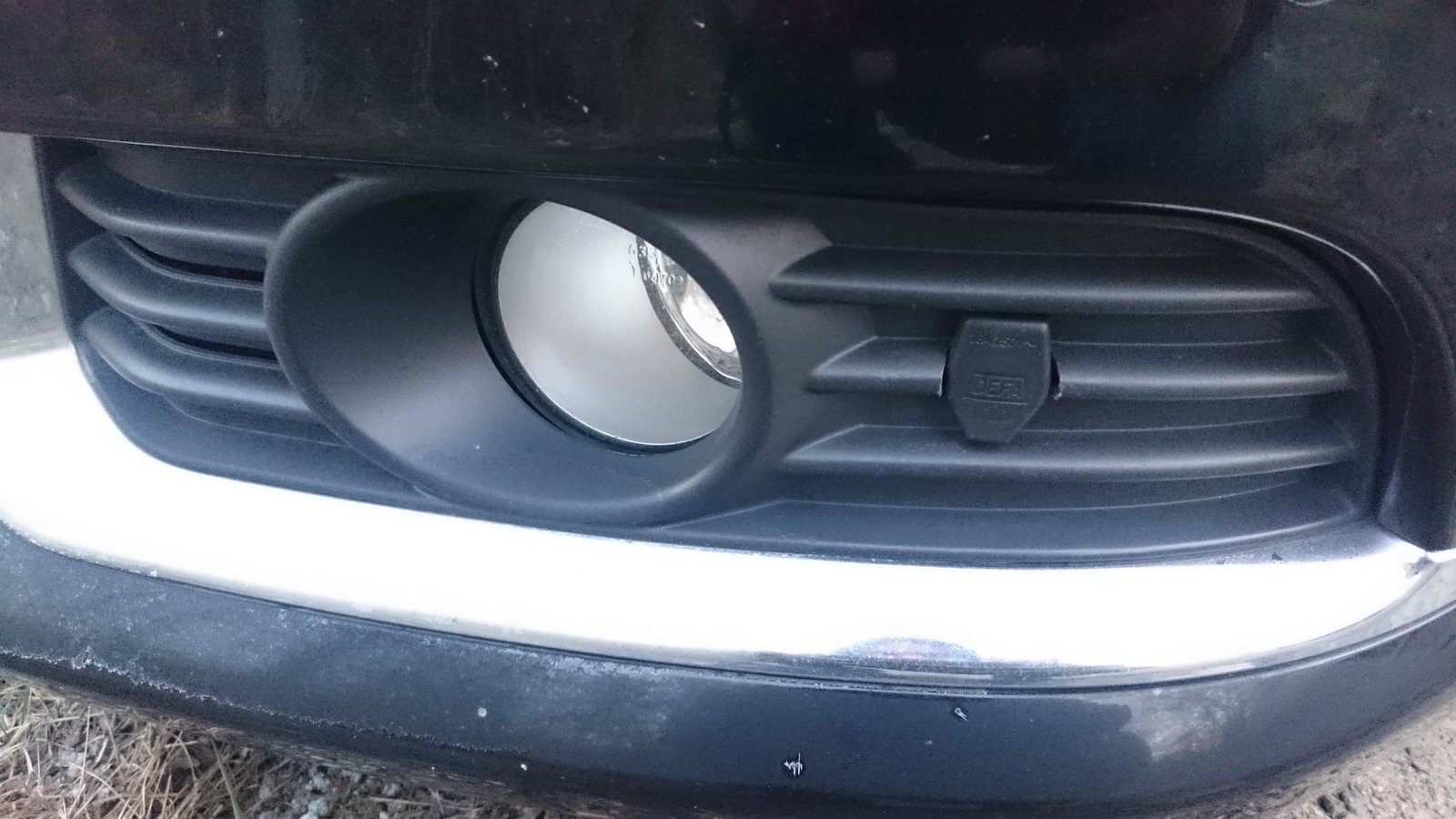

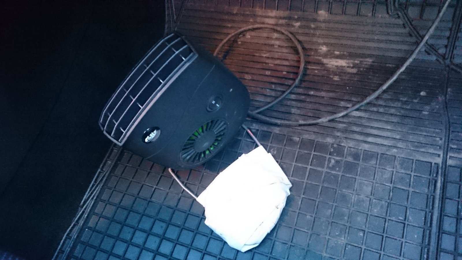

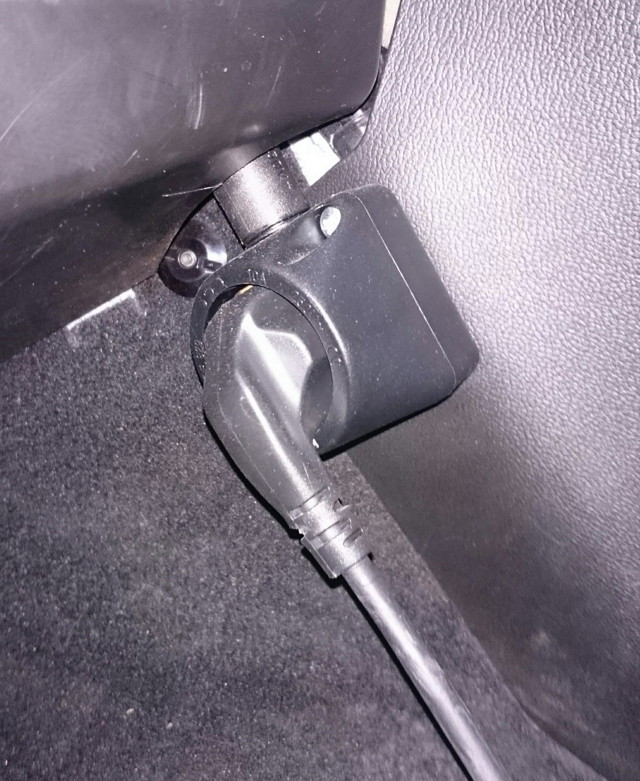

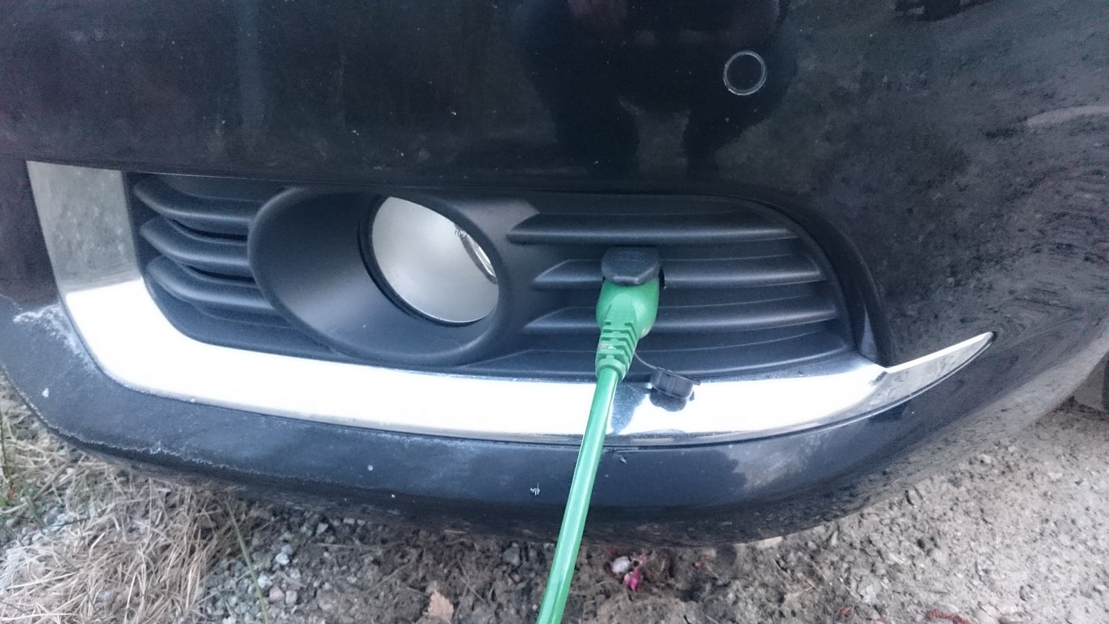

Here are some pictures.
I couldn't access anything under the hood.
Added the outside plug, with and without the cable connected.
The interior fan. I taped a weight on the foot, so it wouldn't tip over when driving.
And, the socket for the fan. It's hidden under the glove box.
There was a choice to have one mounted into the interior of the car. I told them no, I want a socket so I can remove the fan when I don't need it.
Besides, a mounted anything will cause rattling.
