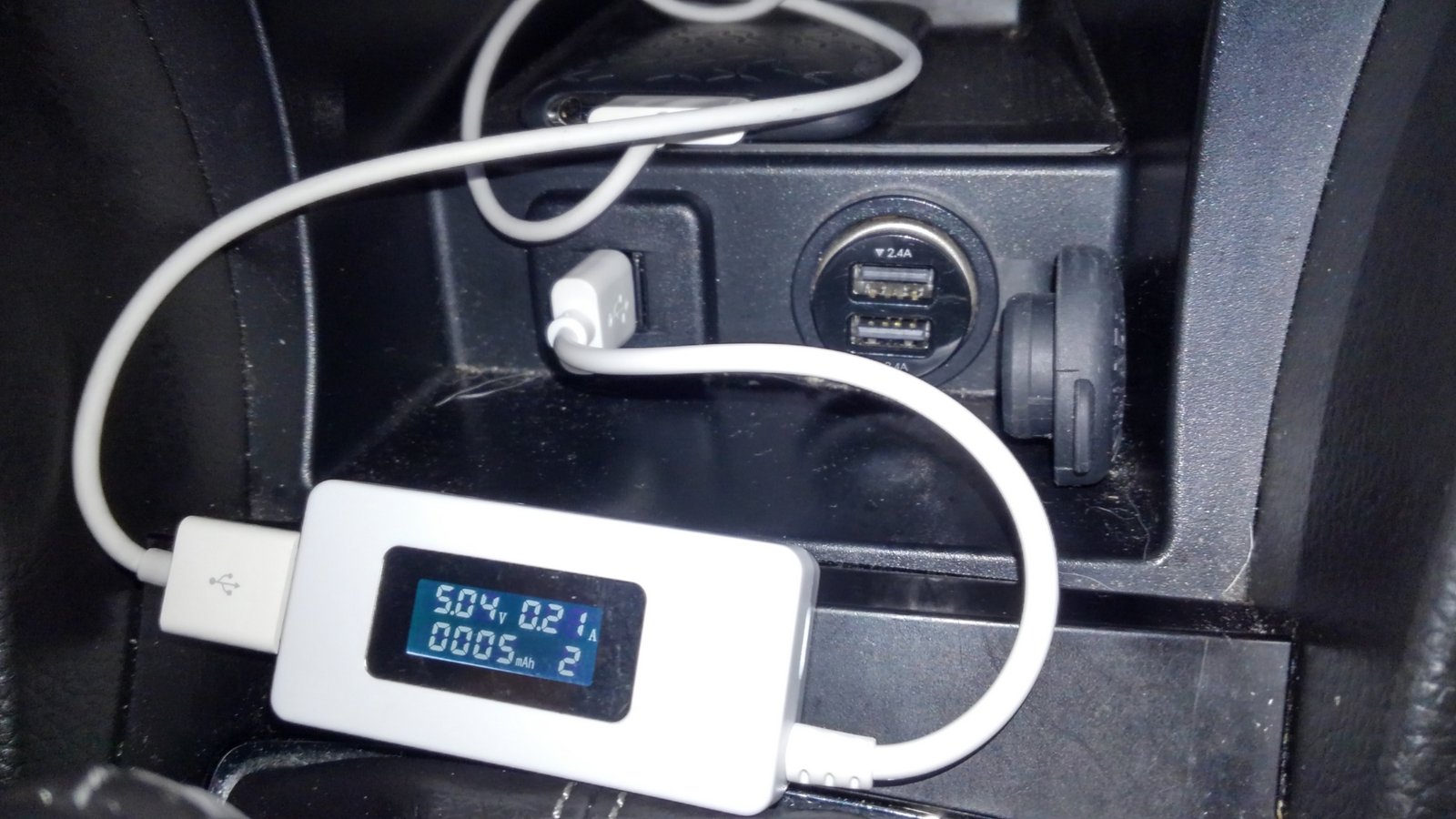

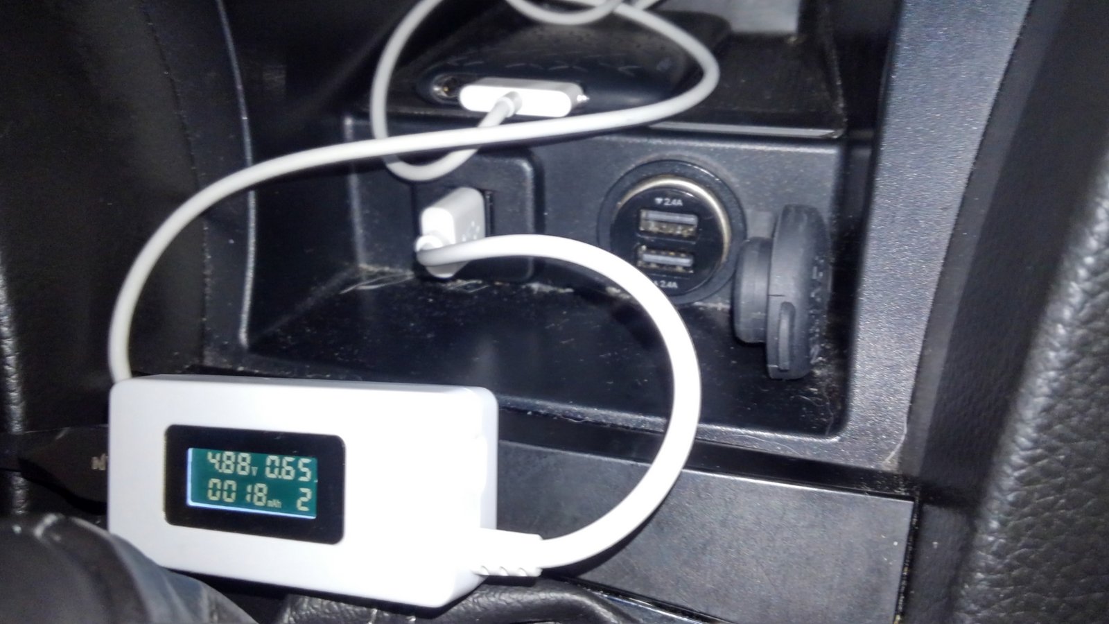

I actually have a device that measures readings for voltage, amps, and mAh for USB devices. When I saw your post, I got curious so I tested it out. Amperage will differ by device and how it's used but none of the three devices topped 1A for the USB port in my tests. My iPod Touch yielded a reading of 0.20A to 0.35A while the dash camera read up to 0.65A, proving that it's not a 0.5A max USB port. I also tried it with my phone and the Kizashi's USB port read about 0.3A while the dual 2.4A charger I have in the cigarette lighter port yielded a reading of 0.99A to charge the phone.
I have a very limited understanding of electrical systems, but it seems to me that it's a 5V/1A max USB port which is pretty standard.
The first picture is from reading the iPod Touch while playing music. The second is with the dash camera connected while recording.

The reason I asked is that I have taken a few trips in my Toyota Sienna with my LG Stylo android phone running Waze and streaming music with Radio Droid and the battery stayed at 100% after hours of driving. I just drove 72 miles in my Kizashi running Waze & Radio Droid and my phone was down to 38%. I was shocked. Maybe I did not get the USB cord plugged into the phone all the way? When I plug the USB cord into the phone now it beeps a connection and seems to be charging. It probably is just my fault with a sloppy cord connection. Seeing that the Kiz is capable of at least 0.65A is reassuring.
17 Sienna
Very interesting that the port puts out more than 500mA since the official power spec for usb 1.0/.0 is 500 mA and 900 mA for usb 3.0. Seems as if Suzuki did what most others have done in regards to the power capabilities for usb, unless they implemented some of the 'charging port' parts of the specification.
