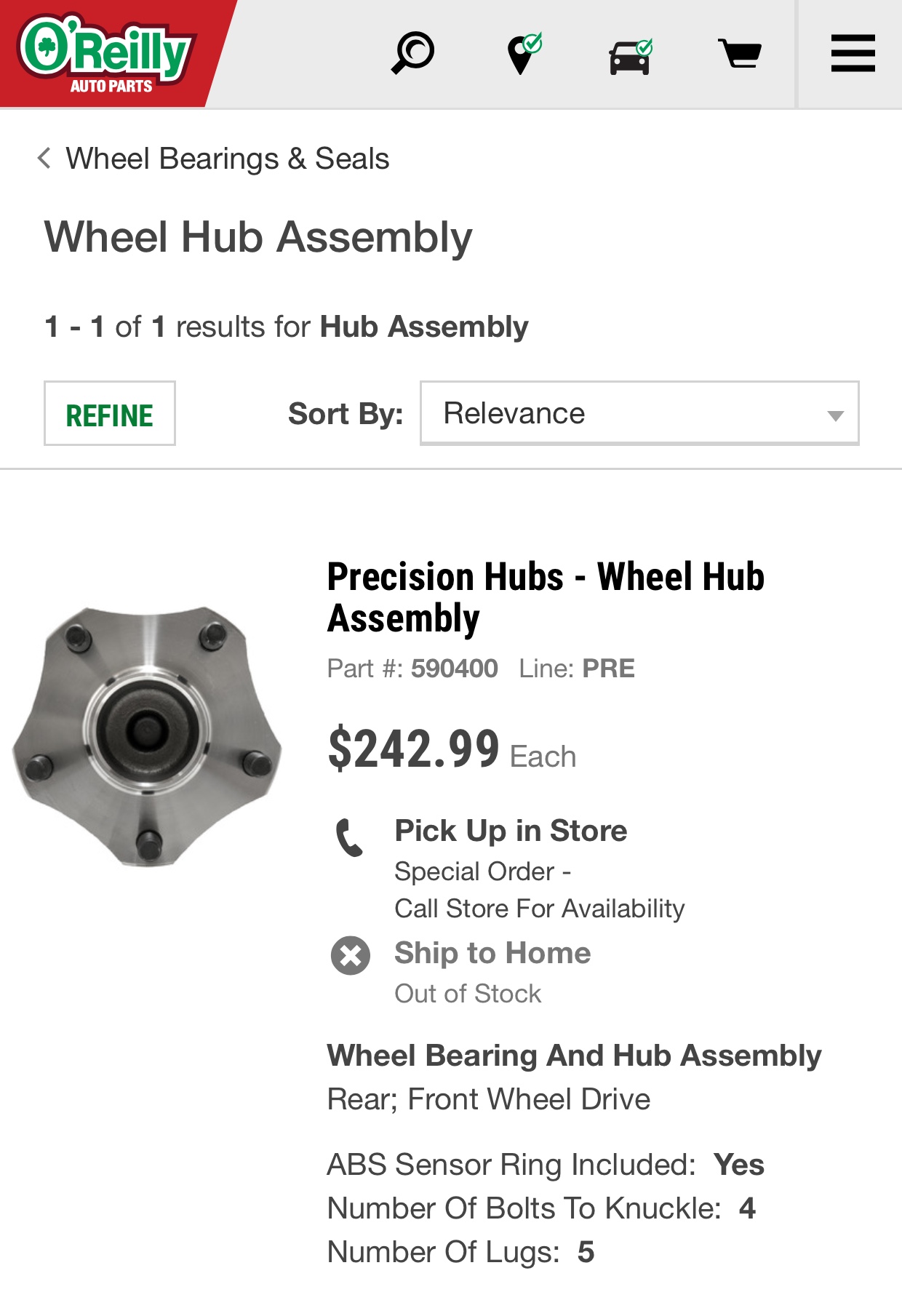

DiggerDerrik
Posts: 171
I looked for the rear hub on a FWD and found one from O’Reillys. Completely different from the front one. Also it’s a real wallet drainer too
2010 Kizashi GTS FWD

diegobear wrote: That makes so much sense, I can't believe I didn't think of that. Still, I wonder why the Raybestos hub doesn't differentiate -- I wonder if it's FWD or AWD
If there is a picture of it, that will tell. Hubs that are driven with an axle have a hole with splines in them. Hubs that aren't connected to an axle have a cover.
For example, below is a rear hub for an AWD Kizashi from TIMKEN.
Below is a rear hub for a FWD Kizashi from TIMKEN.
See the difference?
