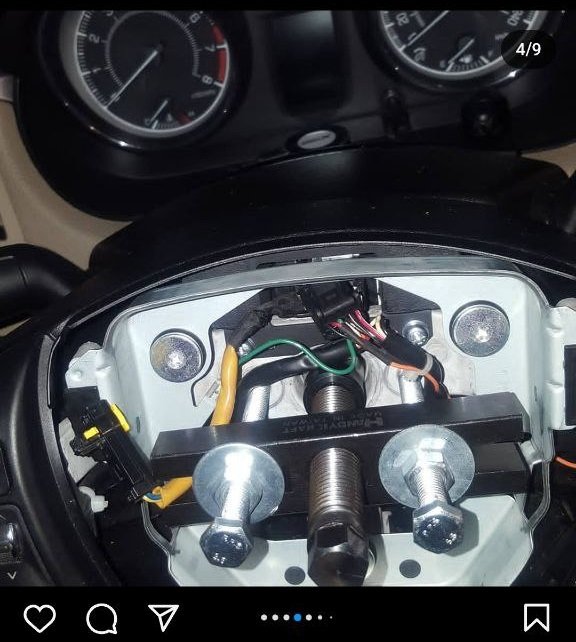

How do you change the steering wheel in a Kizashi? Is it hard to remove / re-install?
AirRideFan wrote: Wed Jan 24, 2024 9:59 am How do you change the steering wheel in a Kizashi? Is it hard to remove / re-install?
you need a steering wheel puller and 2 long bolts bolted on your steering wheel and then with the help of a steering puller you can take it out.something like this
Posts: 802
Above is the correct way. I cheat and just loosen nut 2 turns and place feet firmly on the floor and pull and wiggle steering wheel.
