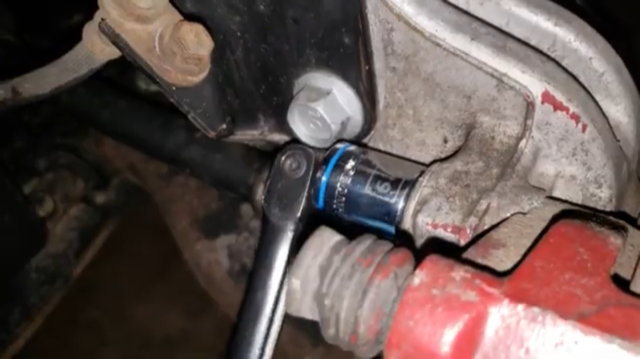

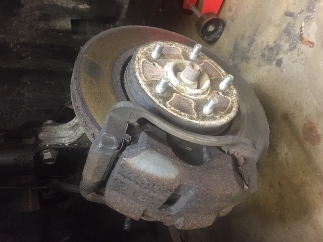

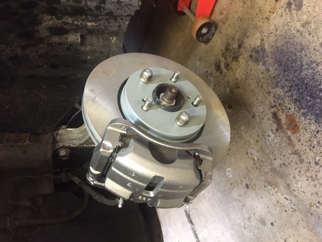

Well, good news, I didn't need to replace the bearing. Turns out the rear brakes were just shot. The rear pads were completely gone and it was metal - metal contact, my fiance claims they were just looked at/approved by a mechanic. Anyway, here are some pictures. A couple things to note, which were news to me.
The rear brake caliper pistons need to be turned clockwise to retract.
You need a low profile torque bar combined with a shallow, thinwall socket to remove the front caliper

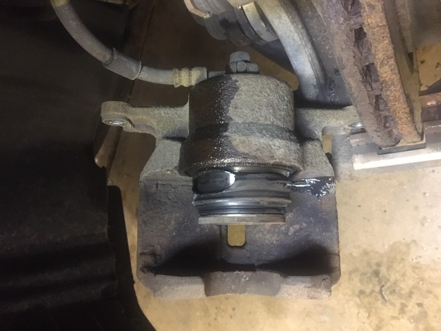

After removing the front caliper, I see the rubber seal is torn and the caliper needs to be replaced/brakes bled.
Before and After:

A couple things. On the rear calipers, the clock position of the caliper piston slots must be parallel with mounting bolt holes so inside pad alignment nub falls into the slot. Living in an area prone for rust , its important to remove the stainless hardware off the caliper bracket and file the rust build up off and reinstall so your pads have a little clearance also make sure your caliper slides are free. On the front caliper, the torn piston boot is becoming more common and its available inexpensively . See post cheap fix. When you posted you needed a fwd rear wheel, I thought it was odd to need one because i hadnt seen one. Your noise should have been maybe a light metal to metal and then way heavier when nailing the brakes. If it would have been your wheel brg, it would not change noise by applying the brkes
