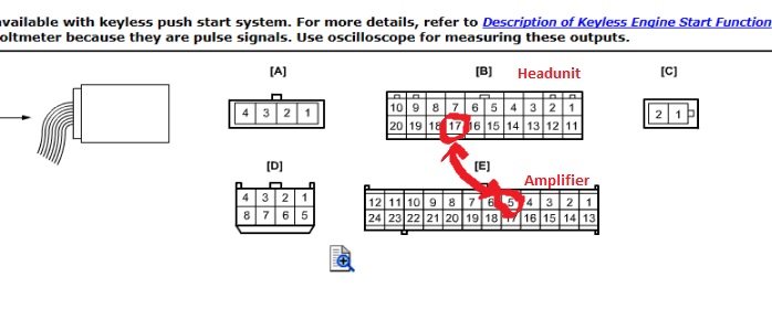

it can be a problem with remote wire of amplifier check pin12 of headunit connector and and also pin5 of Amplifier connector this pins must be 12V when headunit is ON in both side.
New Bitmap Image.jpg (47.09 KiB) Viewed 3962 times
