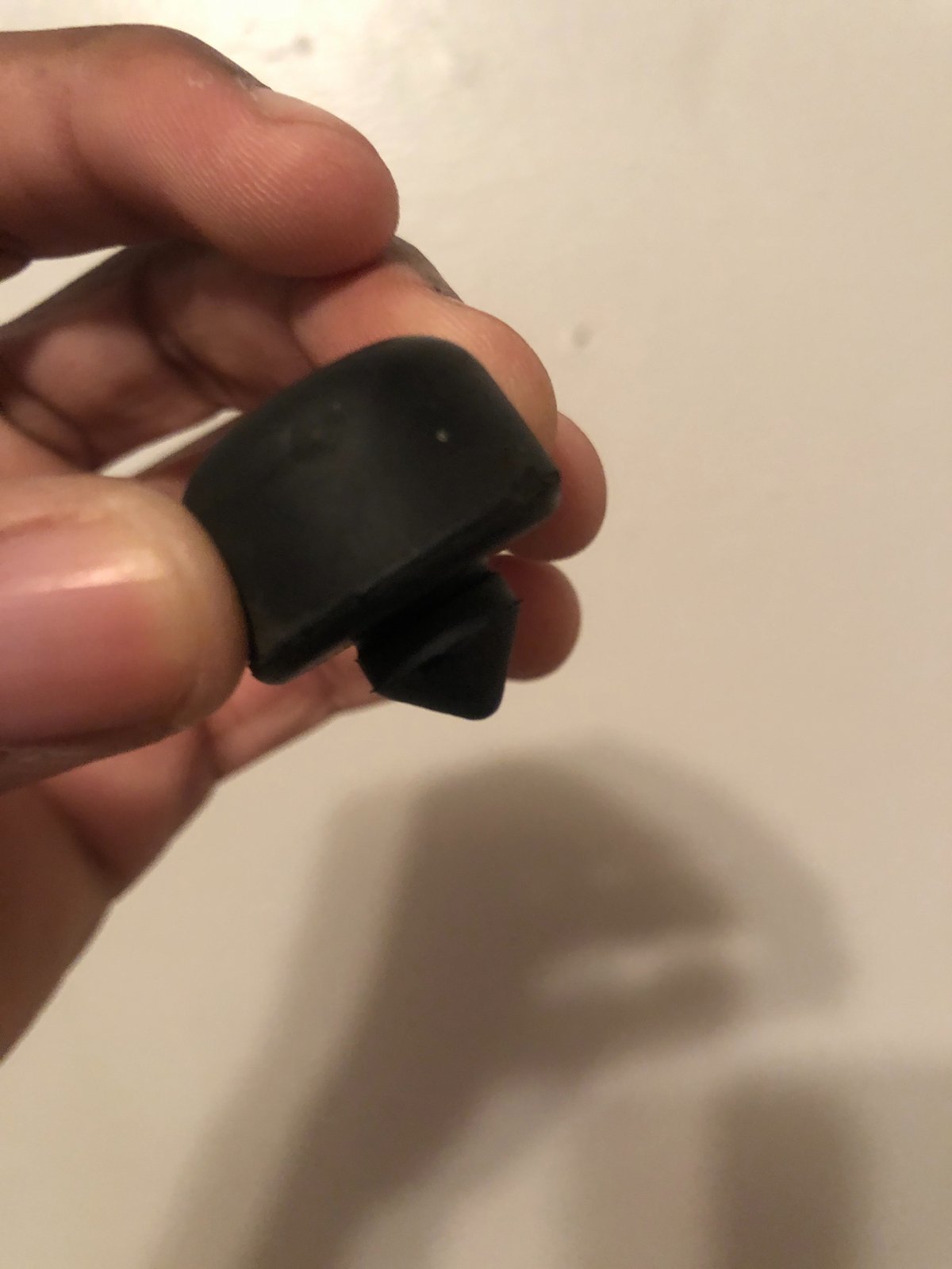

A piece came off my kizashi and idk where it goes

This piece was at the bottom of the inside of my front bumper while i was changing the headlights and i don’t know where it goes. can someone help?
That's a piece that goes on top of your bumper in the engine bay as a bumper for the hood. It's one of the parts circled in the photo below. There are two of them.
I'm not so sure. The hood bumper stops are round a bit thicker. I was thinking maybe from one of the radiators to keep them from rattling around.

It looks like the nubs that Kuro is referring to have little “x” cross imprints in them. You can see them if you zoom in on his image, especially on the left. If the nub that fell off has this design then it’s likely what Kuro is referring to, but if not then maybe it goes elsewhere.

Kuro is exactly right. My brain played a trick on me when I was looking at it. The picture appear to be taken at an angle and not straight on from the side. Weird that I looked at it several times and was never able to resolve it correctly... Until this morning. Now I can't even see it the way I did before.

To me, it was obvious the stopper was from the top of the bumper given the OP said he found it in the bumper during a bulb change.
I'm sure it popped off, fell onto the plastic cover below and then rolled into the bumper cover the first next time the brakes were applied.
