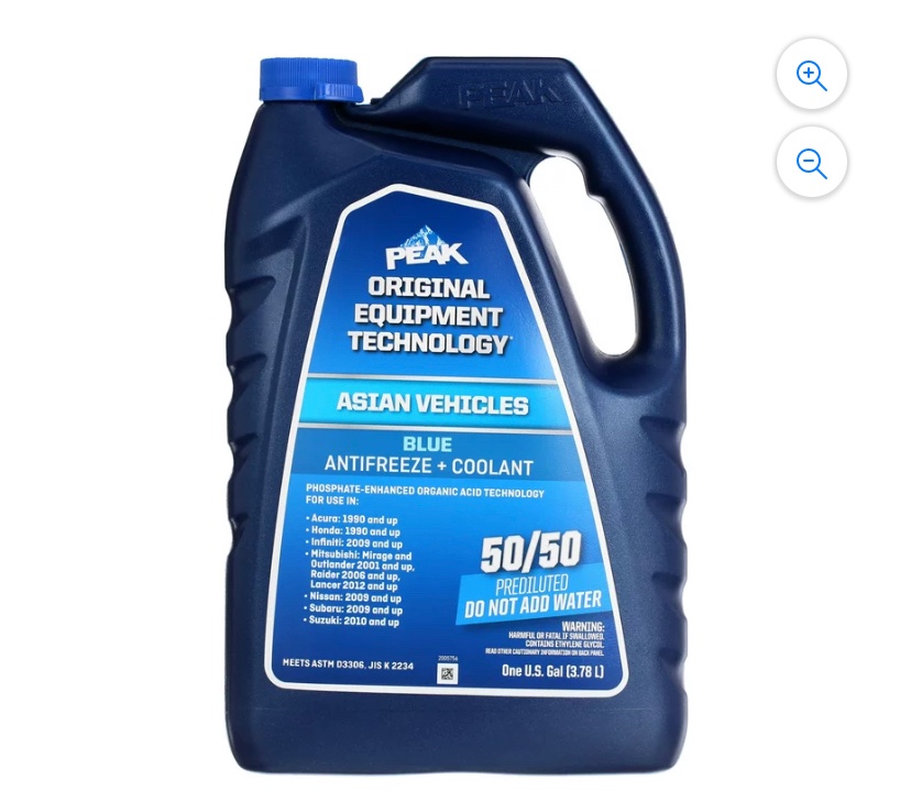

I also bought this coolant for it. Is this okay to use in my model?
Yes, that coolant is fine to use in the Kizashi. It's premixed so don't add water.
