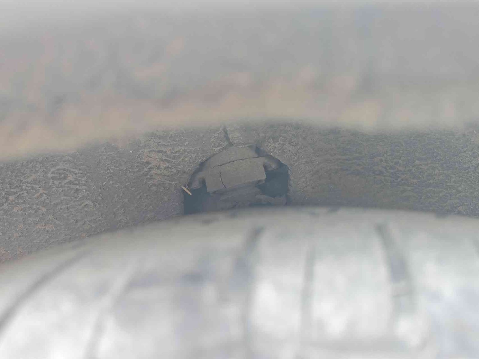

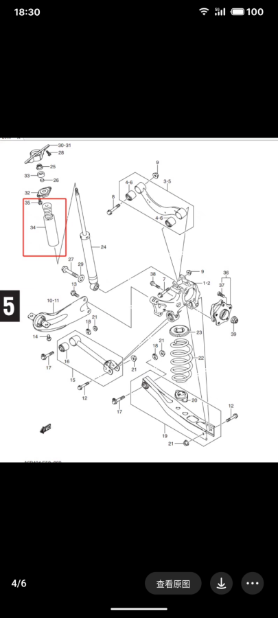

My Kizashi's left rear suspension top mount is cracked. I checked the suspension diagram, and parts 30/31 and 32 are shown as two separate components. Why does my car seem to have only part 30/31? Are there differences in the chassis for different configurations of the Kizashi?

What you need is number 32 shock mount. only sold by Suzuki. About $40. Only replace with new is my advice. The 2 bolts holding this in place are presenting a problem coming apart in salt areas. Breaking them off in the upper bracket will add much more grief . Best to use some skillful heat and even then (2) 8,1.25 studs may be the best solution. (Ford truck exhaust manifold)

Why doesn't my car have No. 32 parts, only No. 30 and No. 31? I bought a used car, maybe the original owner removed the No. 32 shock absorber seat.
Posts: 1196
The cracked bit shown in your picture is part # 32. The part directly above it, which you can barely see, is part #30/31.

pengbo wrote: Wed Aug 28, 2024 12:20 am Why doesn't my car have No. 32 parts, only No. 30 and No. 31? I bought a used car, maybe the original owner removed the No. 32 shock absorber seat.
Like Woodie said, you are misidentifying the parts. The cracked part is #32.
Also, the part you boxed in red (#34) is the bump stopper. The top part of 34 goes into the cupped part of #32.
It should be noted that these parts can fail over time from corrosion, especially in areas with snow/ice thus salted roads. It should also be mentioned that the original rear bump stoppers (34) had a design flaw that did not vacate moisture well. It caused premature corrosion of the rear shocks. It was never a recall but a Technical Service Bulletin. I had my rear shocks replaced under warranty due to this issue about ten years ago. They installed the revised bump stoppers then too.
When you replace your shock mount, replace the bump stoppers too with the newer design if you don't have them.
