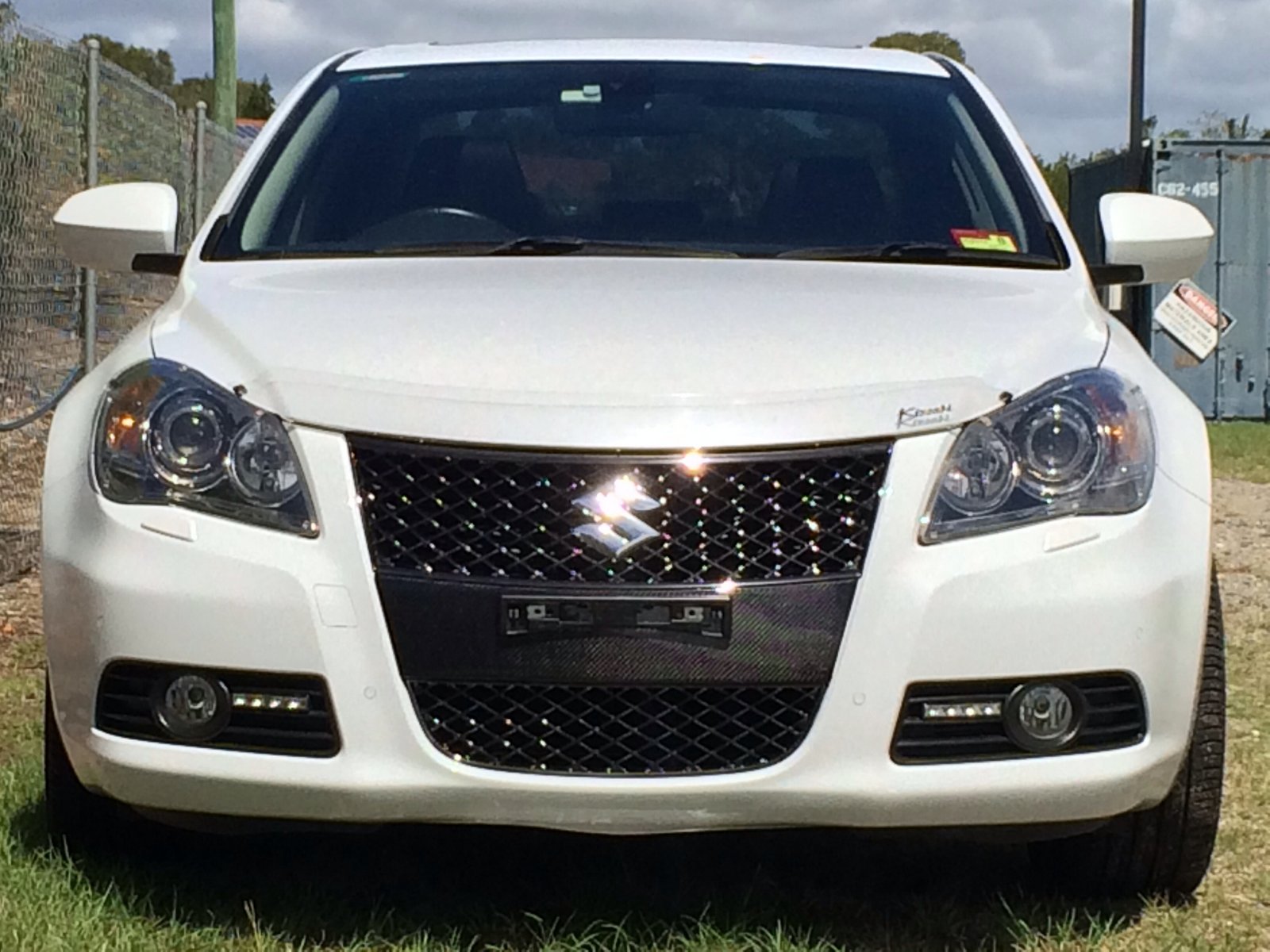

My kizzy
Drl (phillips daylight 4 carbon fibre bumper cap swapped lower grille for cross hatch (awd) replaced Parker's with led

stevesharpe57 wrote:My kizzy
Is that the rrm bumper cap? Looks great.
Looks good. Where did you get that clear hood deflector? I have not seen those sold in North America. The OEM accessory hood deflector I have was even made in Australia, but there was no clear one offered with the "Kizashi" name on it like yours.

Carbon fibre bumper cap from road race , bonnet protector from suzuki Australia
