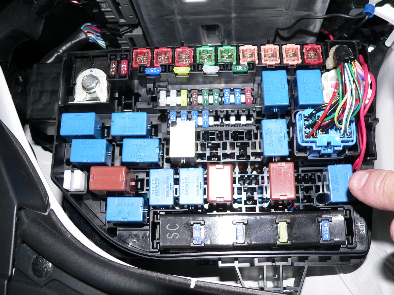

What am I doing wrong!?
Trying to wire up my daytime running LED's exactly how topcat45 did his. But it's not working! I've checked the lights again & again - they work when I connect them to the + & - terminals of the battery, but when I wire them the way topcat45 did, they don't work! I'm at a loss to explain why this is the case! :?

The only thing I can think of is you might be tapping into the wrong + line. See the attached pic, my finger is pointing to relay #33 which controls the rear window demister & you should be able to see the 2 red + feed wires going into the relay near my finger. You have to remove this relay & put the bared + wires into the socket occupied by the relay blade closest to the firewall, then refit the relay so that the + wires are jammed into the socket by the relay blade. You should be able to see the 2 black wires at the top right of the pic attached to a blue crimp connector. This is the earth connector. make sure it is connected to a proper earth. The LED lights then should work when you go to ignition on as well as engine running. Sorry if I have been telling you how to suck eggs, just trying to cover all bases. let me know how it goes ok.
