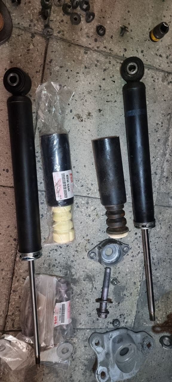

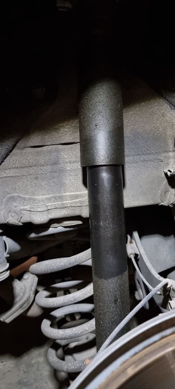

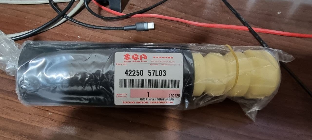

yesterday I saw an oil leak from the rear right shock I knew someday shock will fail eventually so 2 years ago I ordered 2 sets of dust cover part number is = 42250-57L03

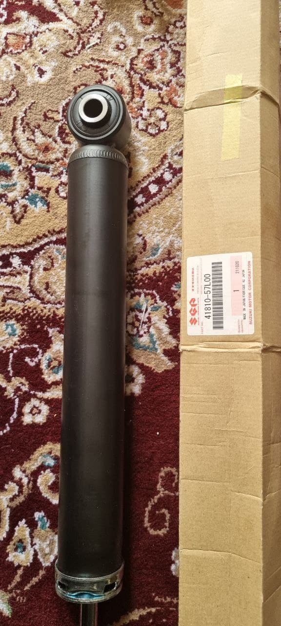

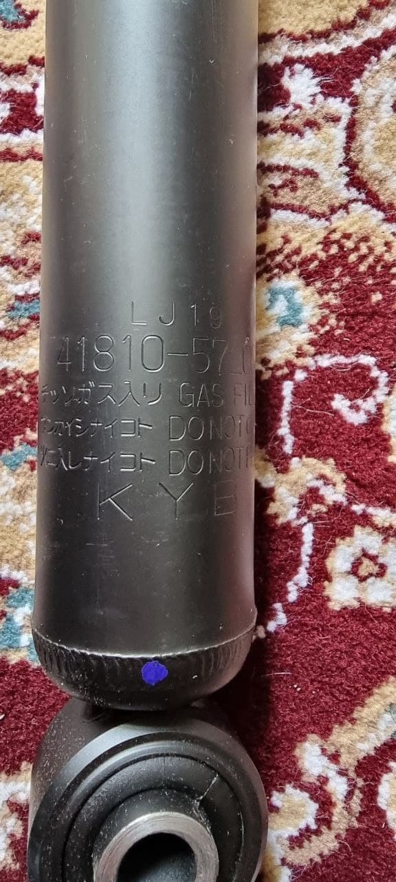

1- OE shock with part number = 41810-57L00 price around 111$
2- KYB aftermarket shock with part number = 349141 prices around 85$
I bought 1 set of OE shock but I saw OE on the car is also KYB but with Suzuki part number printed on it.

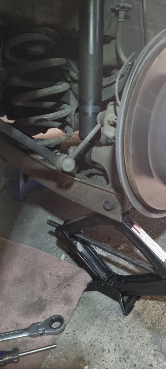

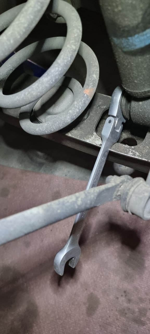

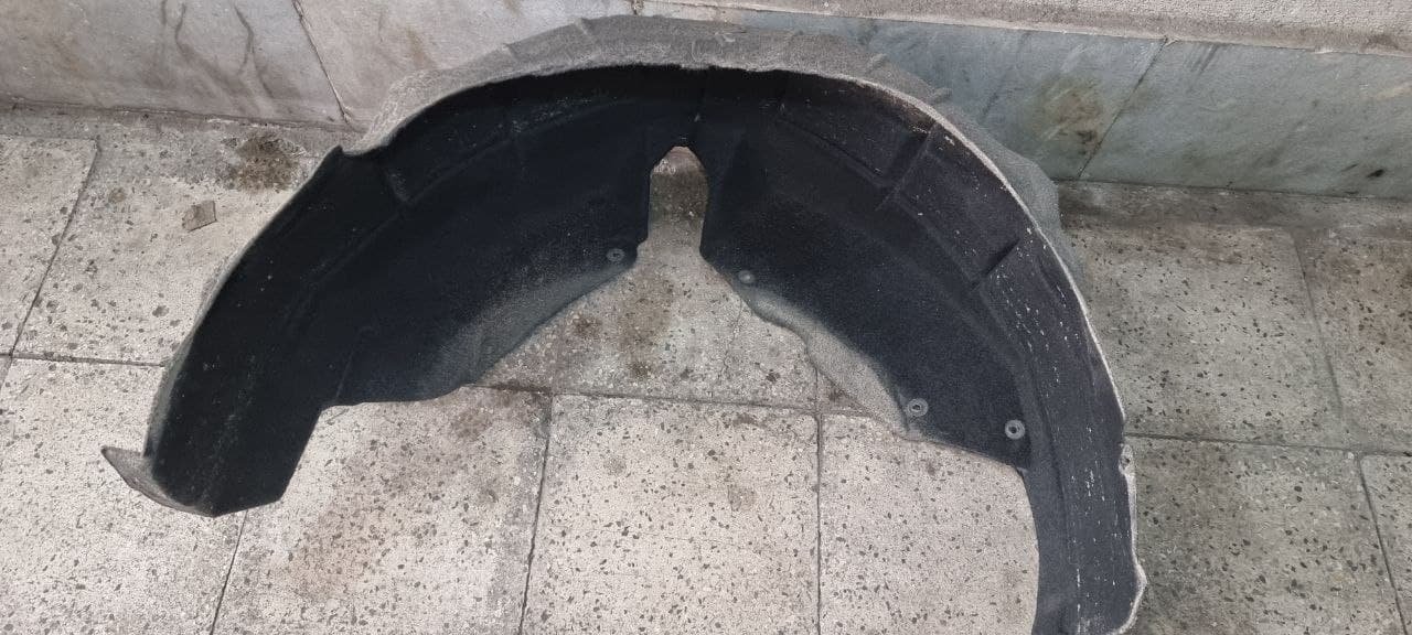

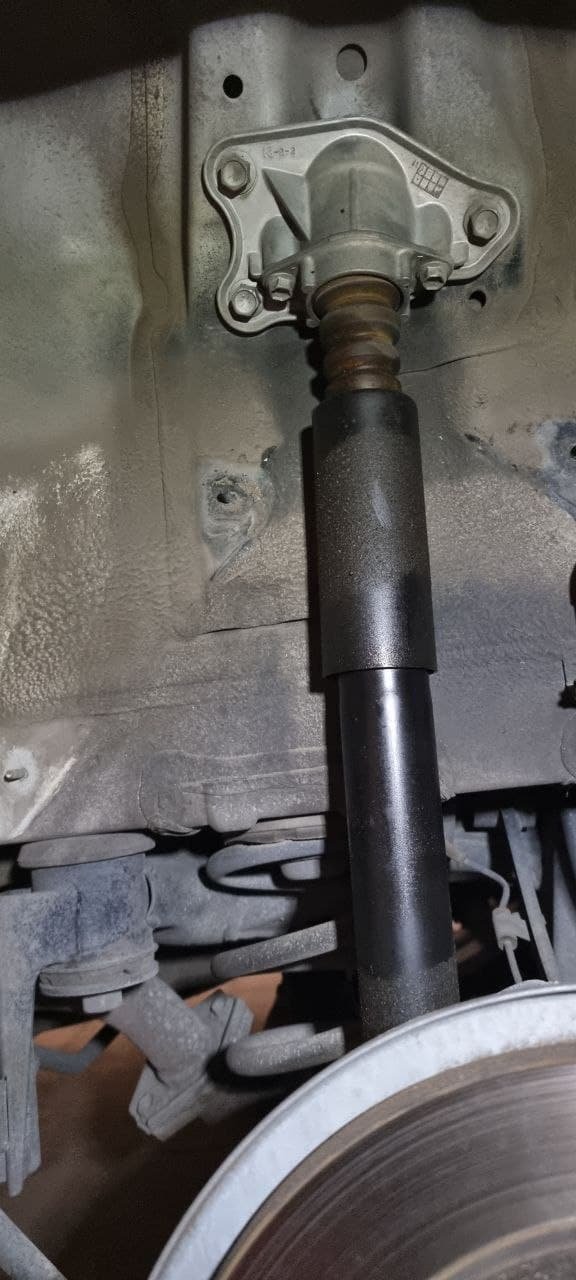

jack up the car and remove the rear right wheel and remove fender lining too. in order to remove the lower bolt I use a 19 mm ratchet wrench it helped a lot to speed up the process also I used another jack to push the lower control arm up in order to remove the bolt.

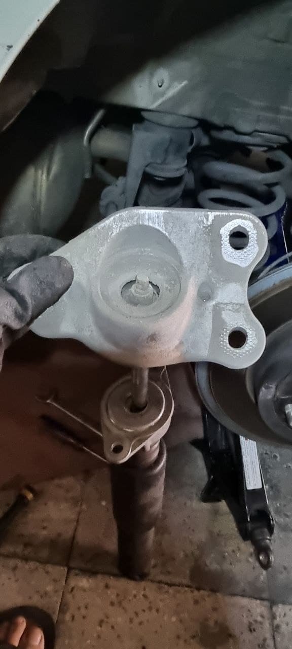

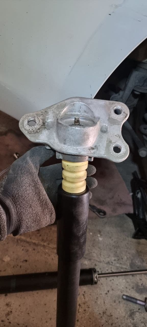

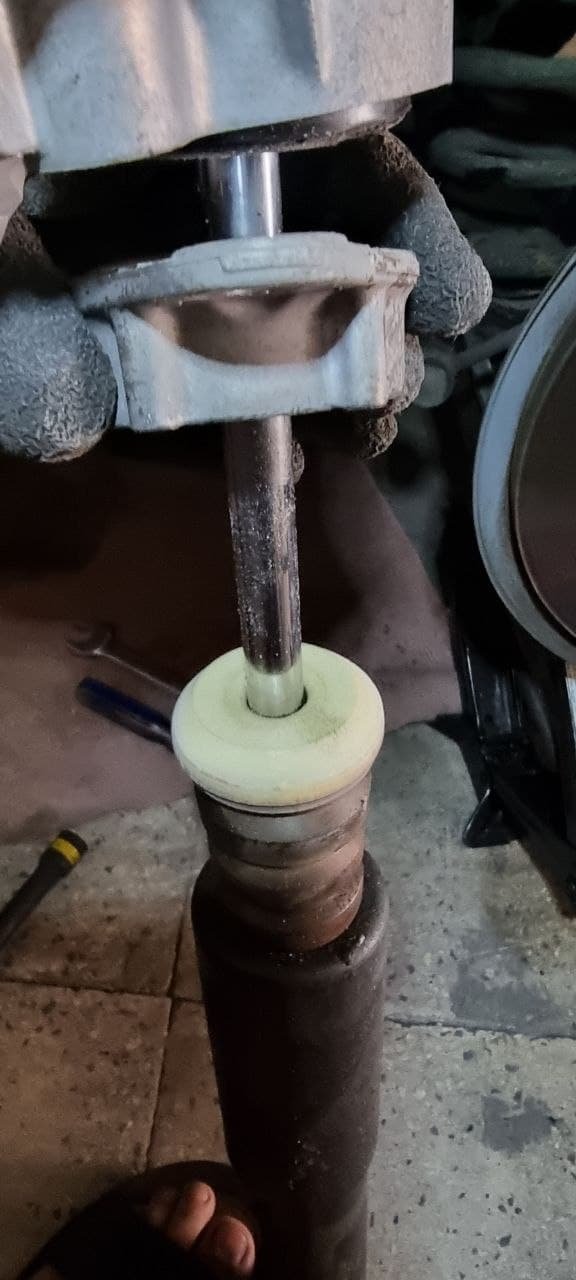

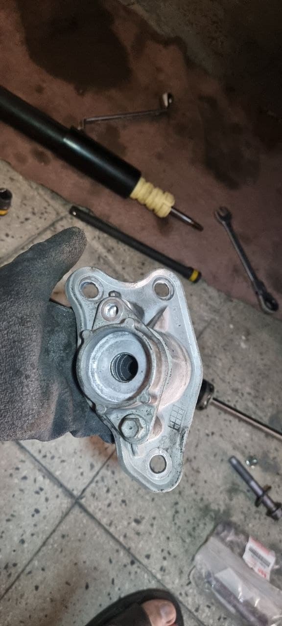

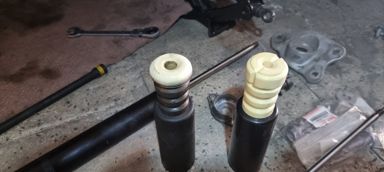

the go up and remove two 12mm bolts and also three 14mm bolts the remove old shock and inspect
and correct original shock does not have a special groove to guide water(Kizashi rear shock TSB ) so needs to be replaced with a new one maybe that was the root cause of this problem!

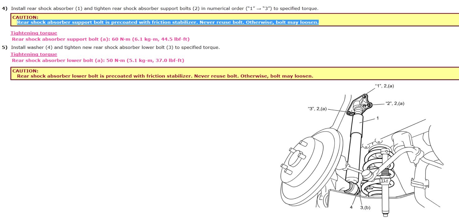

installing a new shock was easy but some notes from the service manual

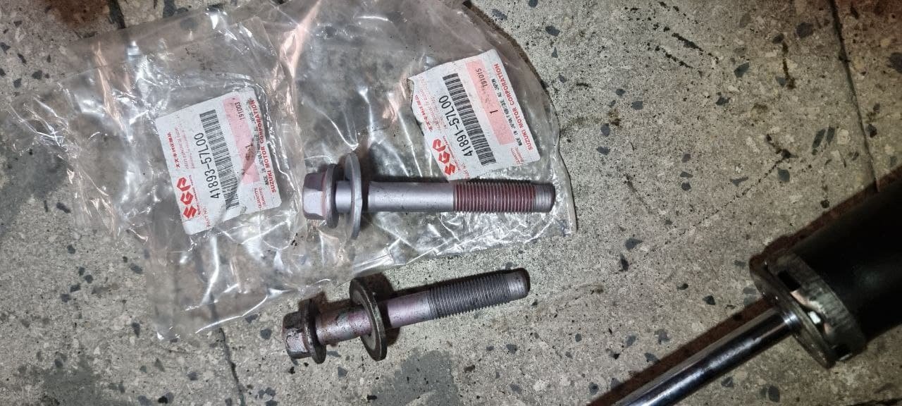

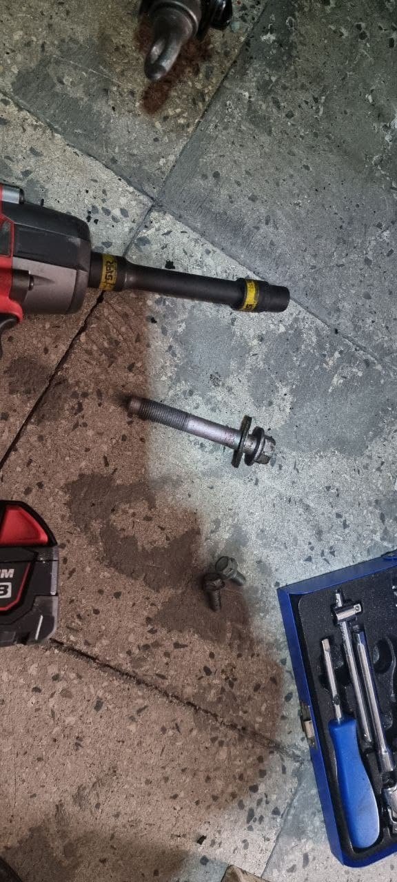

1- according to SM support bolt should be replaced and each service because of some kind of thread lock materials so I order bolts because of it but after seeing old bolts I think it can be reused with some red thread lock. anyway I replaced the bolt with a new one part number of bolt = 41891-57L00-000 and bolt washer = 41893-57L00-000

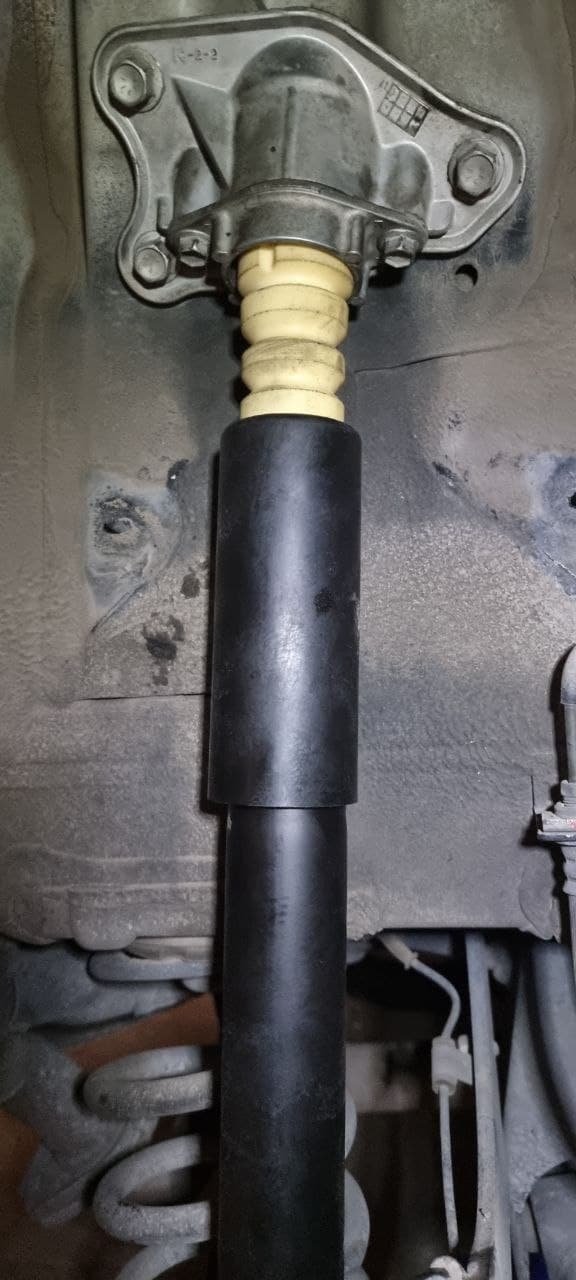

and here is the final installation of the RR shock absorber I think sooner or later left shock will also fail and need to be replaced like this one.
