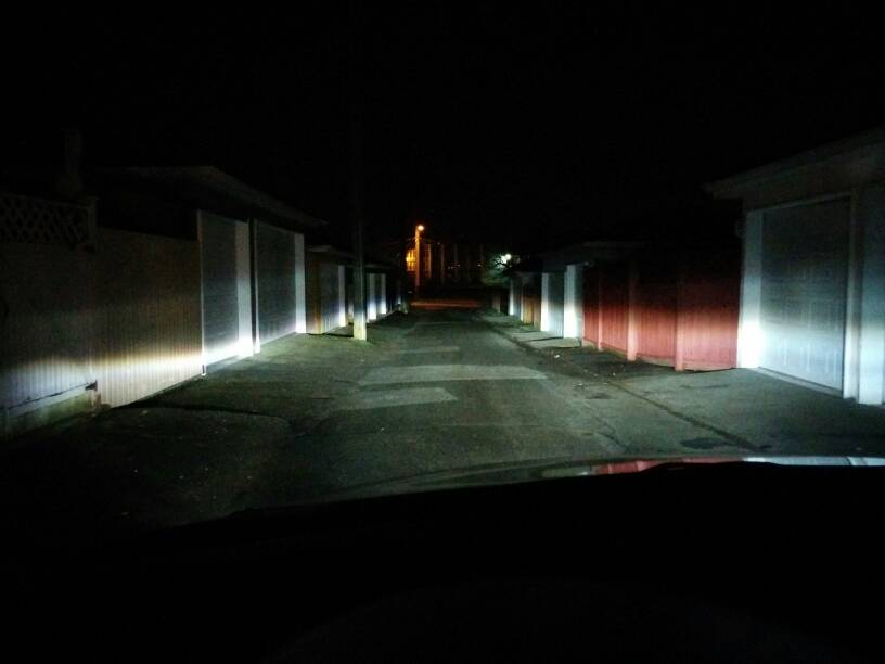

I'm not completely satisfied with the left side's output. The beam seems really narrow. I'm not sure if it's by design or due to the limitations of halogen projectors. I'll find an empty parking lot tonight and do some proper aiming.
I'm also looking at LEDs to replace the parking lights.
Trying to perfect the aim is an exercise in futility. It seems like the driver side beam is thinner by design, as no amount of adjusting rectified it. If someone has better results, please share!
Here's where I gave up. The light is more evenly spread out now
The beam patterns aren't symmetrical, so that might be part of the problem? The driver side beam is meant to be lower so it doesn't blind oncoming drivers.

Keep in mind that it may simply be due to the design of the projector lens and how compatible it is with the HID bulbs. As you can tell, HID bulbs and H7 bulbs are rather different in shape. The factory projectors in the headlights were designed for halogen H7s so their light throw is optimized for those. This is why retrofitting HID-specific projectors is a thing.
While different HID bulbs may get you better results, it will likely never match the quality of a HID bulb in a HID-specific projector.

I have a "dim spot" on the left near the front of the car, but NOTHING like that

I'm not too concerned about the dim spot now. I rather see further ahead and the fogs light up that area.
Still sucks that it's not a uniform pattern but that's the limitation of halogen projectors. Oh well
~tc~ wrote:I have a "dim spot" on the left near the front of the car, but NOTHING like that
Same. I think another person once mentioned it on the forum too. I think it's merely headlight/projector design and there is nothing short of a HID projector retrofit to remedy that. However, using better HID bulbs may make the issue better.

The dim spot is exaggerated in the above photo. I don't notice it while driving.
Achieving the perfect aim is a constant work in progress though; I think my prior set up was too high. If only I could do a "factory reset" on them :lol:
