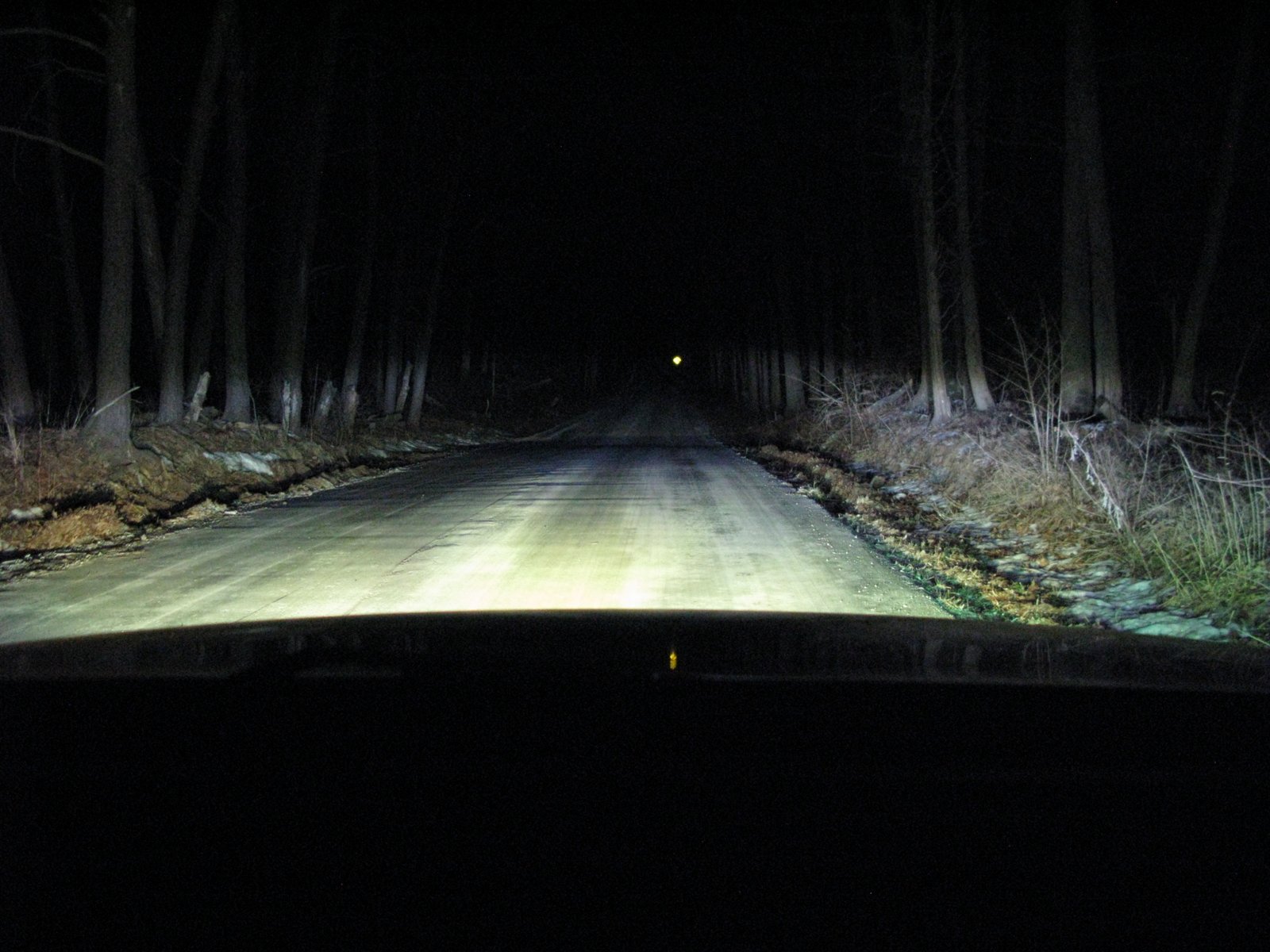

However, our Kizashis and many other cars have factory projector lenses. If you look at the headlight, the low beam is emitted through what looks like a glass globe in the headlight. That's the projector lens. These create a cut-off regardless of the bulb inside. This cut-off is clearly seen in my on-the-road photos here:
See how the light in the woods is cut off at the top and you can't see anything? There are trees there, but the cut-off is rather good and effective so you can't see them. When I used my fog lights or high beams, they are more visible:
The whole area was almost pitch black if my car's headlights were not on. The projectors did a good job of leaving that area free from light exposure.
This cut-off is what is needed to help keep the lights from blinding oncoming traffic. This cut-off is created by our Kizashi's low beam projectors.
