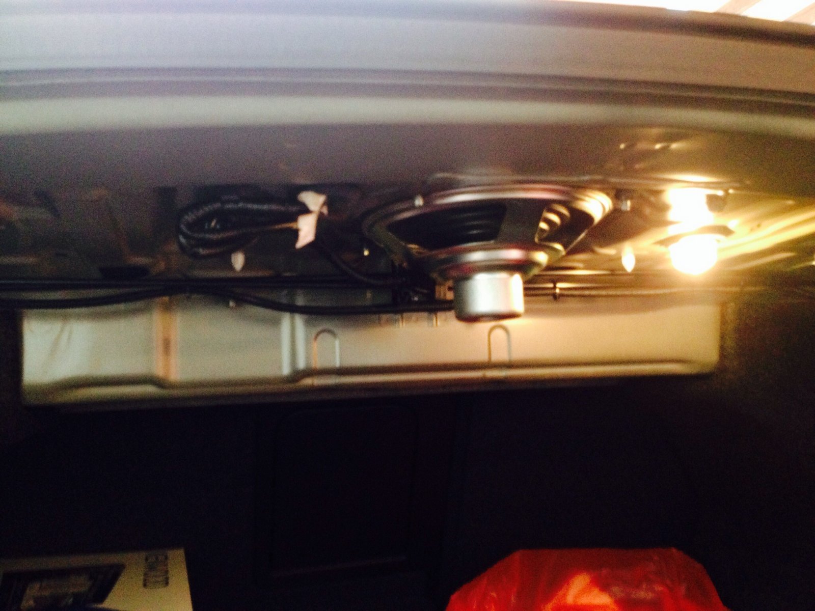

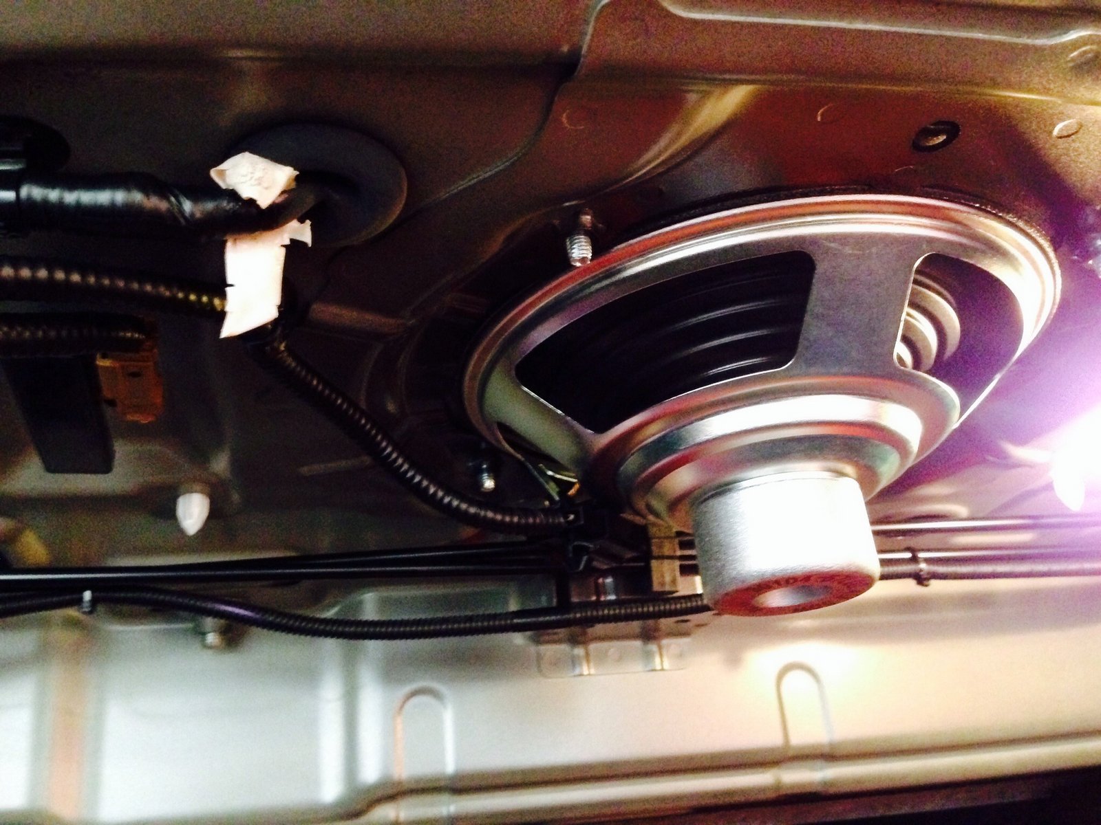

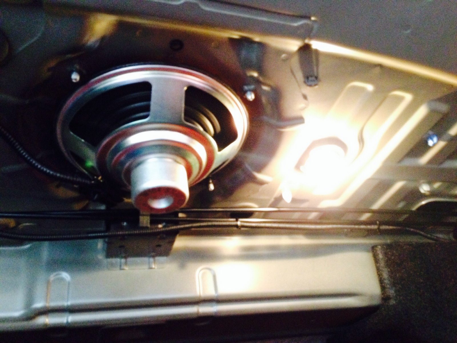

Please refer few photo shots of my sub. I believe like u said , the head unit is powering my subs.
Yes, that's definitely not the RF sub. You could get your subwoofer working again- you'd need an amplifier with speaker level inputs.
My Kizashi has the wiring in place (for the same sub you've got), but my stock head unit wasn't connected to the wires (they run to the rear of the head unit) and doesn't have the extra internal amplifier. They've kindly spot welded a metal plate over the sub hole at the factory too!
If you could find a small amplifier- that could be hidden in the dash near the head unit- it would be an easy fix. You shouldn't need much power from the amp.
Edit: there's a bit of info here on the wiring I found in my Kizashi and the sub woofer you appear to have: http://www.kizashiclub.com/forum/viewto ... =28&t=2149
