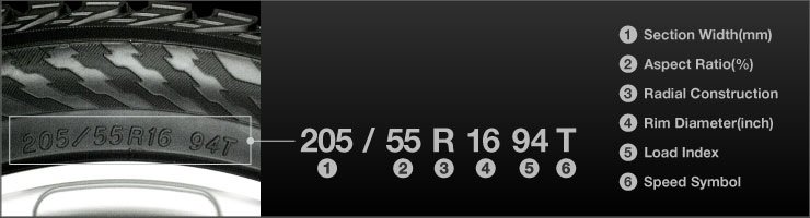

it could be there is a difference in the load index of Yokohama and Goodyear tires. you mentioned your car is CNG so it put much more weight on the rear suspension.
you can check the load index of tires this way

SAEED_KIZZY wrote: Mon Jul 25, 2022 7:25 pmit could be there is a difference in the load index of Yokohama and Goodyear tires.
Another very good point because if the tires are overloaded, then they will wear differently than designed.

The extra weight that I'm carrying is 75 Kgs max. That's the weight of an average adult. I highly doubt the added weight is causing this problem. Also 95% of the time, no one is sitting in the rear when I'm driving.

Yeah, the CNG tank isn't much weight at all. I didn't think that was the issue.
