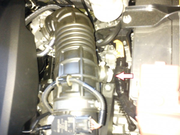

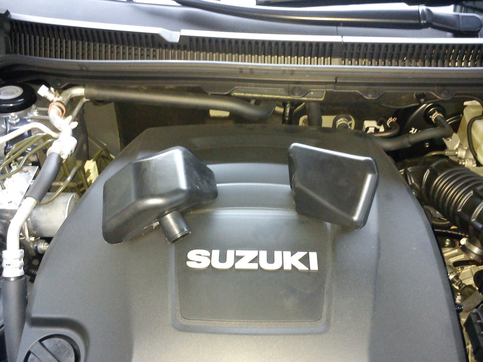

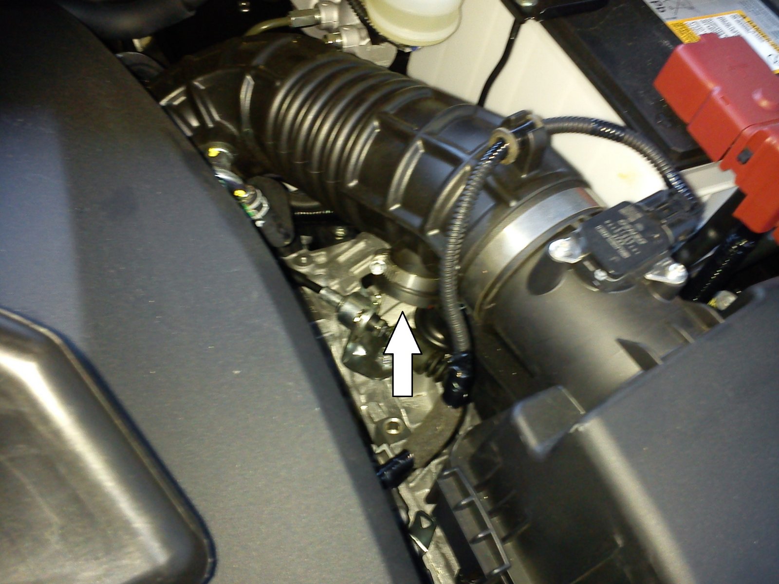

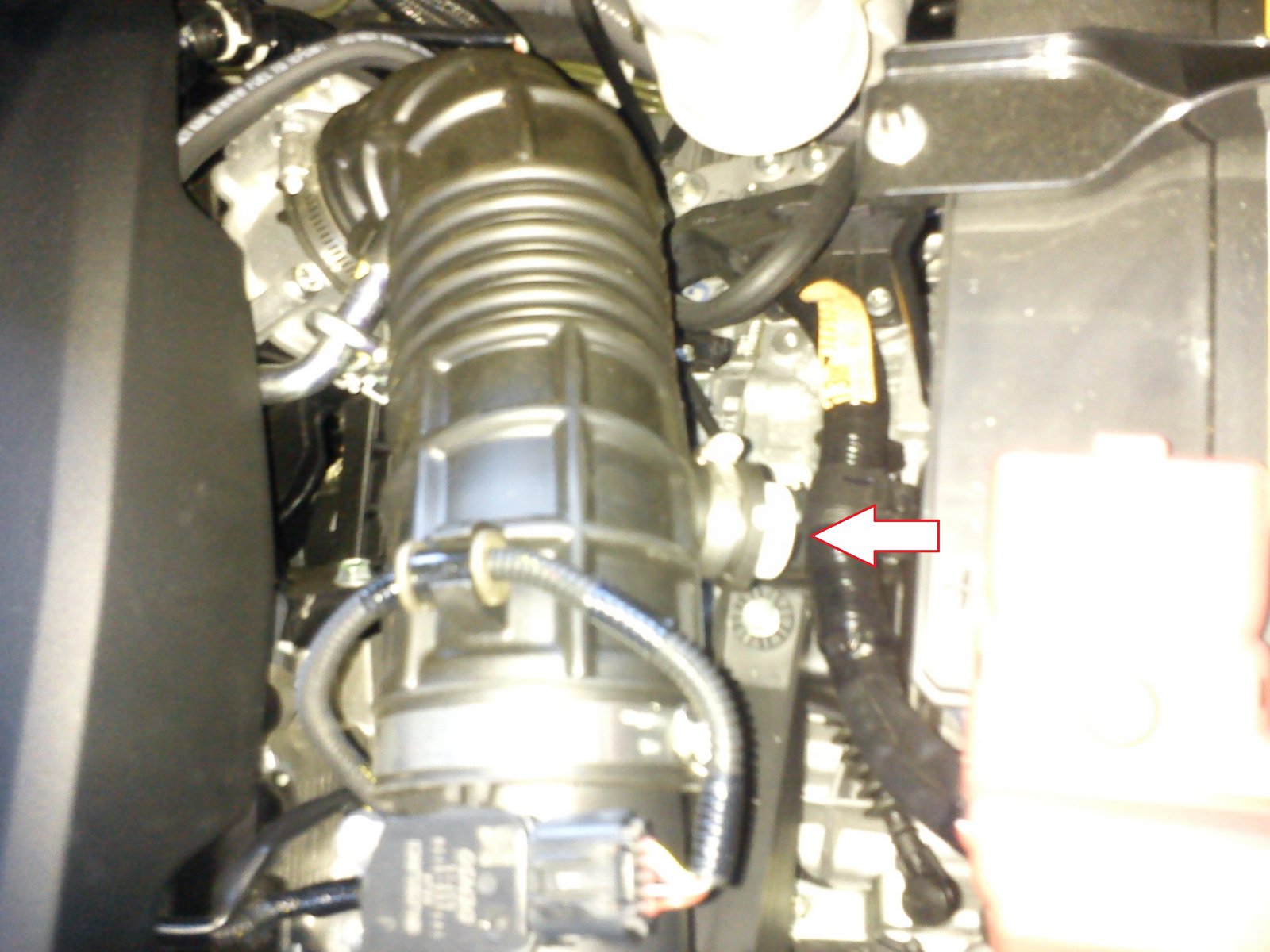

I just finished removing what could only be the baffles from my 2012 Kizzy.They are really easy to remove.They are located between the air cleaner box and MAF sensor.First,I loosened the two clamps holding the "boxes" in place.Than I unsnapped the two clips holding the air cleaner lid down,pivoted it up and pulled the "boxes" off.Than I found two plastic lids from some soda bottles that would fit snuggly in the holes and used the factory clamps to hold them in place.I took a test drive afterwords and could tell a slight difference in sound especially at low speed and idle.I'll post some pics later.

Here are the pics
this is what your after.
