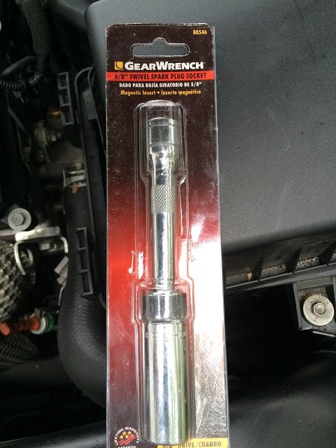

- 5/8" Spark Plug socket (I recommend one with a magnetic tip).

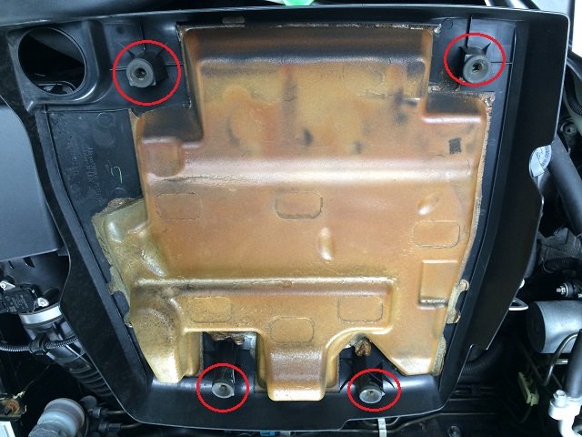

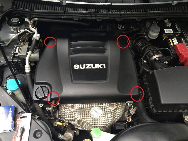

You want to make sure your car is shut off and cooled down. You'll first want to remove the plastic cover to get to the coils. Simply grab each corner of the plastic piece and pop it up. I've circled the areas below where you should do this.
Here are the four points from underneath, so that you get an idea.

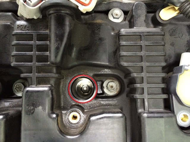

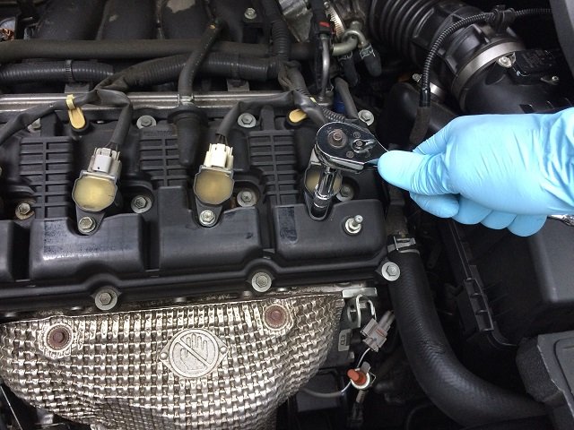

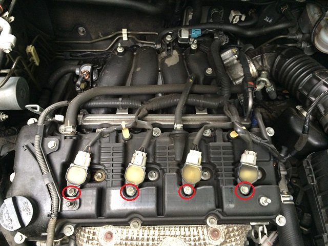

Remove the 4 screws on the coil packs by using a 10mm socket wrench.

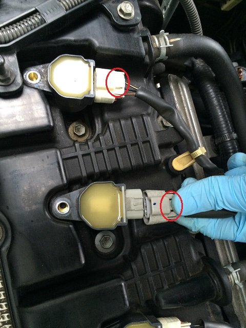

CAREFULLY remove the plugs from the coil packs by pressing the tab on top and gently pulling it outward. Be sure to only grab it by the plastic piece and NOT the wires, as they are VERY delicate.

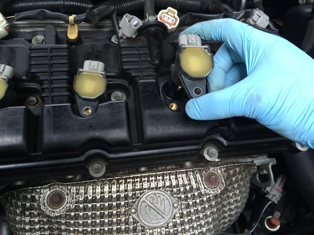

Remove the coil pack as shown. Feel free to wiggle it back and forth while pulling it up to get it out.

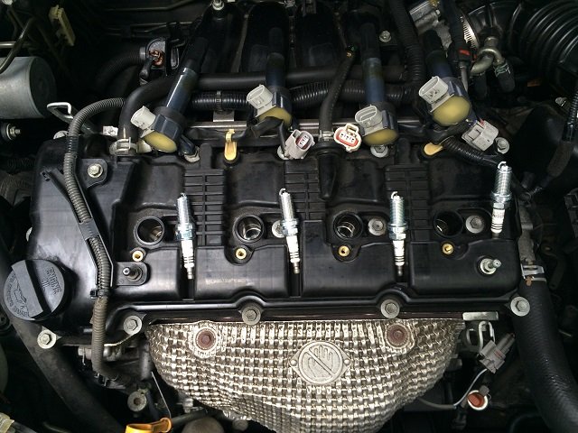

If you look where you just removed the coil pack, you will see the spark plug. Use the 5/8" spark plug socket to get it out. It may take a bit of effort to get it out at first due to minor rusting, but when we put the new one back in, we will use anti-sieze on the threads to prevent it from rusting for future spark plug changes.

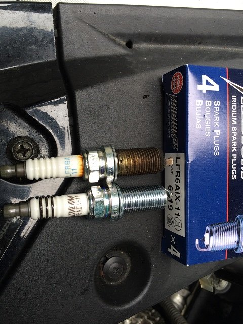

I usually take all four out at once, lay them down as shown and add the anti-sieze paste on the threads on all four at once. Then, I clean my hands from any paste and then I pop them all in. You don't want to get any past on the tip if you can help it.
Thread them in BY HAND to make sure they are threaded properly. Tighten them with a torque wrench set to 18.5 lbs.

Great write-up, however the use of anti-seize is not necessary these days. The reason why is because of the coating on the threads of most modern spark plugs. It was something I too didn't know about until recently, but even spark plug manufacturers themselves state that anti-seize is no longer needed on many spark plugs. It goes to explain why there's no residue of it from factory-installed plugs in many cars.
While I have long used anti-seize myself, I am discontinuing the practice given the advances in spark plug materials. The kinds of spark plugs I commonly use (like the Iridium IX's you installed) don't require anti-seize.
Also, anti-seize can alter the application of proper torque when used on plugs that don't need it.
Here's some info on the topic from NGK themselves:
http://www.ngksparkplugs.com/pdf/dyk_5points.pdf
Thanks for posting! How many miles are on your original plugs?
Just want to emphasize that if you use anti seize, make sure you decrease your torque values by 20-25% (as mentioned by KuroNekko)

I'm curious how you made that socket work. I ordered one a couple weeks ago that seems like it was exactly the same one and the black ring around the top was too thick to fit into the hole.
