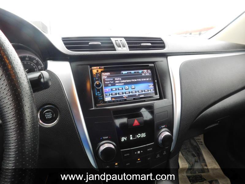

Ok, so I got the car today. I'll check other threads for other little issues.
Back on topic. I found a solution that I'm happy with... so far. I don't receive phone calls that much, so I'm not sure if that'll pose an issue, but for $10, my solution is working great...
I ran into Ollie's today to grab a few things, and I remembered they sell a Craig Bluetooth adapter that connects to the older Apple 30-pin connector, which this has in the glovebox. I got one, tried it, and it's doing the job. For $10, I'll take it.
So, moral of the story: for those of us with the Kenwood Nav units, there's a $10 solution to have Bluetooth streaming.
Oh, @n8dogg mine looks just like yours.
