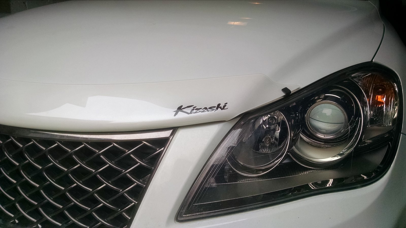

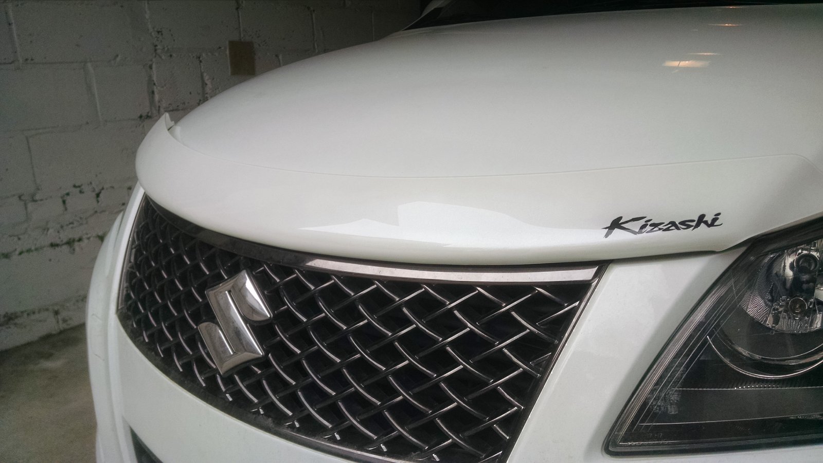

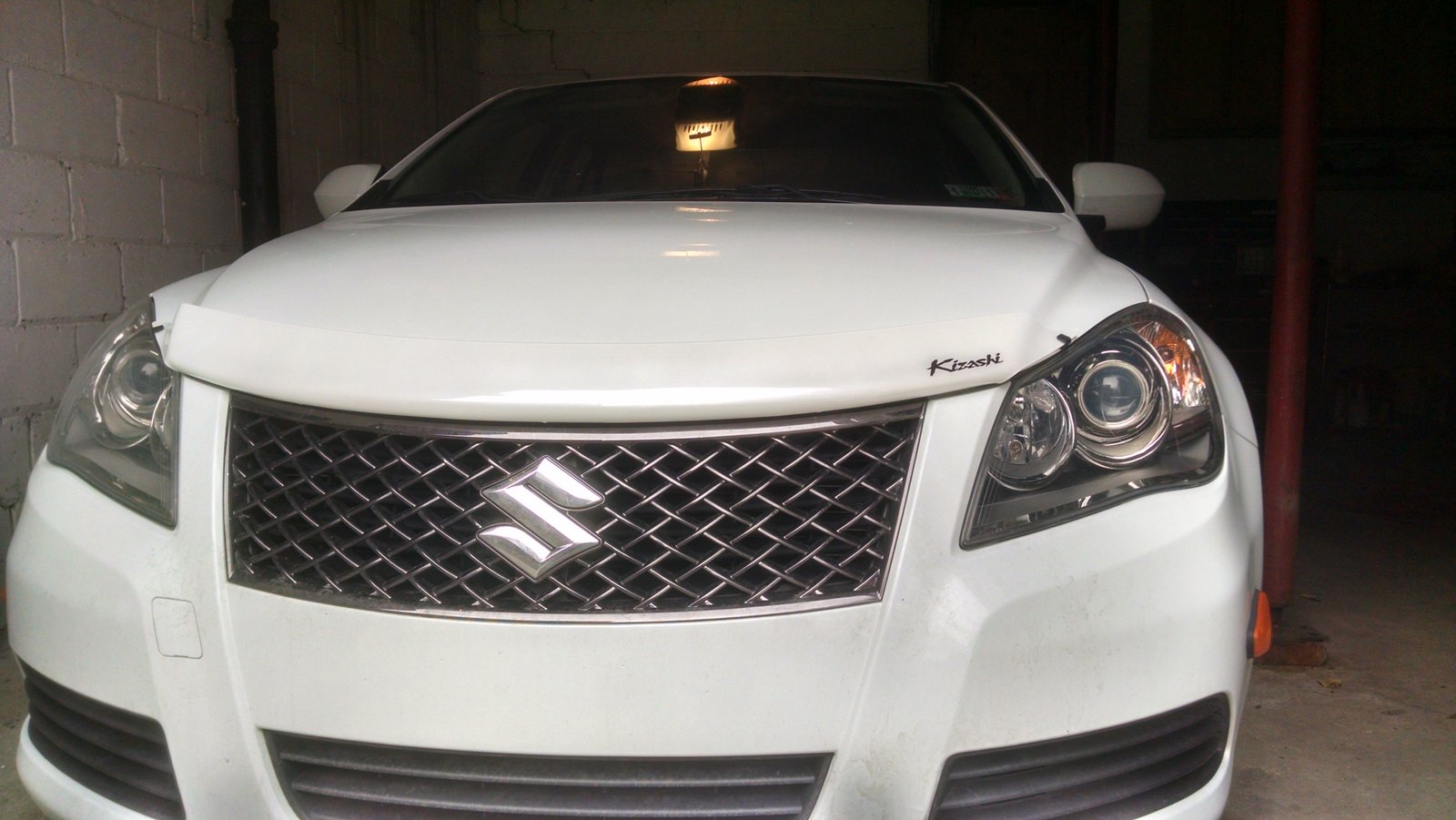

Took a chance on a Duplicolor pearl paint that turned out pretty good. Color is slightly off but overall very happy.
Clear deflector (990AA-00320-001)
was shipped from Australia via an eBay company that sourced it for me:
4wd_partshop
I sent them a message and they were able to get the part from a Suzuki dealer. You may be able to as well if interested.
Duplicolor Perfect Match BHY1805 Powder White Pearl (W1)
Steps were simple - mask off the front of the deflector and spray 2 or 3 coats of Duplicolor on the back.
