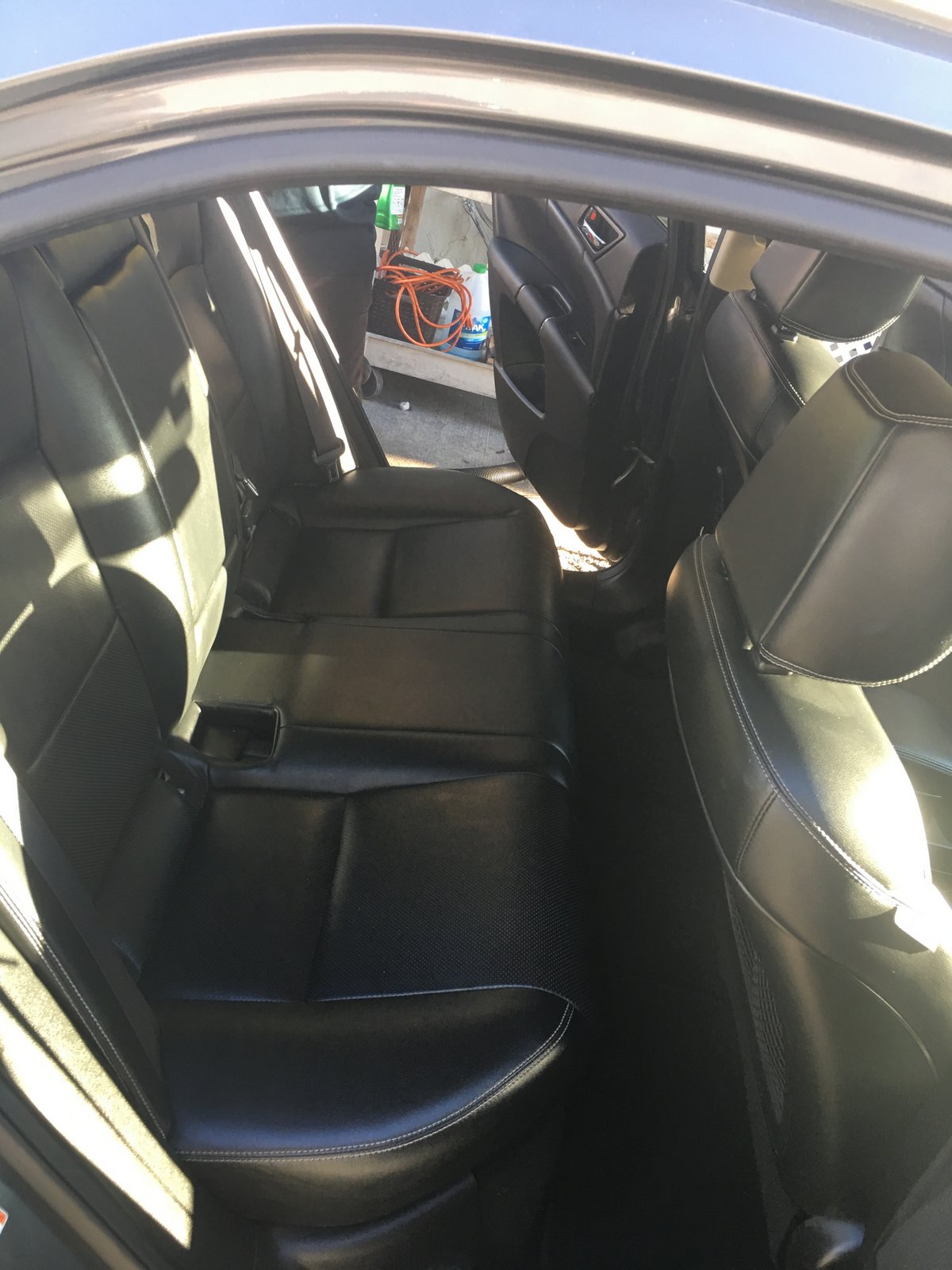

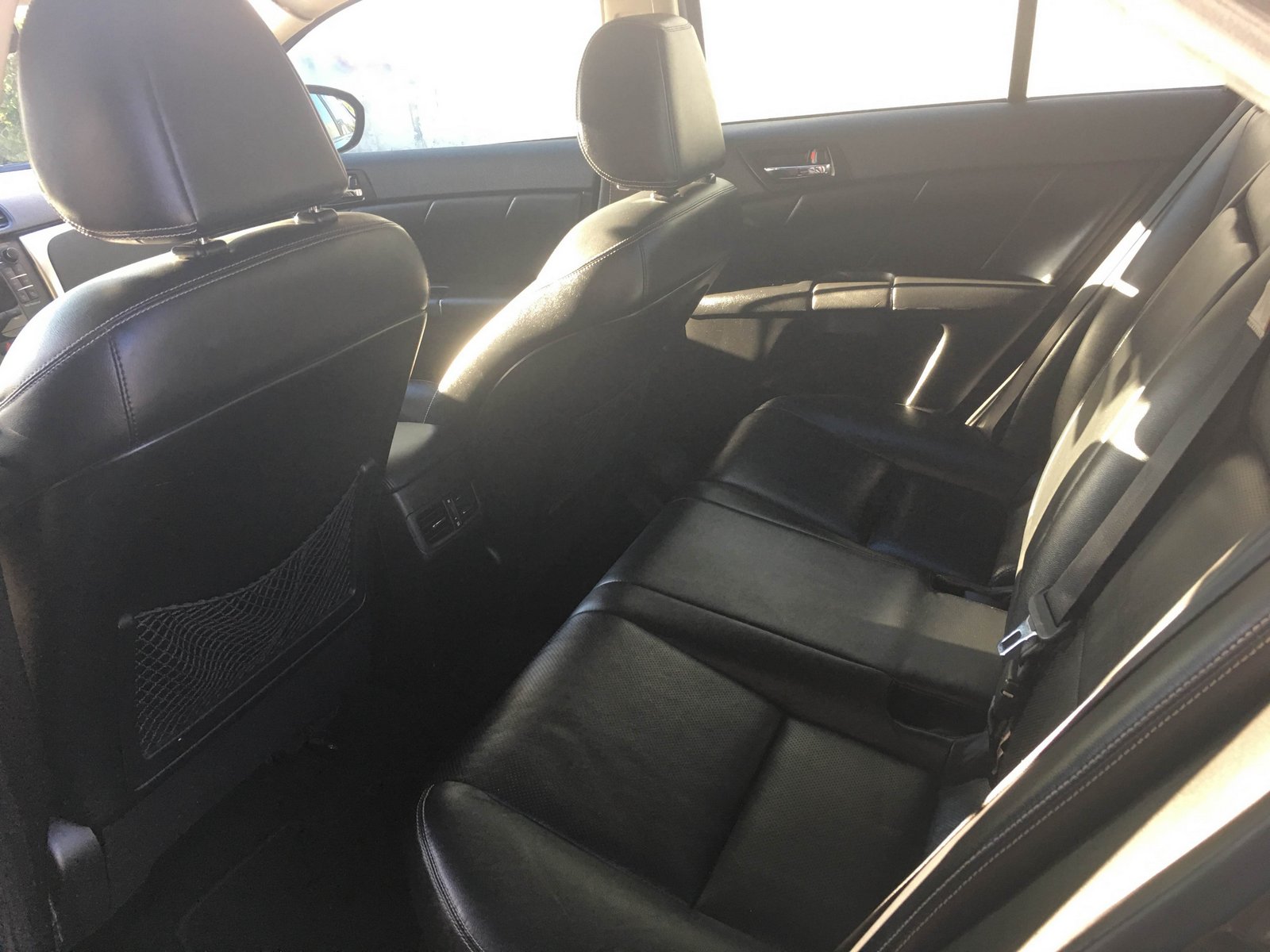

Soooo, fast forward to now and, on a whim, I started browsing the interwebs for OEM Kizashi parts, including leather seats and found a whole set of front and rear black leather seats from a 2011 SLS in pretty decent condition for $545.00 on Ebay from a used parts dealer called LKQ (http://stores.ebay.com/LKQonline).
Apparently a tree fell on donor car so the airbags have never blown. Almost all the other seats I've seen on used part sites have blown airbags, so these seemed like something I should probably jump on immediately. Once I clicked "Buy It Now" I realized I had just committed myself to my first major project on this car: a GTS to SLS manual conversion.

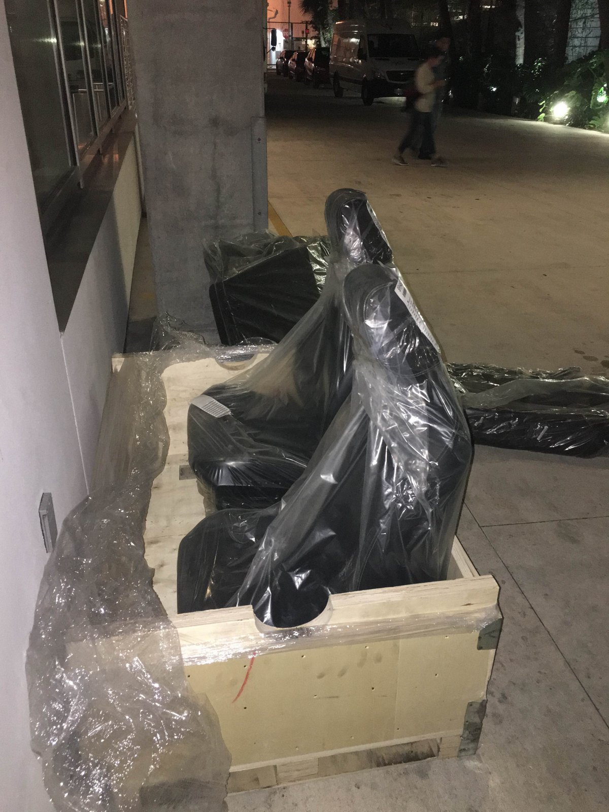

Any suggestions on the best way to accomplish any of these interior mods will be greatly appreciated as this project moves forward. The leather seats should be here next week, so I will start posting up pictures and video when they do.
