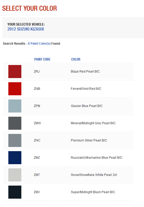

So one of the projects I need to do this summer is fix the crack in the front bumper on Kitsune (my red 2012 SLS). First thing I wanted to do was find the paint code for my car. I don't have a picture of it at this time, but I found it at the bottom of the black sticker on the passenger side B pillar. I wanted to highlight this because when I searched the forums for the paint code locations, I couldn't find a definitive post anywhere that pointed this out.
Turned out Kitsune's paint code is "ZNB" (I found out later this is the code for "Vivid/Fervent Red" I believe these were the names for this shade of Suzuki red from 2010-2012 and 2013 respectively).
Next step was to find out how to get a hold of some paint that matched this code. Fun facts, the Dupli-Color spray paints that you can find at your local Walmart/auto parts store ISN'T going to have this color, and even Dupli-Color's website says they can't find this code in their system.
I was able to find a nifty little site called expresspaint.com. On there, they have a nifty little vehicle picker that you can use to find ALL of the paint codes for our vehicles. The screenshot below doubles as a link to the site. ;)
[/url]
The site has a thorough FAQ about how to spray paint your car, and how much you SHOULD need to get a particular job done. I suggest checking it out. This site provides a variety of sizes from touch-up pens for scratches to whole quarts for anyone out their with their own spray paint gun.
A can of aerosol spray paint for JUST the ZNB color was about $25 USD. Note that this DOES NOT include primer OR clear coat, which you can also get through their site.
Heads up for you Kizashi owners like me that have a Snow White Pearl (Paint Code: ZMT) Kizashi: Aerosol cans of paint for this color is going to be closer to $50 USD because like most automotive white paint coats, Snow White Pearl is a "tricoat" color with a base color, and then a "mid-color" that goes on top of that.
