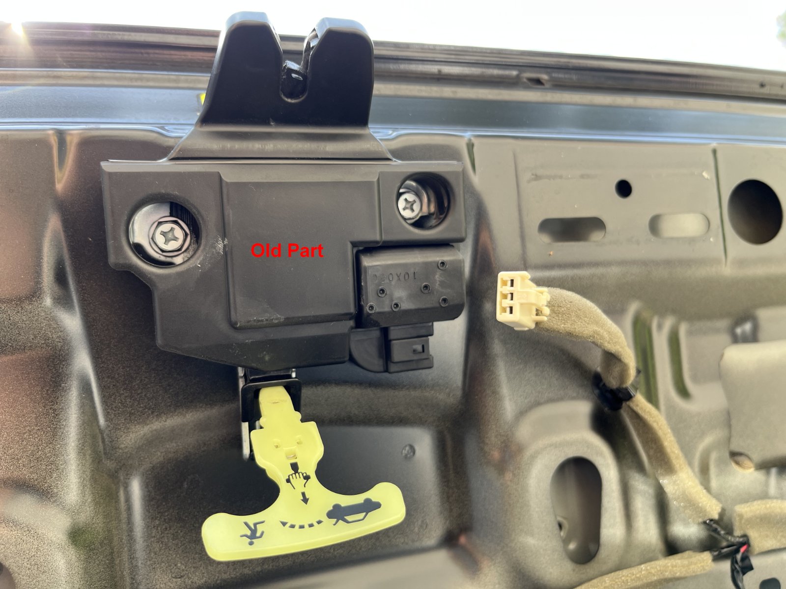

Recently, my trunk latch failed. I had the trunk open at the time and recall that I might have unintentionally locked the car doors while the trunk was open. While that normally does not affect the latch, it appeared to fail to work properly since then. After failing to latch properly after three locks and openings, it was evident I needed to replace the latch.

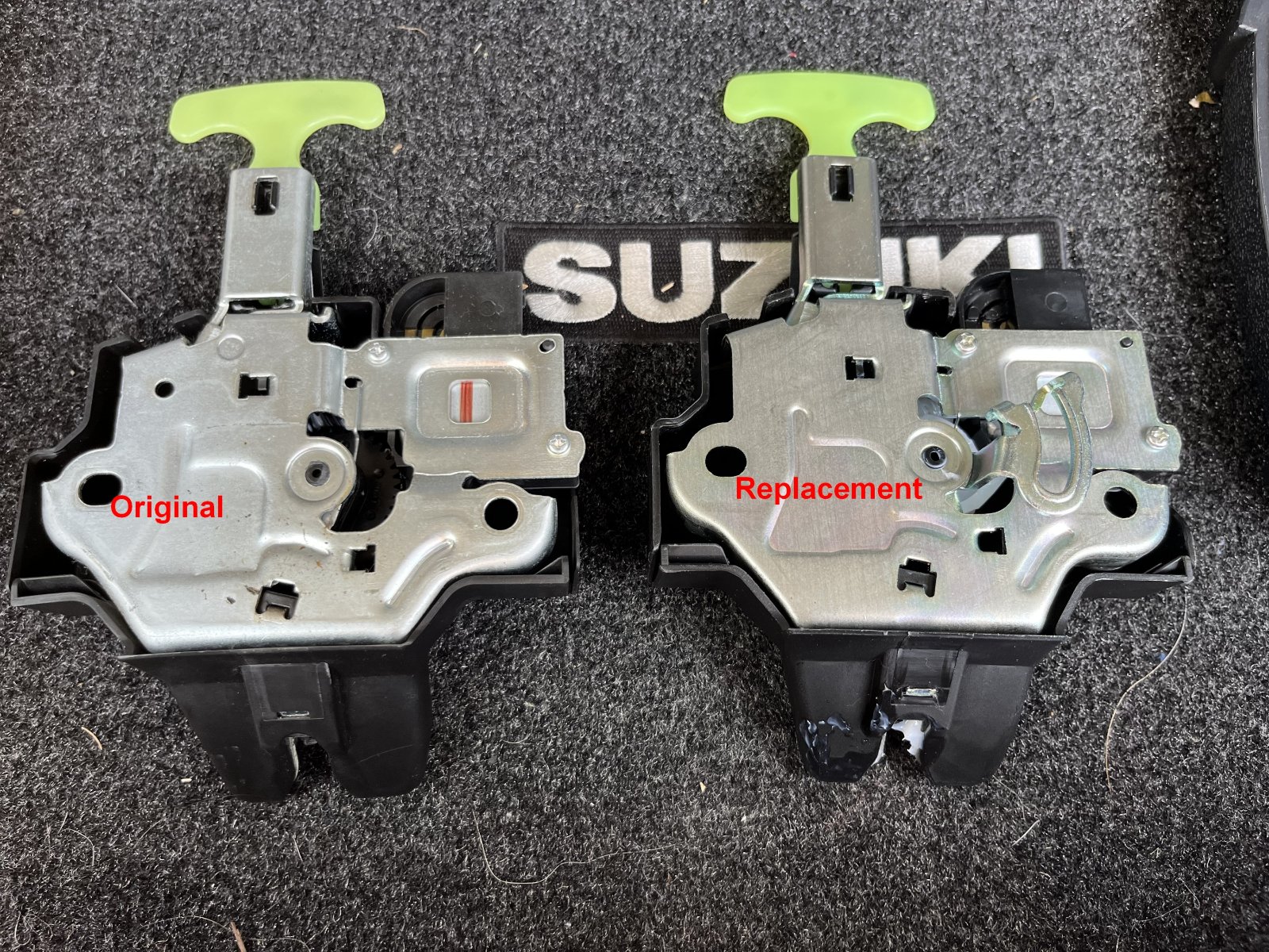

A search here revealed a claim years ago that the Kizashi used the same latch as a Toyota Yaris of a similar model year. My searches revealed the more popular Toyota Camry also used the same latch hence I opted to obtain a 2011 Toyota Camry trunk latch. Photos of it online looked very similar in design so I figured to take the chance, especially as most aftermarket latches on Amazon were in the $20 range. The specific one I purchased is:

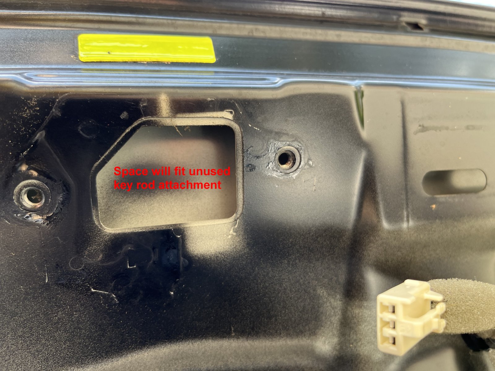

When it arrived, the part appeared identical except the backside had a mechanism for a key rod that the Kizashi's did not. I did not realize the difference beforehand because I didn't remove the Kizashi's latch until I had the new one, however, we all know the Kizashi doesn't have a trunk keyhole thus a key rod. Thankfully, the Kizashi's trunk design incorporates a cutout space specifically to accommodate a latch with a rod attachment though the Kizashi doesn't use it. Thanks to this, the Toyota Camry's latch fits perfectly.
The new $20 Amazon latch works perfectly and in fact, better than the original part ever did. It seems to release the lock more effectively.
The replacement was very easy. First, you remove the trunk's upper trim liner by popping off the trim retaining clips. Upon doing that, remove the harness connector for the trunk latch before removing the two 10mm bolts that hold the latch onto the trunk. Installation is reverse. Super easy.
