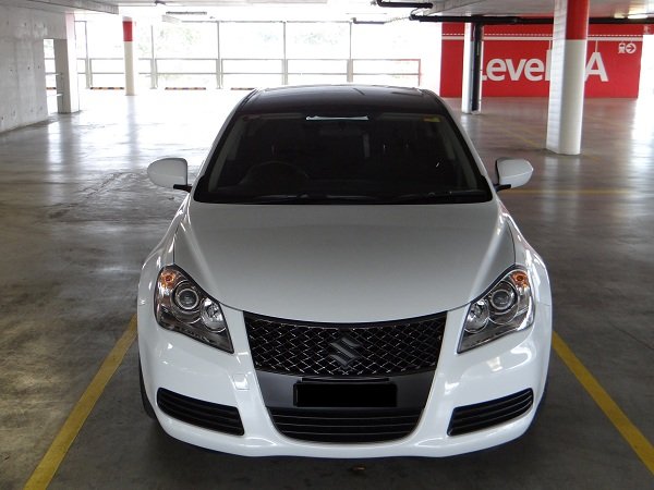

Is it really that difficult for some of these badges to be removed?Image
Just rocking a plastic spatula from side to side "walked" my badges off pretty effortlessly, left no marring, and the adhesive rolled off under fingertip pressure.
Did you remove the rear S??
The rear S is easy to get off. No holes or anything underneath, only double sided tape.

Thanks for tips. I'd like to remove the "S" from the back of my 2012 Kizzy, but I'm a bit scared to try it. And, maybe cloor the front "S" like this guy did. My car is Azzure Gray. Douglas. St. Louis Park, MN
