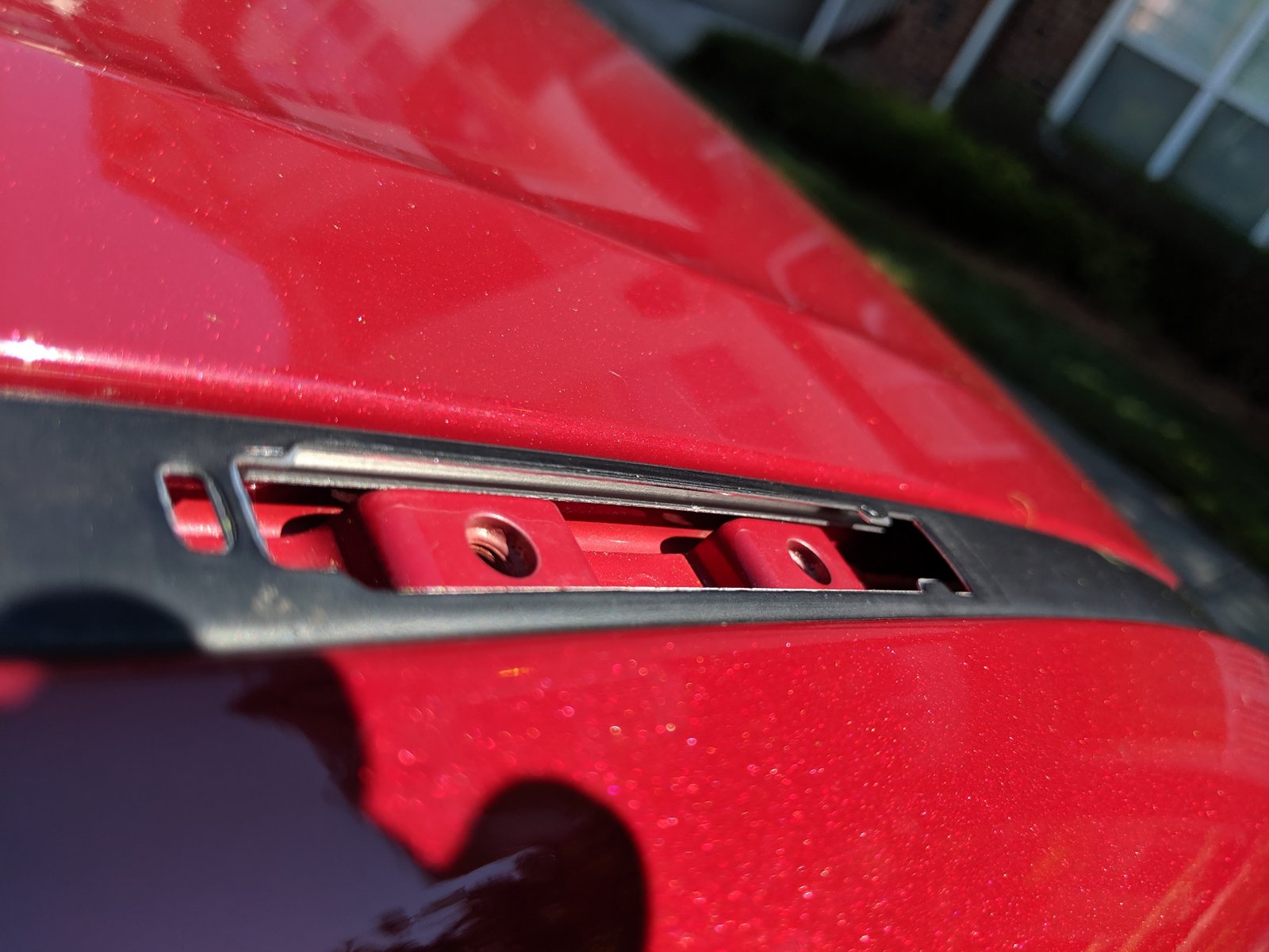

  2. What kind of rack works with these rack holes in the roof? I kind of want a Lockrack. Meaning I need a rack that fits to both the car and the Lockrack. Currently finding it difficult to ensure with confidence that something works on both ends.

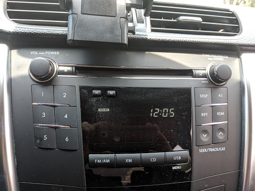

  3. What can I do with this car stereo? It has buttons for XM and USB, though they seem to do nothing. That's probably because I don't have the features... right? Just asking because I've completely failed to locate basic things in this car that turned out to exist, so I never know. Are the features behind those two buttons still doable by ordinary shops?

2. Member KurroNekko is sort of the expert in roof racks here, he'll probably chime in in the next day or two. I'm pretty sure the Suzuki brand bars that fit those mounts are actually made by Yakima.
3. What can I do with "this car stereo" is kinda abstract, as we don't know what THIS means. There were three different ones possible from the factory and there's a fair chance that the stereo has been changed to aftermarket on a six year old car. Does the head unit say Rockford Fosgate on it? Do you have navigation built in? XM was a very expensive option that made no sense at all, something like $300 for the add on module that enabled XM. You can get an XM receiver for $50 or get it over your phone and bluetooth it into your stereo. USB port should be behind the flip up door below the heat A/C controls where the dashboard meets the floor console.

Whisper Bars are the ones that attach directly to the roof's mounting in your picture. There's a few on here who've added them and I'm sure will jump in w/ more info. You're lucky, the threads are in good shape. The standard op procedure is to chase the threads w/ appropriate size tap and then use anti-sieze on the screws before installing to prevent corrosion.

I will post more info about the car stereo when I get a chance. I'm guessing the alleged USB port would be this deep hole to the left of the lighter socket.

I just installed a Thule roof rack on my car using their Aeroblade crossbars. They have the slot in the topside that should allow your Lockrack accessories to attach. The fit kits however, are listed as discontinued on most sites, as this was a low production vehicle and not many aftermarket accessories at we ever even made. I had to email Thule customer support to get the appropriate fit kit number and then search the web for anyone who still carried them.

Based on another thread I thought I might find a 2nd USB port in the glove box. I see what might be another gaping hole where a cable could have gone through. So cracking the thing open might be a good idea for later. But more importantly... I now have an owner's manual. It fits camouflaged into the top of the glove box all snug like it's a disk drive. When I asked the guy during the test drive to check the glove box to see if we had a manual to work with -- because neither of us could figure out the emergency brake or how to open the gas cover or the hood -- he said "nope". So I believed that.
This manual may answer more of my questions as I look through it. For instance my car seems to lack the clues that would indicate Bluetooth functions. But it does seem to imply that all cars have USB... that doesn't say "if equipped".
And, it doesn't say Rockford Fosgate either. It looks like the standard option to me.

It appears that you have the base stereo, that should have USB for a thumb drive or I-pod, but no Bluetooth or Rockford-Fosgate amplifier.

Woodie wrote: 2. Member KurroNekko is sort of the expert in roof racks here, he'll probably chime in in the next day or two. I'm pretty sure the Suzuki brand bars that fit those mounts are actually made by Yakima.
Sorry for the late input.
I have the Suzuki accessory roof racks but they are simply Suzuki-branded Yakima Whispbar Flush Bars. I've had mine for several years and would recommend them. They have been excellent with my bike carrier and Thule roof box.
