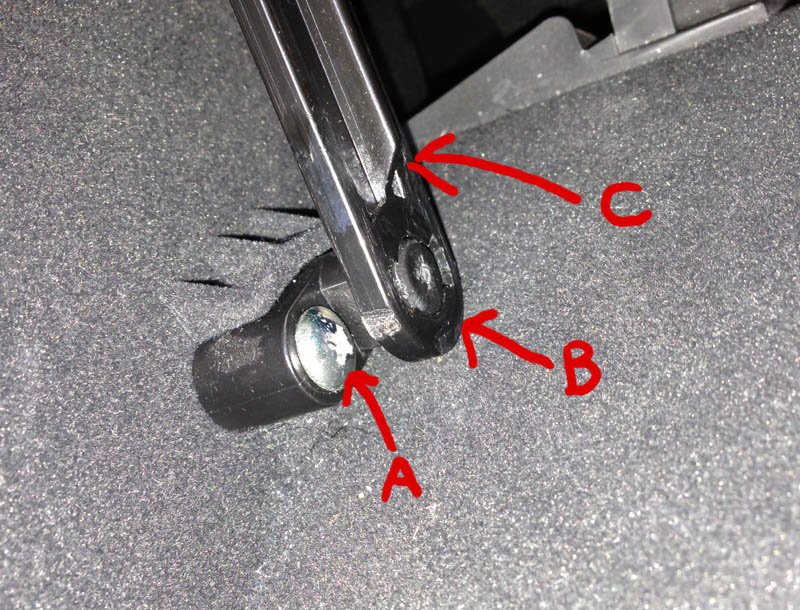

Not sure if this thread is still looked at, but I have a quick question.
Attached is a photo of the side of my 2011 glove compartment.
'C' is a dampener arm that attaches to the main box.
My question is, can I pull off 'B' with a bit of force, or do I need to unscrew 'A' from the box? Is there some way of removing this arm without unscrewing 'A'?
From memory you don't need any tools to remove the glovebox, but I can't remember if it pulls off there?

s'ok, I just wanted to remove the glove box to see how hard it might be to look inside the vents. It's a bit harder than I thought, and I would have to take off more than the glove box to give myself access to the inside of the vents.
I put the glove box back on and yep, replacing the filter is quite easy with the glove box still on!
