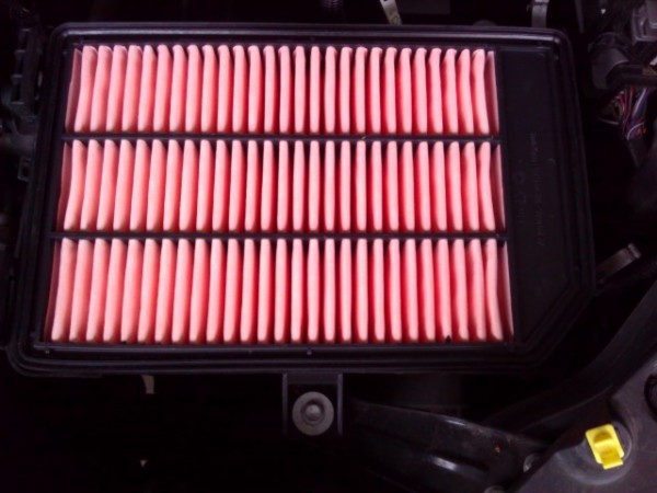

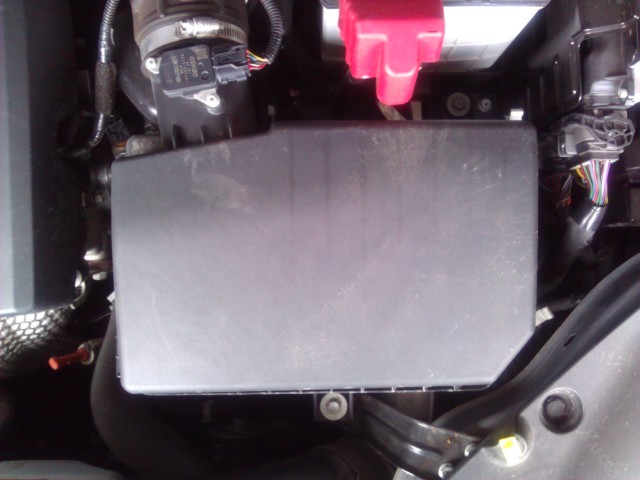

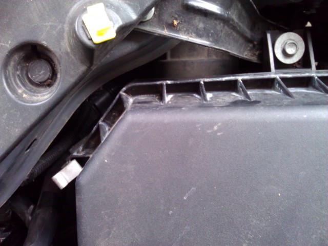

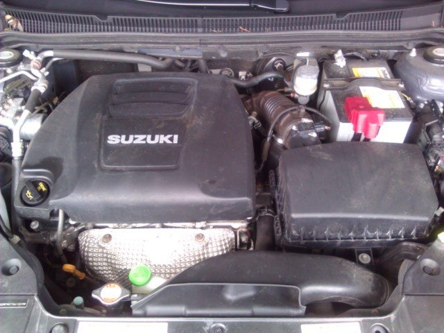

Open the hood of your Kizashi. The Air Filter Box is located in front of the driver by the clip that holds the hood mounting rod.

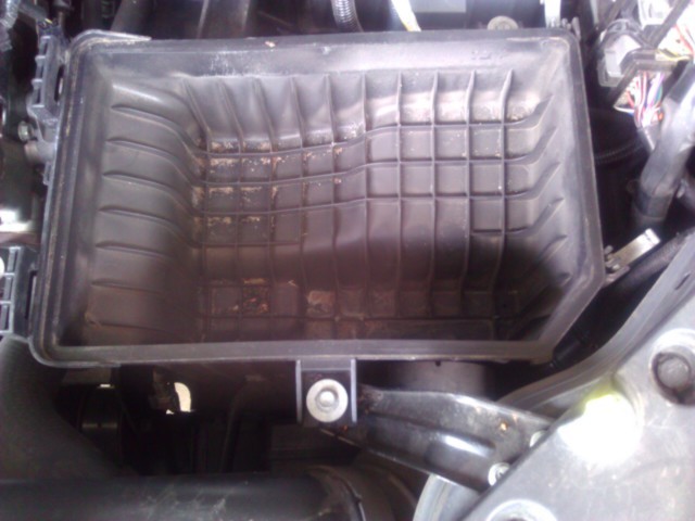

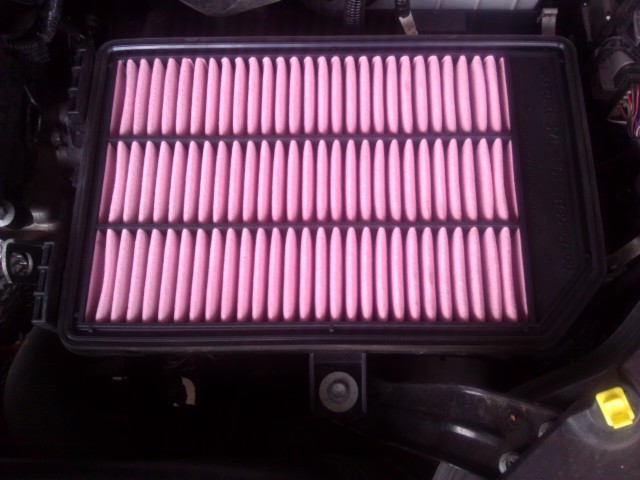

How to Change: Air Filter

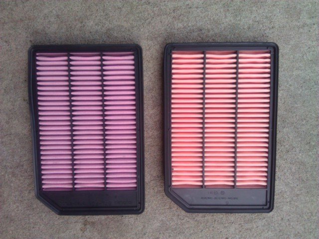

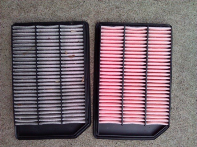

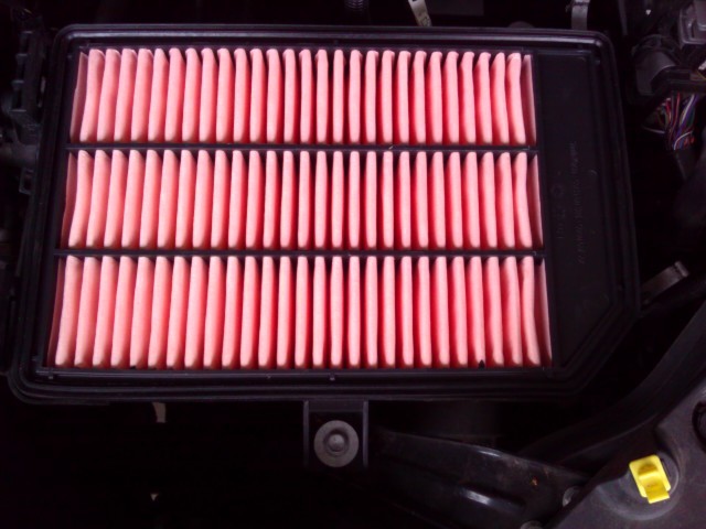

Compare your new filter to the old filter prior to install. You want to make sure you purchased the correct part. The new filter (Wix 49008) is on the right. It's orangish-pinkish in the photos. The old filter is on the left. The bottom of the old filter in these pics are white and has debris in it.
