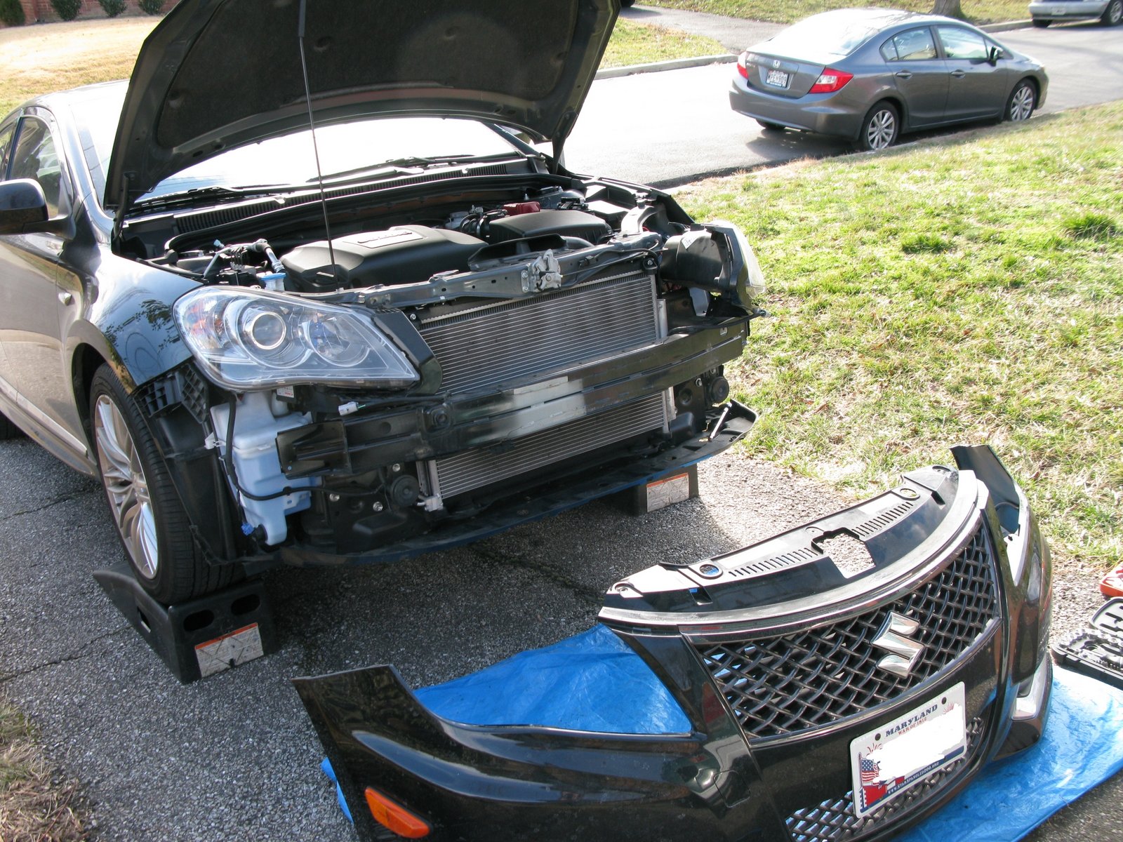

1) Remove the front bumper. It's true: to even replace the headlight bulbs, the bumper has to come off. This is the worst thing about the Kizashi it seems.
2) Remove the headlight. After taking off the bumper, remove the screws and the tab that hold the headlight to the car. Disconnect the single connector that connects the headlight wiring to the car. All bulbs are wired to the single connector instead of having a connector per bulb.

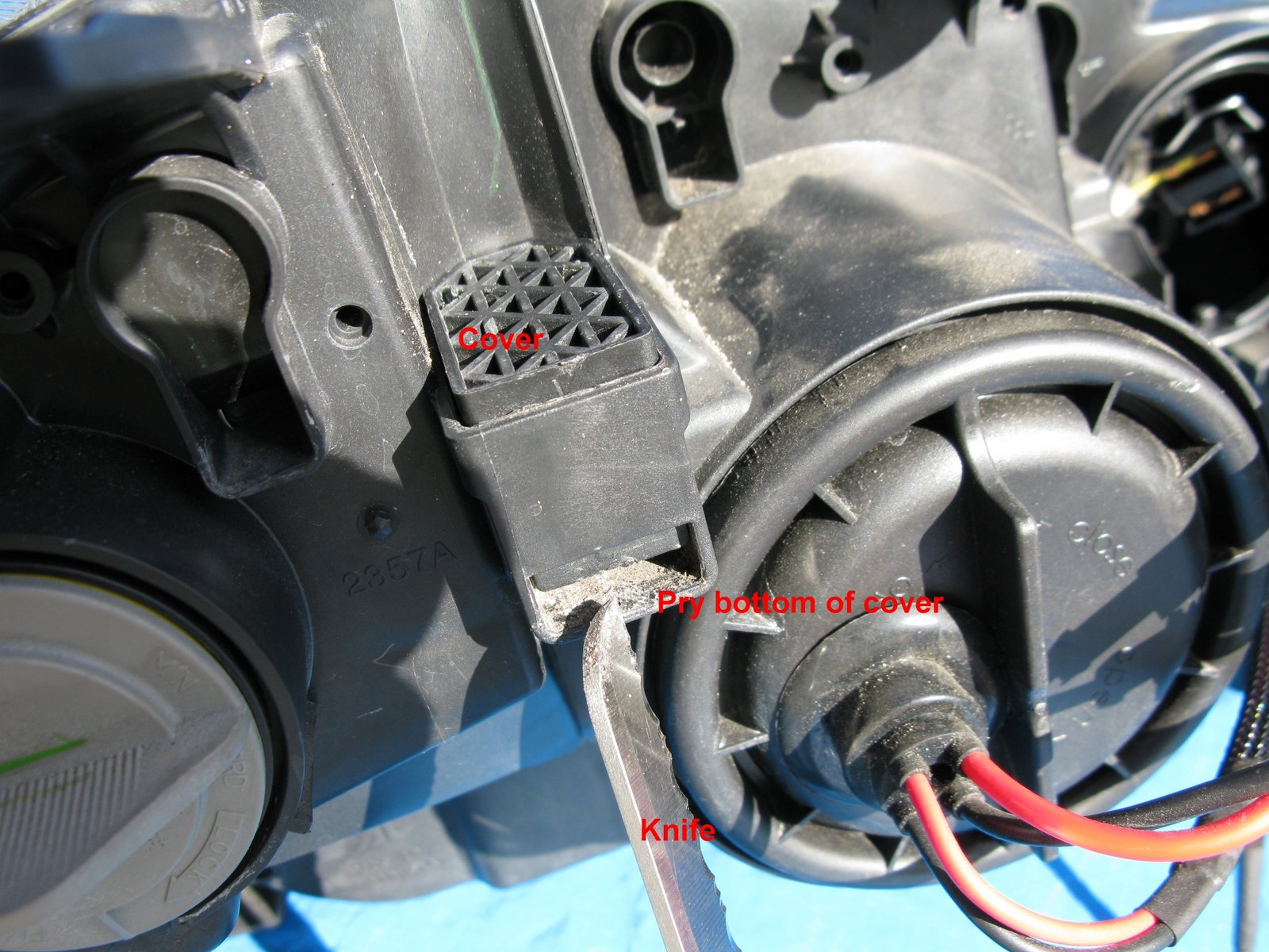

3) Once the headlight is removed, you will have the best access to the adjusting screw cover. It has many triangle patterns on it and is located between the low beam bulb and the turn signal bulb housing. Removing the headlight has this advantage: you have access to the back of the headlight and the screw cover.

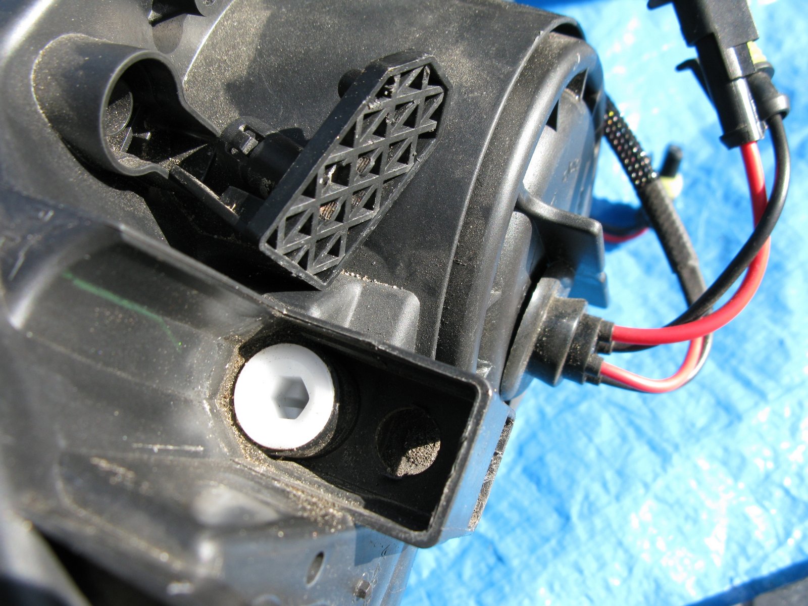

4) Here's the trick on removing it: Pry it from the bottom side via the back of the headlight. Trying to use pliers on the top triangles will not work and the plastic will just break. Use a thin knife and push the blade into the back which has part of the cover exposed at the bottom. Insert the knife and then twist to pry open. The cover will pop out rather easily. Remove the cover.

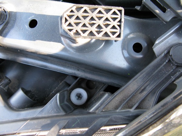

5) Under the cover, there is the adjusting screw, much like the Up <--> Down adjuster.

Remove the bumper and the headlights to have full access to the adjuster cover. Access to the rear of the headlights is key.
Remove the cover by prying at the bottom from the back where it is exposed. It pops off easily with no damage.
Removing the cover exposes the adjuster screw for access. The way it should have been from the start!
Headlights and bumper re-installed after<br />R&lt;--&gt; L adjuster screw cover removed. Adjuster screw fully accessible after headlight and bumper replaced.
R<--> L adjuster screw cover removed. Adjuster screw fully accessible after headlight and bumper replaced.
