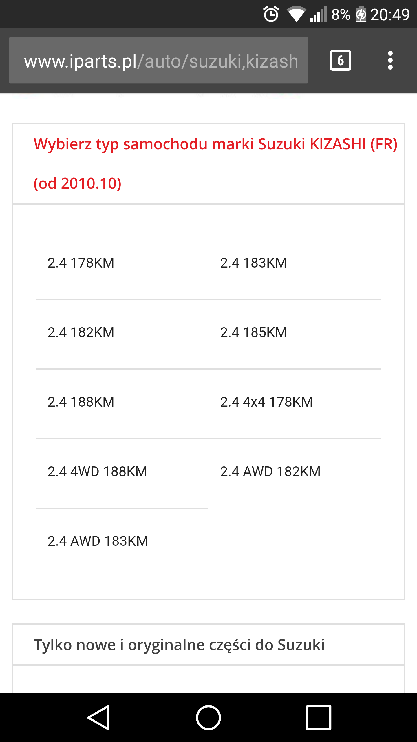

What are the differences between Kizashi 134 KW vs 138 KW ?

Why are you laughing? It's 10 HP... (178 HP vs 188 HP)
Where are the differences? Simple question...

The difference is with the model yearbook?
The newer has more HP? Are people in forum having kizashi from 2014?
When I buying a part the seller had several models to choose from ... so I ask here.
My Kizashi Sport is 178 HP MT from 2011.
If the car has the same engine where are the differences?
